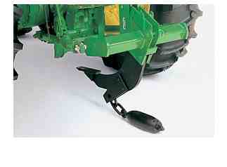

   / Chisel plow on sub-compact tractor. #16
The 22B is a good model imo, one things for sure it is more than a scut want's though.:D
