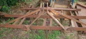

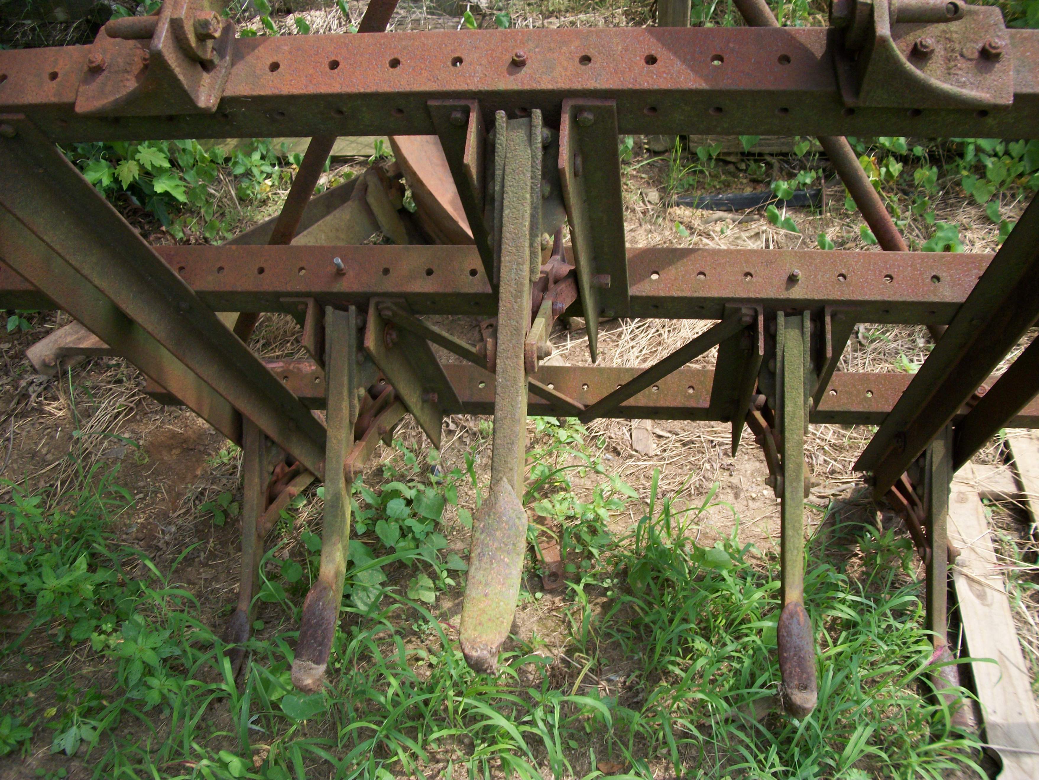

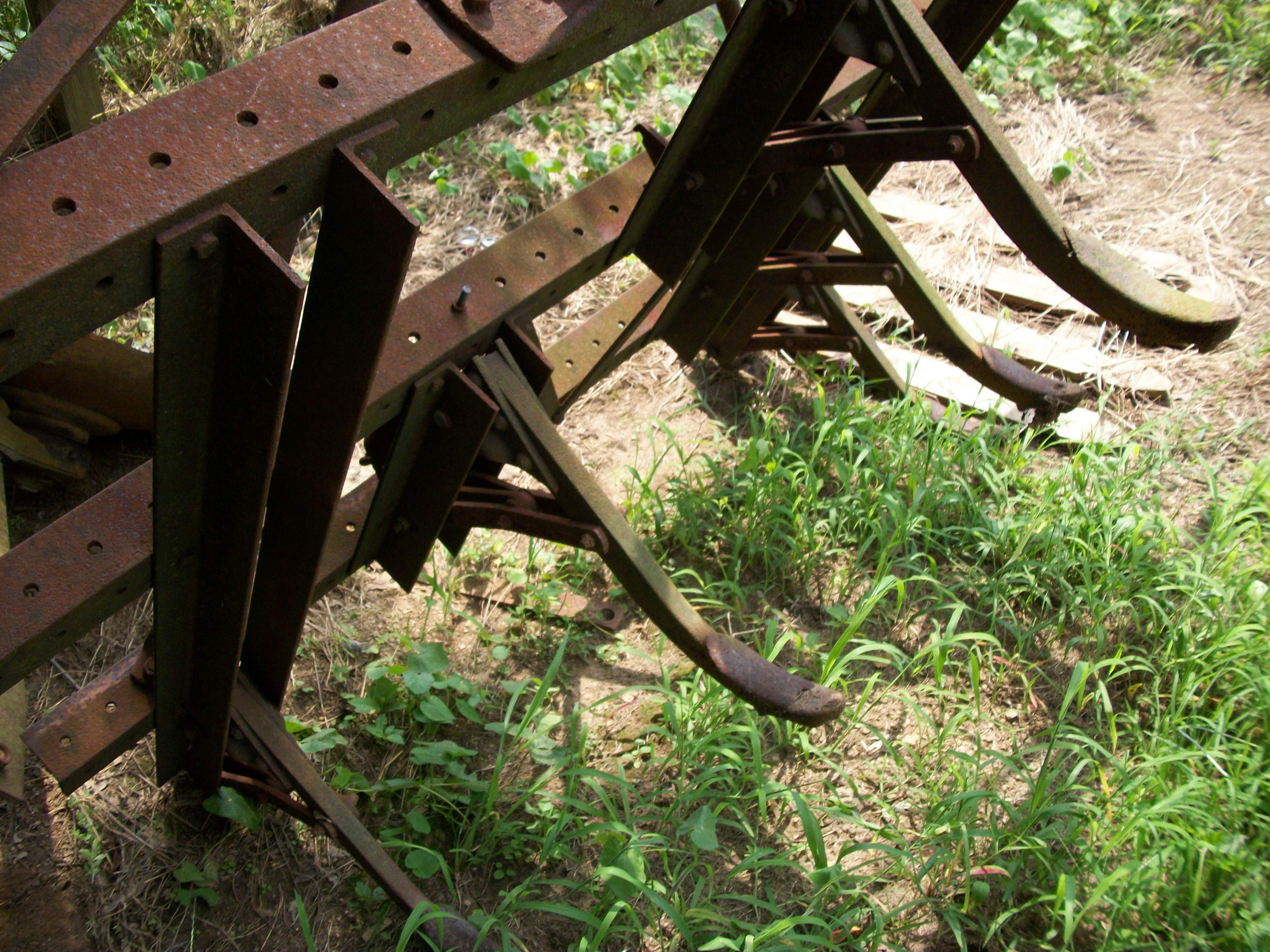

Im thinking about buying this plow. The guy says its a ford. It measures 5-6 feet or so in width and has 5 teeth. The middle tooth is missing its spring. What do yall think its worth or should i pay for it. He said its heavy and we wont pick it up to put it in the truck, he will use his loader. I asked you think it weighs 400lbs he said at least or around there.

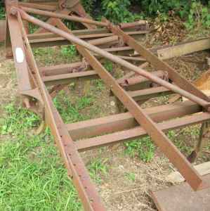

Here is 2 more

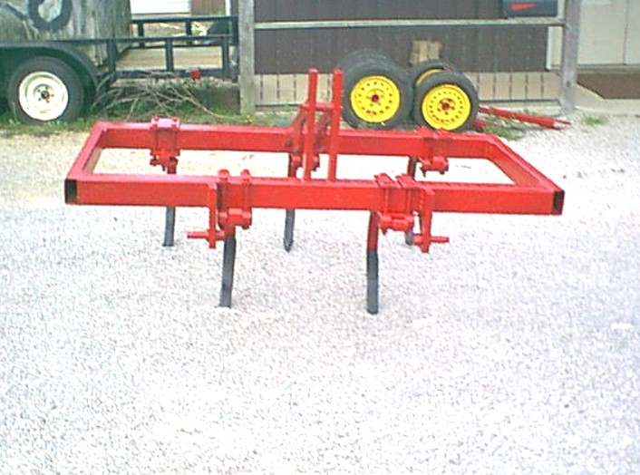

It is what is left of a Field Cultivator. Here is what a Chisel Plow looks like. Ken Sweet

You just listed three very different things. A spring tooth harrow and cultivator are basically the same thing. What you have shown I would call a cultivator. It's not a chisel plow, they do very different things.

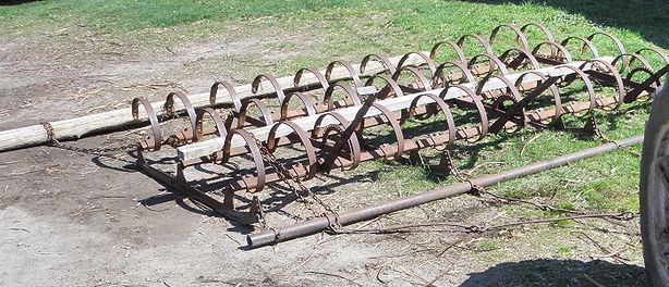

This is a pic of an original drag spring tooth. The teeth themselves were the spring and made of spring steel. When more land was acquired to farm it was found to be aggravating to move one more than just across the road. For a short period spring tooth trailers were built of pipe and usually right on the farm. To load it the tractor was driven across the trailer pulling the spring tooth up on it. That didn't last too long as folding sections were then factory built with wheels. With that advent the spring tooth became more of a cultivator.

If they are coil spring loaded and the anchor pins are wore, they will want to pop off in heavy penetration. If you can buy it for $50, you can't go wrong. You can always weld the shanks solid. Ken Sweet

Price is more like $150. $50 is about a scrap price for it. Heavy penetration is fine if it springs over but from the pics this thing looks pretty ridgid.

It is one of those 'in between' contraptions. down south it might be called a chisel plow, but up here in the north it is just a heavy field cultivator.
Broken spring, price them - if you can still get them? You might be surprised what it costs.
The sweeps - the replaceable shovels on it - all look to be worn out on the one side, and I only saw one that has a good side left. Those will run $10 or so per shank with new bolts to replace, & you do need to replace those worn out ones.
Looks like it sat a while in the grove. Obviously the owner didn't think it was work a lot....
I'd be closer to the $50 than the $150 in my offer. Seems it need a lot. I bought something like it for $300; but it had good almost new shovels, and all springs were good.
You'll be over $300 and a lot of time getting the old bolts off....
It'll rip up grass in sandy soil. It would be a several pass, long task to do so in heavy clay soil like I have. That's the big varriable -what your soils are like.

OK i checked. We all can see one point has another side, but i prolly will buy 5 to have an extra.
*Points 5/8 thick $3.49/piece x 5 = ~$17.50
*Bolts, i figure i can buy all i need at the store for $10 ( i have boght a few bolts at my local carquest so i have an idea of price)
*Spring (hard since i dont have it and not seeing the whole supply at TSC) but at agrisupply there is some for $9 and some for $30? unknown?
So even figuring $30 for a spring and $20 for new points and 10 for bolts thats $60. Glad were looking at it this way, thanks for pointing out the obvious which i saw but did not price yet.
