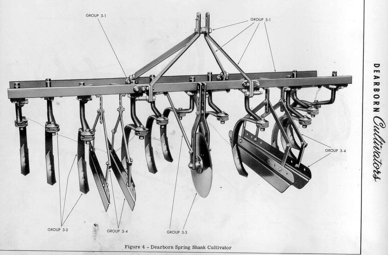

You aren't going to pull very much of a "chisel" plow with 40 hp. I'd go back to the spring tine and re-think things.They pull easier and with multiple trips do a great job. If you are getting rocks in the the face, slow down. You could easily pull one of those lightweight Dearborn/Ford/MF cultivators that were designed to be pulled by the 9N/8N Ford. Picture attached. Oh, remove the rolling coulter and crop shields in the unlikely event you find them.
I used one of these with an 8n as well as a 4wd 40 HP 2110 Ford and it did a wonderful job, especially with the chisel type point shown in the photo.I have had one on a 75 HP Deere. I dug big (75 lb ) rocks with them and have owned several. With repeated passes you can go six or more inches deep and the tines can be rearranged to suit your fancy. Note: there is a spring shank and a rigid shank and I'm speaking of the spring type. A so called chisel plow will be too heavy for you to pull and you'll wind up making multiple shallow passes with fewer tines than the Dearborn type cultivator.
I have used cultivators and chisel plows and rippers on all kinds of stuff for decades and, if I could pick only one for a 40 HP tractor with home and light agricultural use would go with the Dearborn. in fact, I don't own one at the moment and have my eyes peeled.
