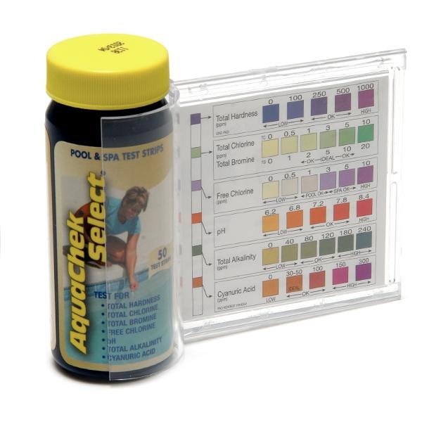

I'll second the test strips... they are super easy to use. I do it twice a week just because I'm curious.
I like these because they test everything but the salt level...
