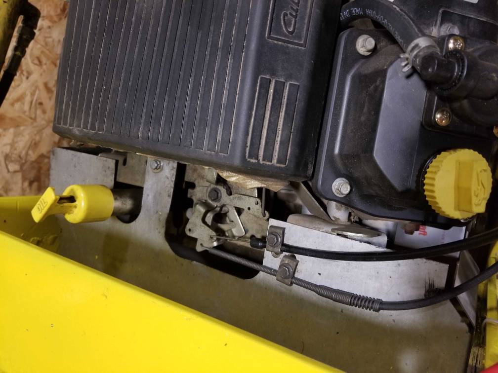

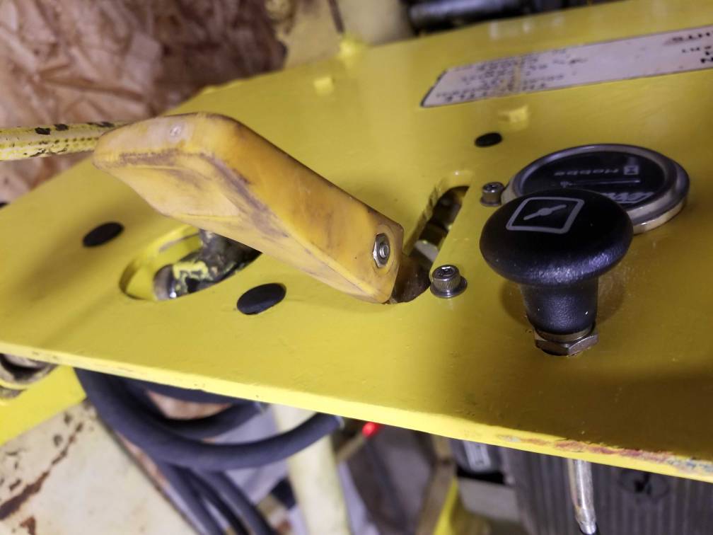

HEY, I'M LOOKING TO REPLACE MY CHOKE CABLE WITH ONE I CAN PULL OUT AND HAVE IT STAY PULLED ON.
I GUESS I COULD REMOVE THE ONE I HAVE AND GO TO NAPA WITH IT.
I WAS HOPING THAT THERE WAS A TRACTOR SITE YOU COULD BUY OEM PARTS.
ANY HELP IS GREATLY APPRECIATED.
THANKS, GREG
/ CHOKE REPLACEMENT CABLE 1996 T5C #2
Does it have a Kohler command engine?
I purchased a t5b with no engine last year and put a Kohler command in last year.
I ended up using
Scag Part# 482314 or 484106
I'm not sure if this is what you are looking for but it worked on an old t5b
Good luck friend,

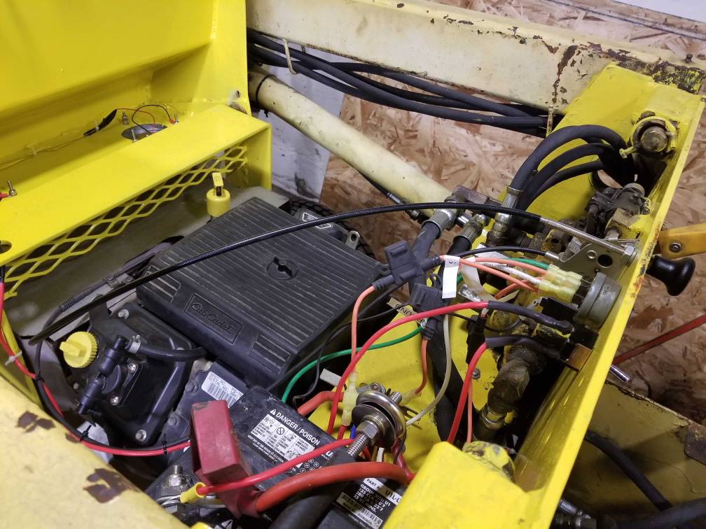

You need the choke to stay out?
In most cases once the motor starts you can push it back in. If needing to keep the choke out, might need to get into the carb
I would like to replace my throttle cable to something better, and I like the old style lawn mower lever
