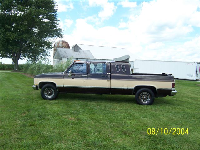

I pull a trailer quite often. It is a box trailer that measures 36 feet total length. It weighs in just over 8,000 pound when loaded. I tried pulling with my 1991 1/2 ton Chevy 4X4 when I first started. It didn't work very well. It was kinda woobly, and had load bearing hitch also. The first trip wasn't too bad on flat ground. Second trip was into Kentucky where the hills took its toll. Sitting on the side of the road waiting for the transmission to cool after it puked out fluid all over the exhaust was not fun. So I did some trading and bought a 1983 Chevy 3/4 ton 4 door long bed, single back wheel. What a difference that made. Night and day. Used that truck for a couple years. Attached a pic. Couple months ago I found a deal on a bigger truck. 1996 Chevy 3500 ext cab dually 4X4 with 454 and auto. Again, night and day difference. With this truck, driving is a dream. No sway, stops great ect.
Just my .02 cents.
P.S. Trailer in background.
