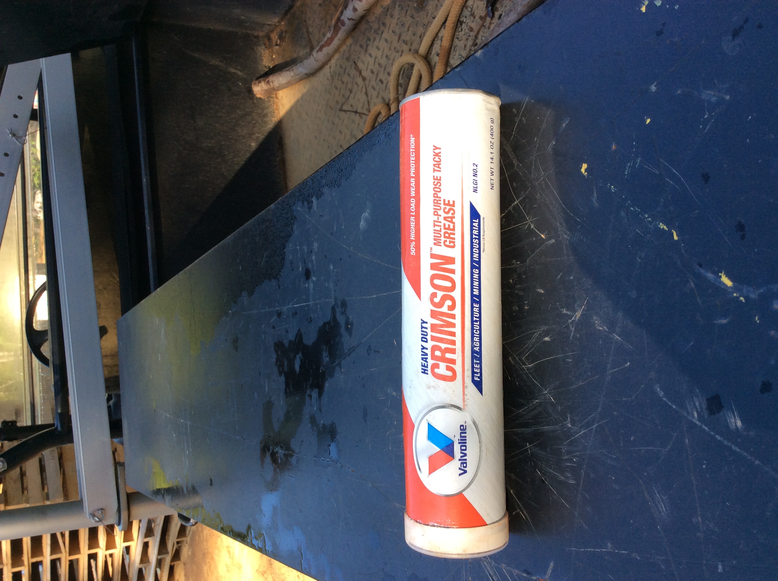

202629D9-2CD9-4202-A2ED-9941A67F61B6.jpegThe grader that did all my work has a good sized co with 15 employees And lots of big equipment. One of his guys greases about 1/2 his time, greases stuff every day!
He told me, get the red grease.

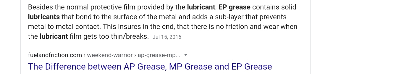

Noticed that some of the greases recommended are not EP rated.
