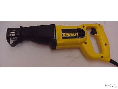

If all your cutting is rebar then make a little investment of a RECIP SAW. Metal cutting blades are good for rebar and it's pretty quick.
But for the really good metal cutting I use dewalt 872
gary
