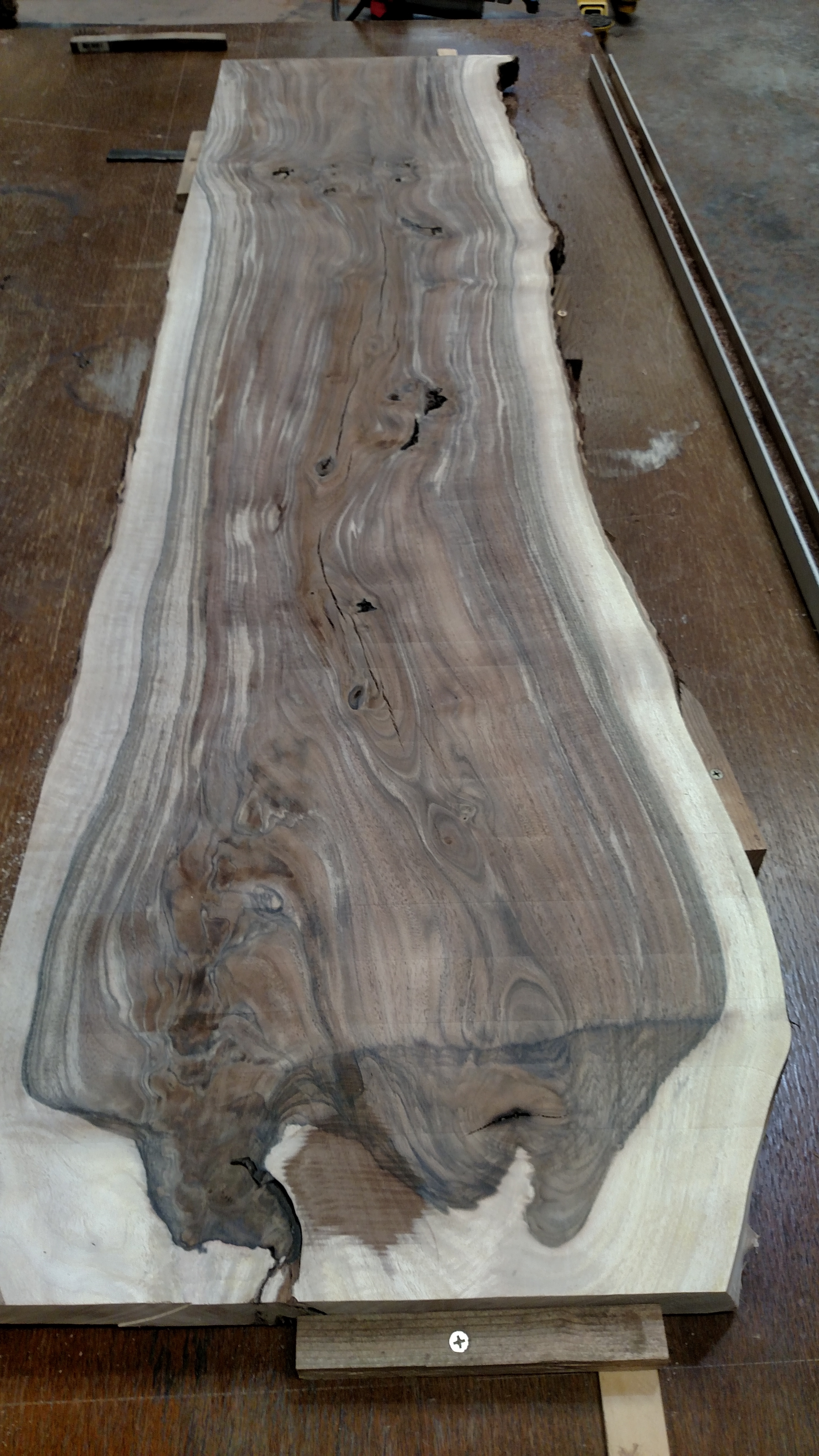

Hmm I know Black Walnut poisons the soil with Juglone to affect other plants, but I never thought about the sawdust for human exposure! Thanks for another great tip - I definitely plan to saw Black Walnut, I have a whole grove of them on my property. I had 30 walnuts logged for veneer-grade wood back in 2014 as a select-cut. Now the trees they didn't fell, and left behind are getting huge.
Think about 1/4 sawing for gunstocks. They take a long time to dry correctly but it's worth the time.
I'm in the process of making a cross for a buddies grave. The trees have been down for several years. After I cut the 4"thick 32x18 slab from the center it was at 32% still. It took another 6-8 months to get it to naturally dry to 15% to cut to rough shape and another 4-5 months to get it to -10% for final cut and shape. It twisted less than 1/8" overall. I'm in the process of final sanding for finishing. It's definitely a labor of love.
