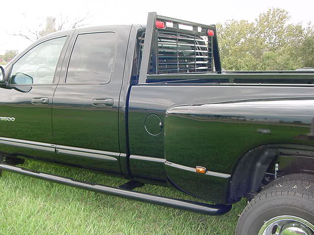

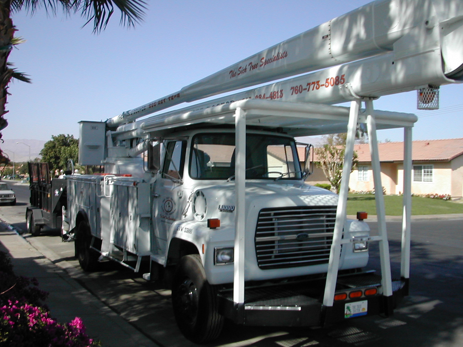

Ive just loaded the tractor for work tomorrow . As you can see , there is no room left over . I have fitted a towbar so if i need extra implements with me , i can just bring the trailer .
might I recommend a rack over the cab so that if something happens to the loader you wont have it coming through the roof? either one like in this picture or if nothing else a big (3" / 8cm +) upside down U shaped piece of steel channel or box tubing taller than the cab mounted right behind the cab (sort of like the outer frame of this headache rack). it would be a shame for all your hard work to be wasted because the loader control valve got bumped and dropped the bucket (or grapple) onto the cab roof.
Aaron Z
Yes , i did think about doing that but have found the shortened safety lift ram prop works well to stop the arms from creeping down (you can just see it on the bottom of the left ram , i will make another for the right ram) and you maybe able to see the Yellow chain i have holding the grapple from creeping forward .
now that know where to look, I can see them, however if it were mine I would put them on anyways for peace of mind.
But that's just me, I like to be overprepared.
