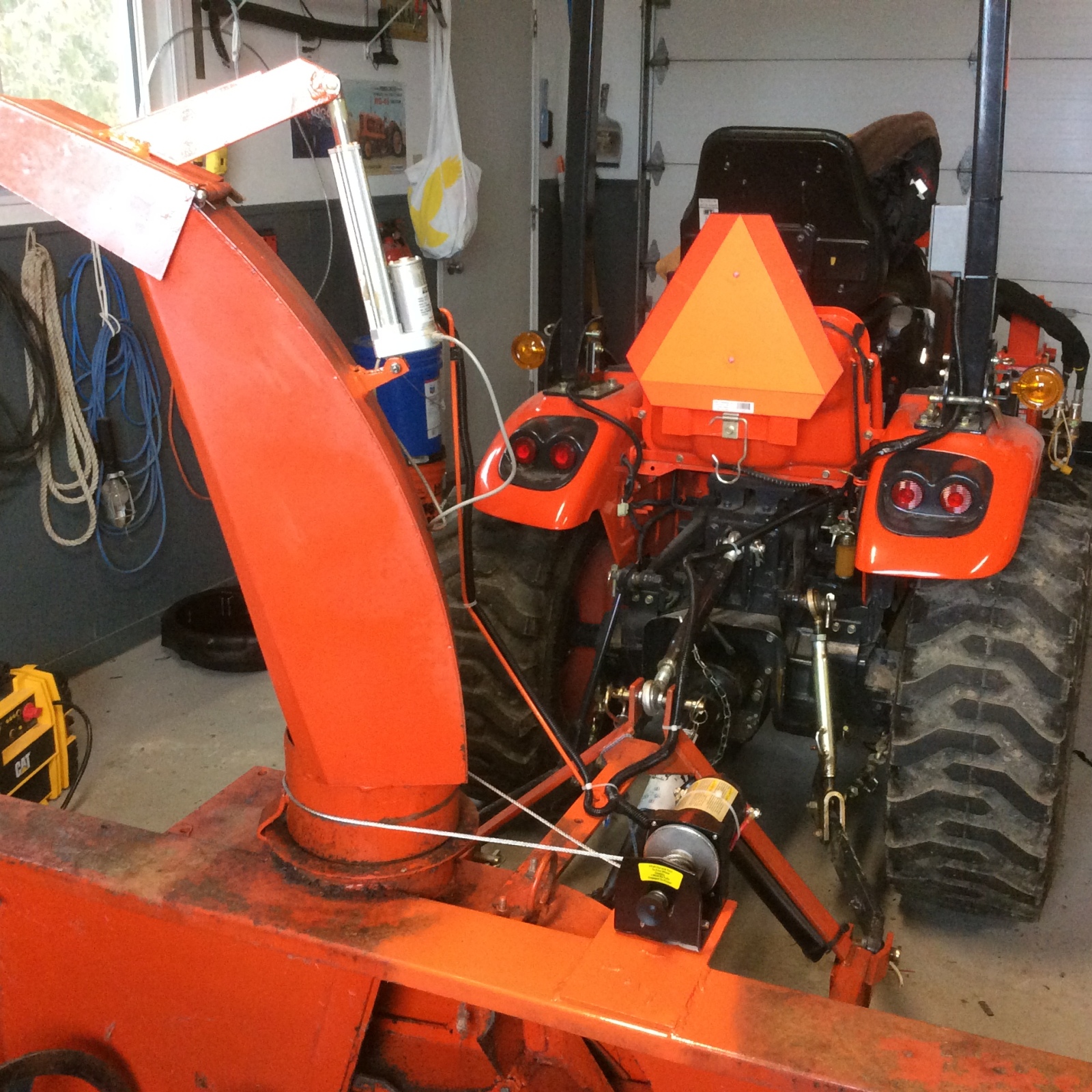

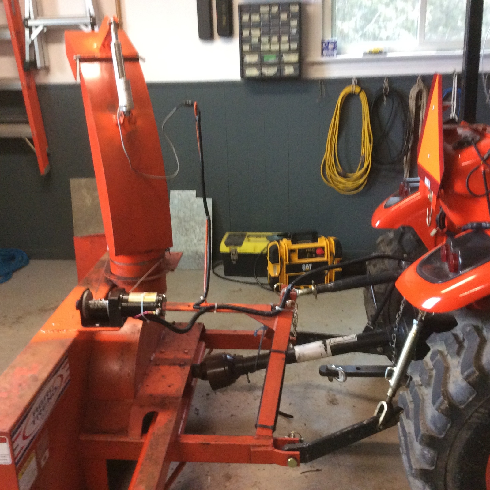

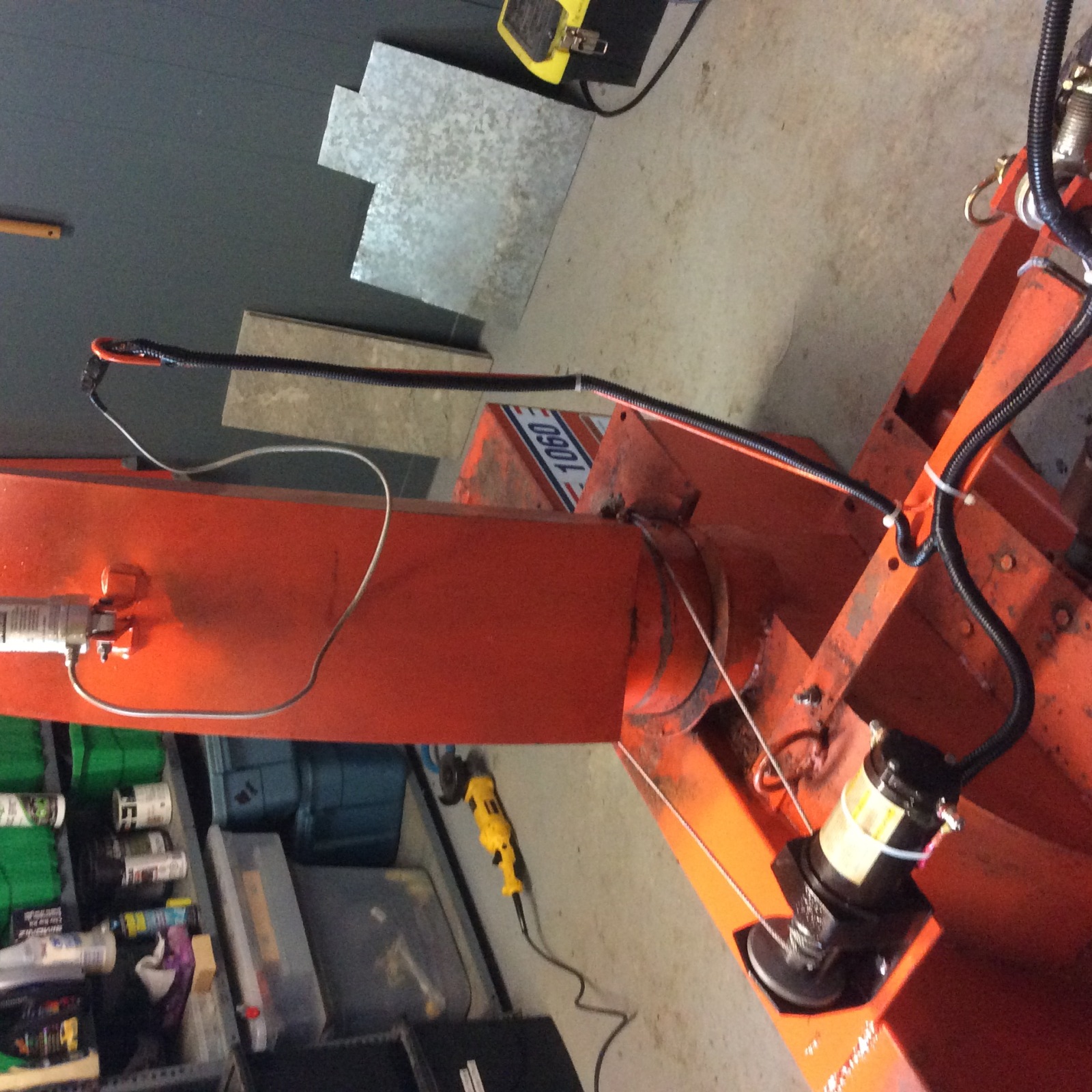

I had the kids all home for Christmas so the 3 boys - me, my son and my son-in-law - decided to celebrate the season properly by doing a little fabrication and drinking some beer in the garage.
Nothing ground-breaking here, but it has tested out OK, and I'm happy with it. Now I'm looking forward to some snow so I can try it in anger. :laughing:

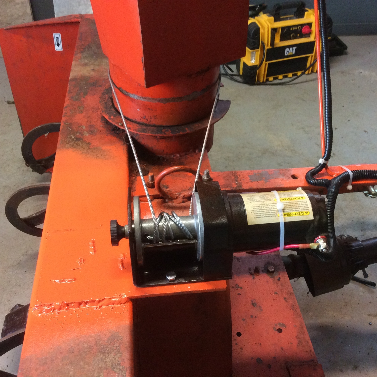

Do you have the cable wrapped around the chute? The pictures look like it's not fully wrapped. I gave mine an extra wrap to make sure I wouldn't bind it up.

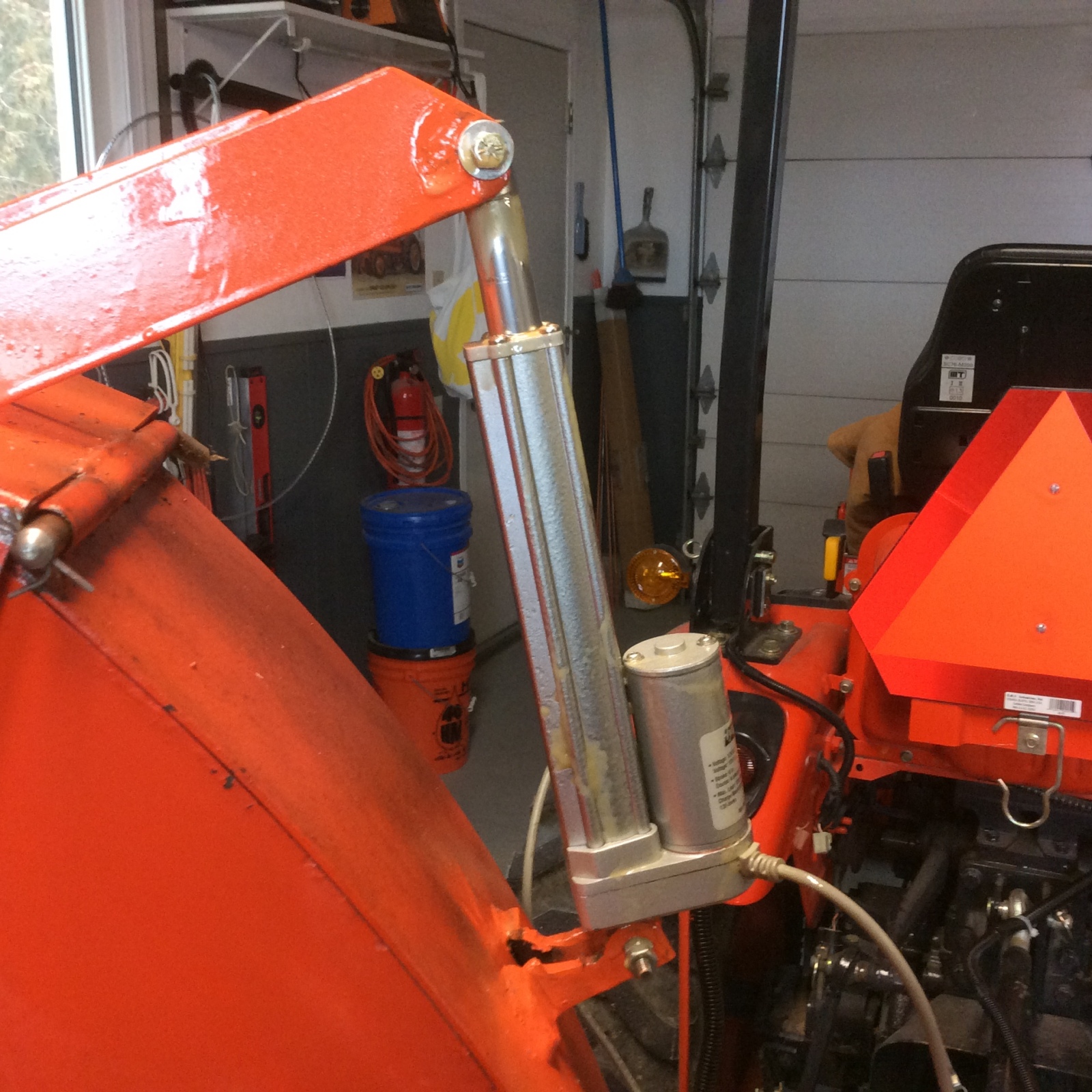

What did you use for the deflector actuator? I haven't added that yet but yours looks pretty high tech.

If that winch is the Harbor Freight one (looks a lot like it) the little relay box that comes with it is not waterproof. Mine froze solid last winter!! I replaced it with an ATV winch control from Amazon.
   / Christmas Project - snowblower chute automation #4
On my similar set up I made a motor cover from a short length of 4" sewer drain pipe.
Where the cute rotates and makes contact with the blower body I made up a wide 'washer' using plastic sheet stock.
The chute rotates more easily when sliding on plastic vs metal on metal. Grease also helps.

What is the load on the defletor? I have a spare $60 actuator rated to 200lbs or so I was thinking about deploying like that. Have the winch for lifting the jeep plow too. Its obselete as the plow is now SSQA & curl does the lifting. Might try the same setup you have.

The cable isn't fully wrapped around the chute. It terminates behind the chute, secured to two large nuts I welded there.
The deflector is driven by a linear actuator. $74 at Princess Auto.
The winch is an ATV unit, from Princess Auto. It included at circuit breaker but no relay. I added a relay up near the battery. It's weatherproof but also pretty well protected there.
My LA is rated for 135lb dynamic and 200lb static load. I hope it is strong enough.

Good suggestions. My winch is rated for immersion so it should withstand the weather. I have enough gap in the chute cylinder for some thin plastic; I'll keep that in mind.
