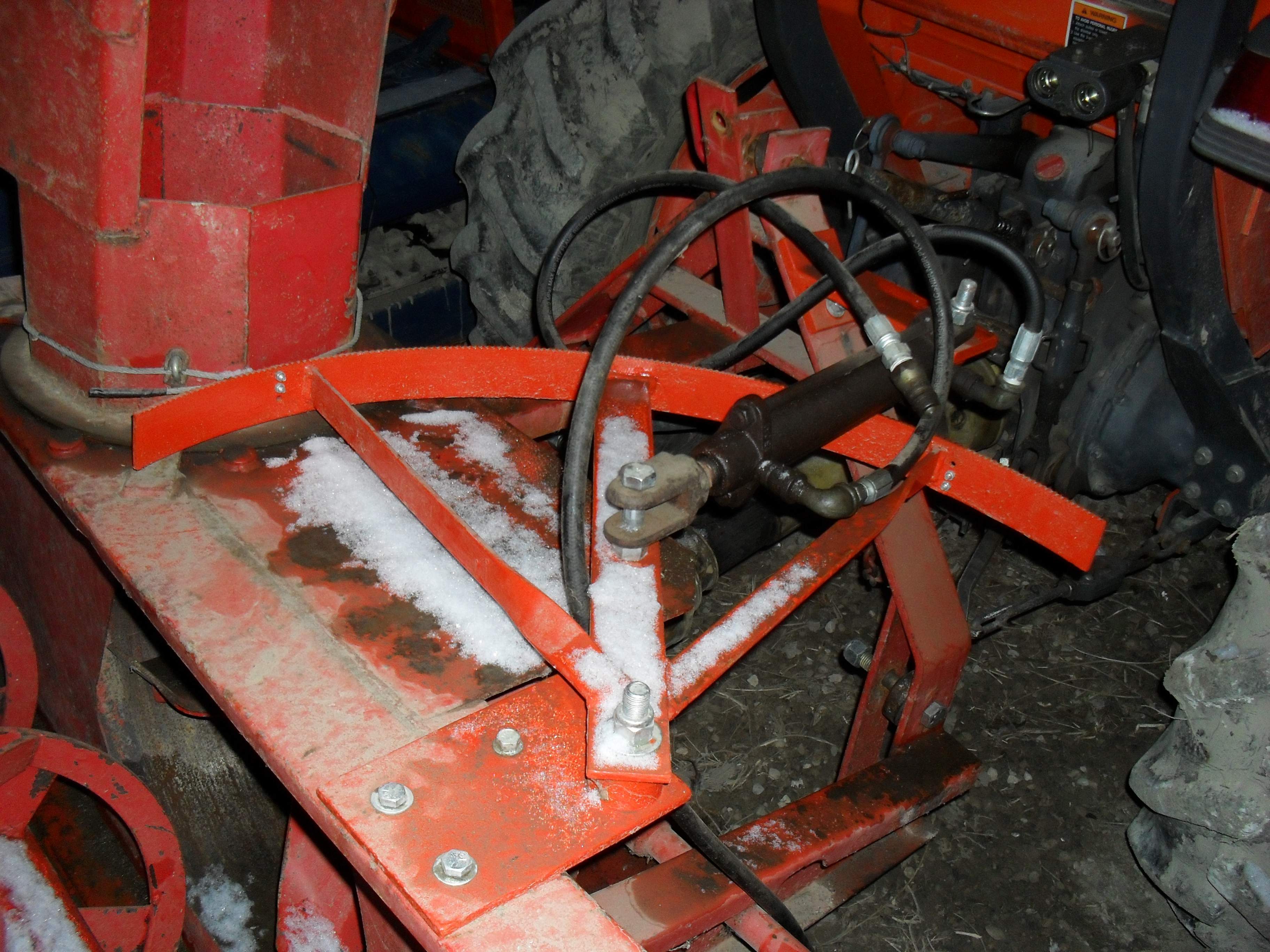

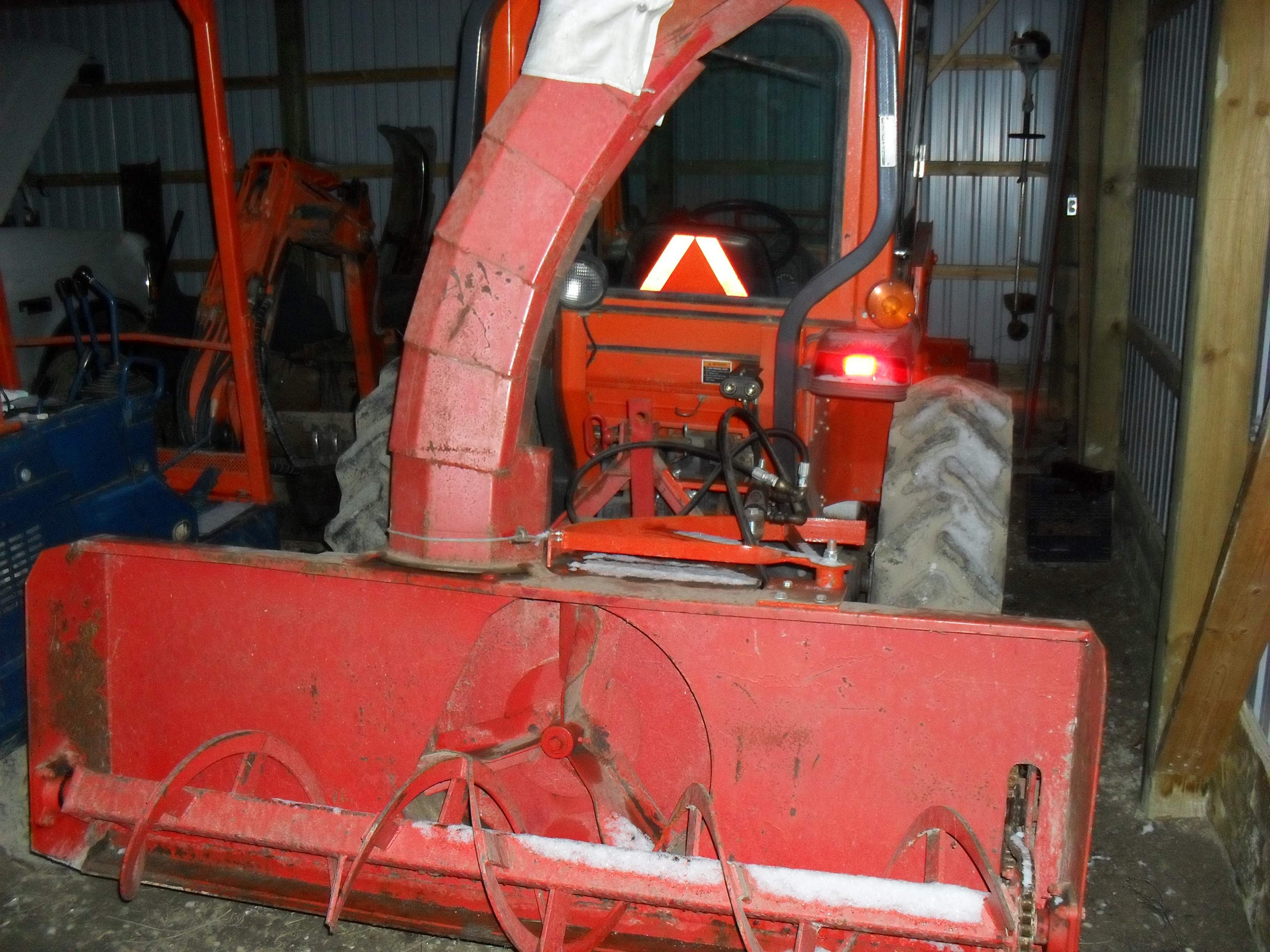

I have put a hydraulic cilinder on my snowblower to turn the chute. Seems to work fine, but if I am not very carefull with the hydraulic handle, the chute turns in less than a second. I would like to slow it down to 3 or 4 seconds.
pump capacity tractor is 7 gals/min, system pressure 2490 psi
the lenght of the cilinder is 12"
the diameter of the rod is 3/4"
If I put a restrictor in the line, how small of a hole do I need ? Does any one have some experience with this?

Can you install a needle valve in the cap end of the cylinder. This would allow you to fine tune the speed. If you get one that restricts in both directions you would only need the one valve.
/ cilinder to fast #3
Probably the best way is to use a needle valve instead of a fixed restrictor - check out surplus hydraulics, they're about $10-20. That way you can dial in the EXACT speed you want.
If the fittings in your pic are regular pipe fittings though, you will probably want to get some high pressure replacements - the restrictor will likely raise pressures to the point that you won't get away with plumbing fittings any more... Steve

30 thousandths. You really should have hydraulic fittings. I believe those plumbing fittings are only tested to 300psi. Not a safe thing to be using when you are putting 2000+ psi through them. :eek:
/ cilinder to fast #6
x2
You really need to get hydraulic fittings. Water pipe fittings should NEVER be used in a high pressure hydraulic circuit.
Something like this https://www.surpluscenter.com/item.asp?item=9-7961-4&catname=hydraulic is really what you need.
As well as a handfull of these https://www.surpluscenter.com/sort.asp?catname=hydraulic&keyword=HFNN that are the right size.

Moving the cylinder mount to the outer edge of the arc will drop your speed in half also.

any fittings in the system should be rated above the system relief.
IE.. use grey iron fititngs at your own risk.
personally.. a restrictor orifice is cheap and easy.. and if it restricts too much.. drill it out trial and error. :) but then I'm cheap. :) and sometimes easy.. :)

What it refers to is flow control and direction.
if you only install one flow control valve you
will have wide open speed flow in the opposite
direction.
It it better to install two needle valves on the two swing cylinder port fittings.

That depends on the device. Most needle valves, or orifice valves will control speed in BOTH directions by using only ONE of them.
If you install it on the extend side circuit, it will restrict incomming fluid and make it slower when extending the cylinder, and it will restrict outgoing fluid when retracting and make it slower.
Same can be said if it is installed on the retract side of the cylinder.

What LD1 said -
But if you WANTED to make the two directions different speed, you could plumb a check valve in parallel with the needle valve/restrictor, or TWO needle valves - one in series with the check, one by itself in the parallel leg. The check valve would force flow thru the other leg of the parallel path in one direction only.
Then you could independently slow one direction more than the other.

They make these with the check valve built-in........called a "Flow control"......a cleaner install

Whatever happened to just feathering the hydraulic lever to reduce the flow. One doesnt need to just hit the lever to the stop when applying the hydraulics. Just like operating a crane, finesse the controls rather than manhandle them and do the same thing that installing an inline orifice would do.
