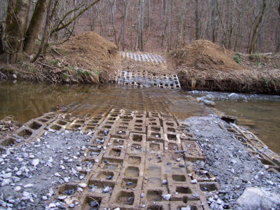

Has anyone ever tried making.a low volume culvert out of cinder locks laid side by side with the holes parallel to the ground and then covered by landscape fabric covered by a foot and a half of dirt?

Have not tried it but sounds like a lot of week links to me. Blocks are not a strong that direction.
   / Cinder block culvert #3
Unless alignment stays perfect, you will get a debris-trapping ledge every 8 inches. And even a handfull of leaves could plug a hole. OK for a walking path, but not a drive-on culvert system.
Try them this way. :)

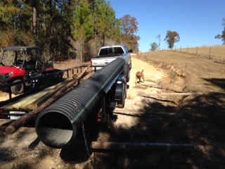

I used rock loosely placed and covered that with landscape fabric for a drainage ditch. It tended to ice up and stop the flow in the winter. I finally put in a 20" corrugated pvc culvert. Much better, always open.
Bruce
That looks like a very expensive crossing. At about $2 each block to get a 10 foot wide road surface would cost more than $20 per foot of road. A large culvert would be much cheaper to install.

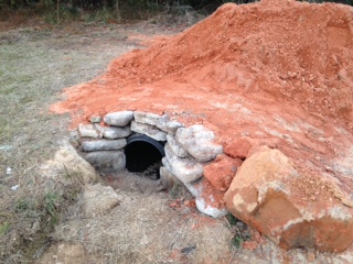

****! Wish I'd thought of that for my little drive-over bridge I built back in 2004. Instead I just slapped about a half dozen 3 or 3 1/2" PVC pipes underneath. These work but occasionally need some blowing (with an air line off a little tank I have) to clear of spring silt that dumps into their openings. Same would happen with the concrete blocks, but they would give me a lot more throughways for the water to flow through.
The blocks might be a bit weak for side force, but 3 or 4 inches of dirt on top them would likely distribute the force evenly enough to not have a sideway breakthrough.
