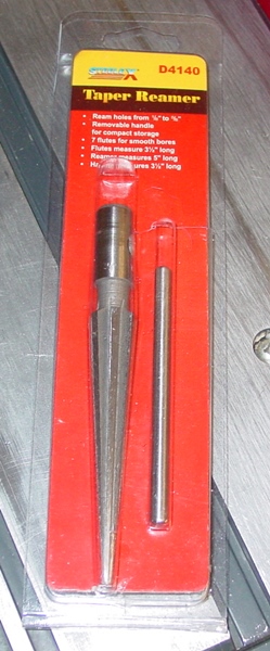

I’d drill out the hole before attempting to grind the arbor. BTW 40 teeth on that diameter blade is still too many for that thickness material.
