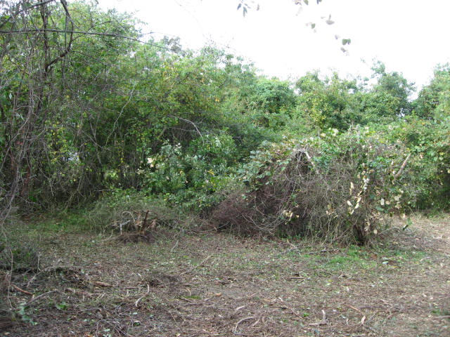

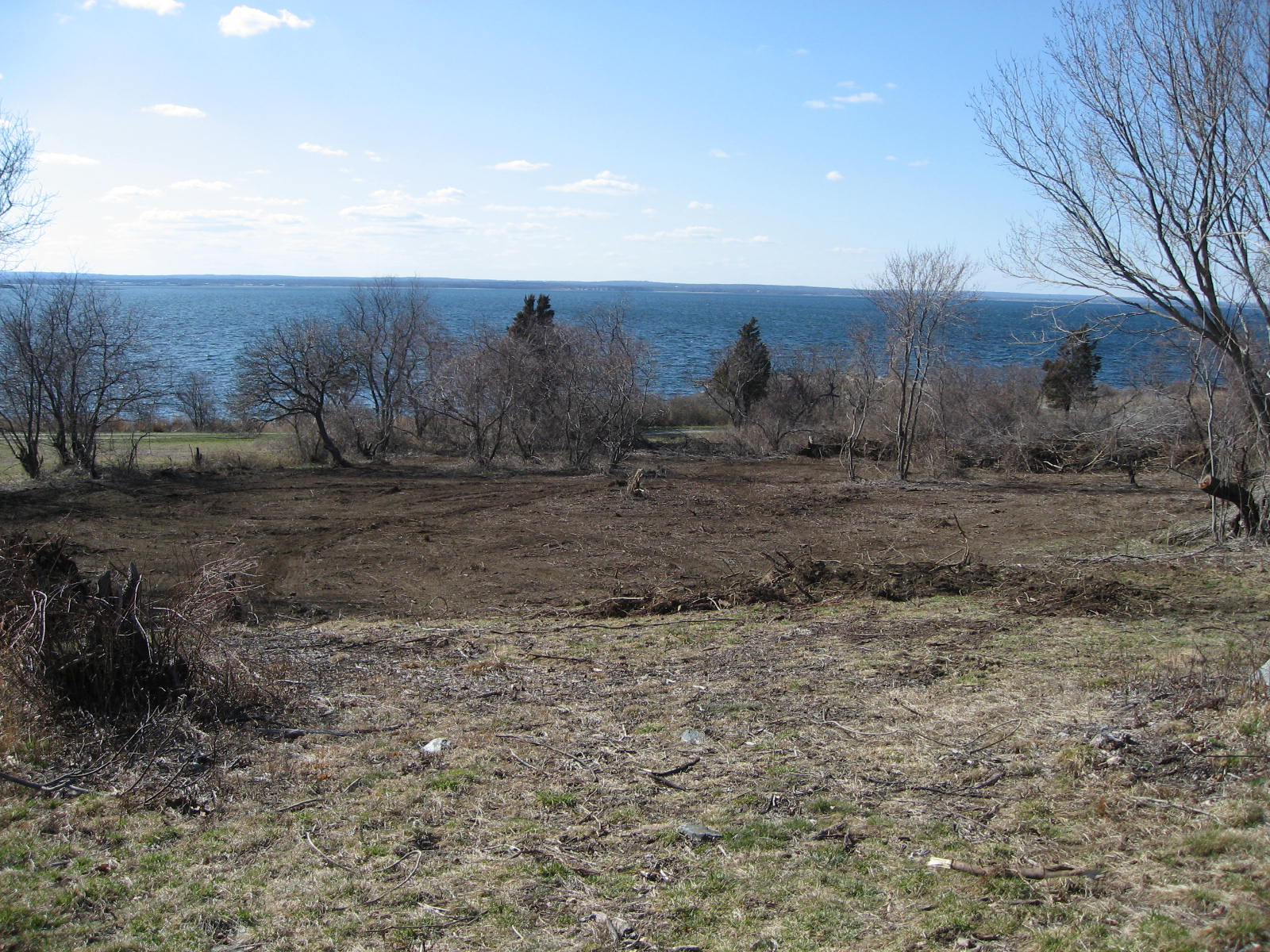

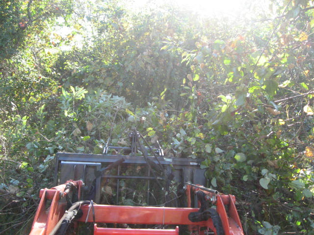

I cleared about five acres of land that had lots of small trees and tons of thick brush. I started with a Craftsman rider (duh), quickly moved to a DR mower (fine but slow and lots more work) then to a CK20 with 48" Bush Hog Squealer. That last setup was very efficient and handled all the brush. I did take out trees with either chain saw or grapple though.
I'd also suggest opting for a slip clutch on the bush hog. You can get an aftermarket one from AgriSupply for about $75. Much more convenient than trying to change out shear bolts in the field.
Photos show one area I cleaned up with the CK20/bush hog/grapple/bh. Last photo is what it looked like after all bush hogging and most stumps were removed.

Thats what my drive way looks like on the side!!! Awsome thats what I wanted to know. I was going to by a DR but I need to move dirt around, Stone for a parking area, mulch and other landscaping. So... why spend all the money on a DR and have to rent a tractor all the time when I can have one myself and get the work done at my pace.
