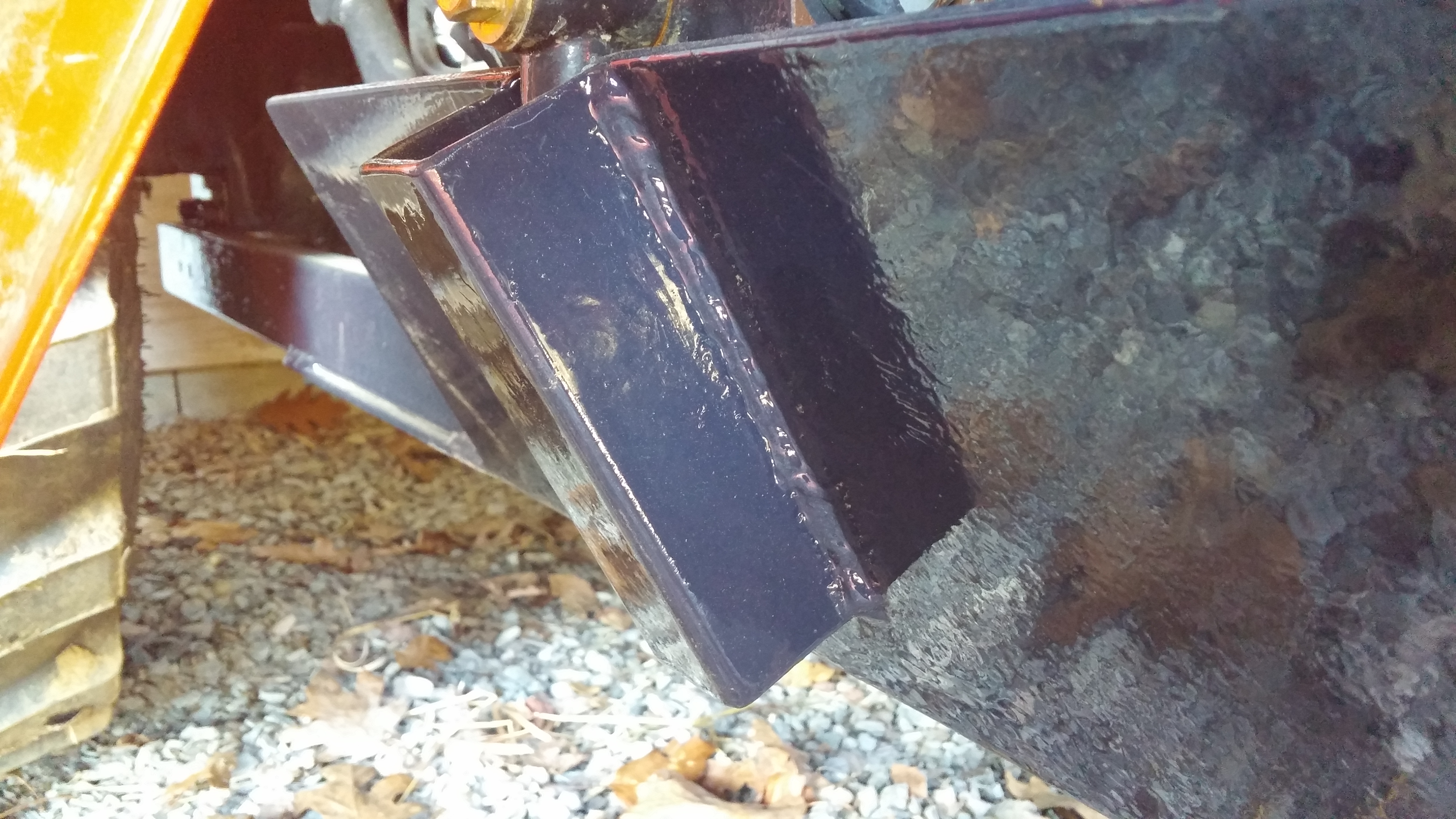

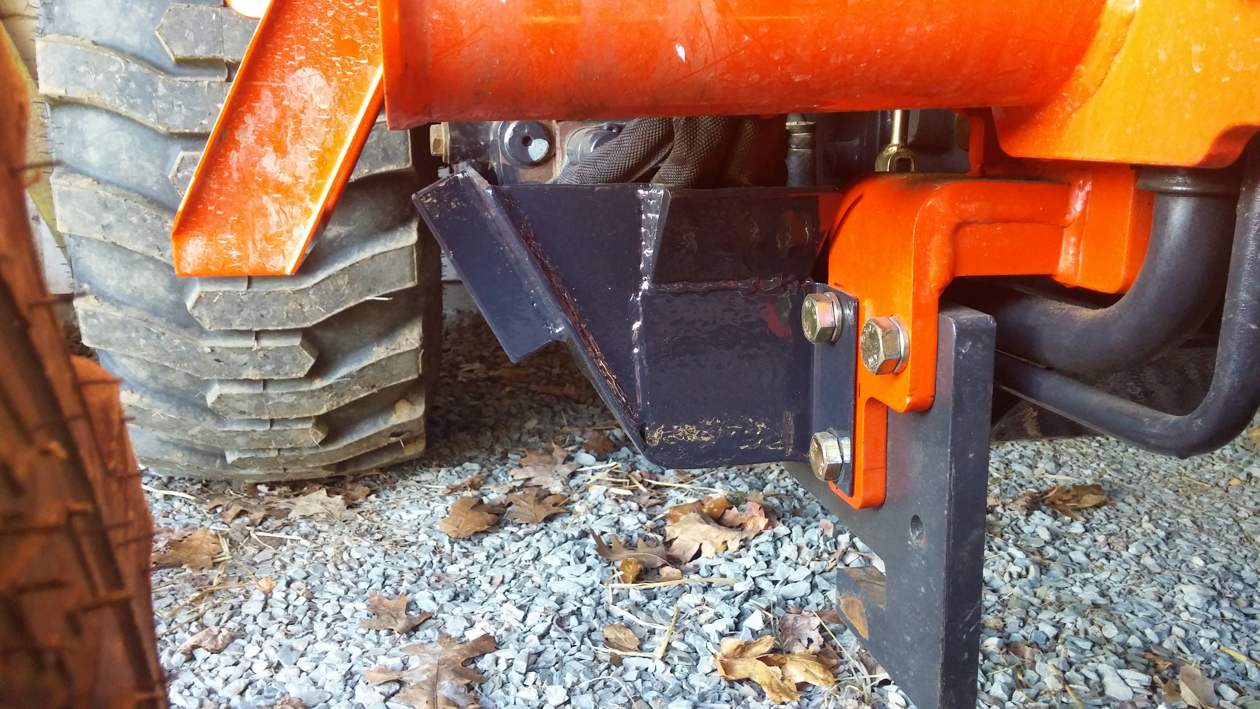

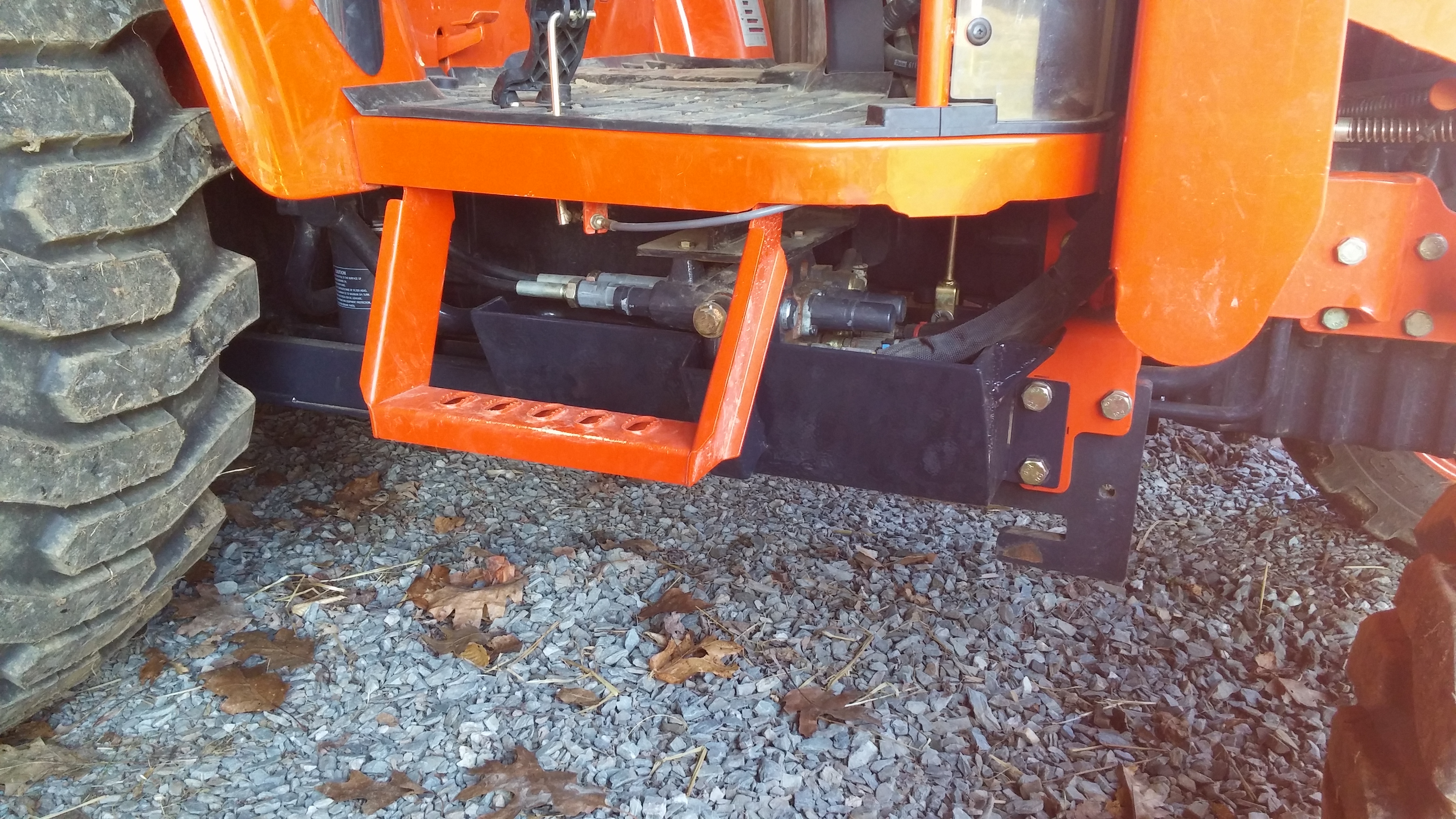

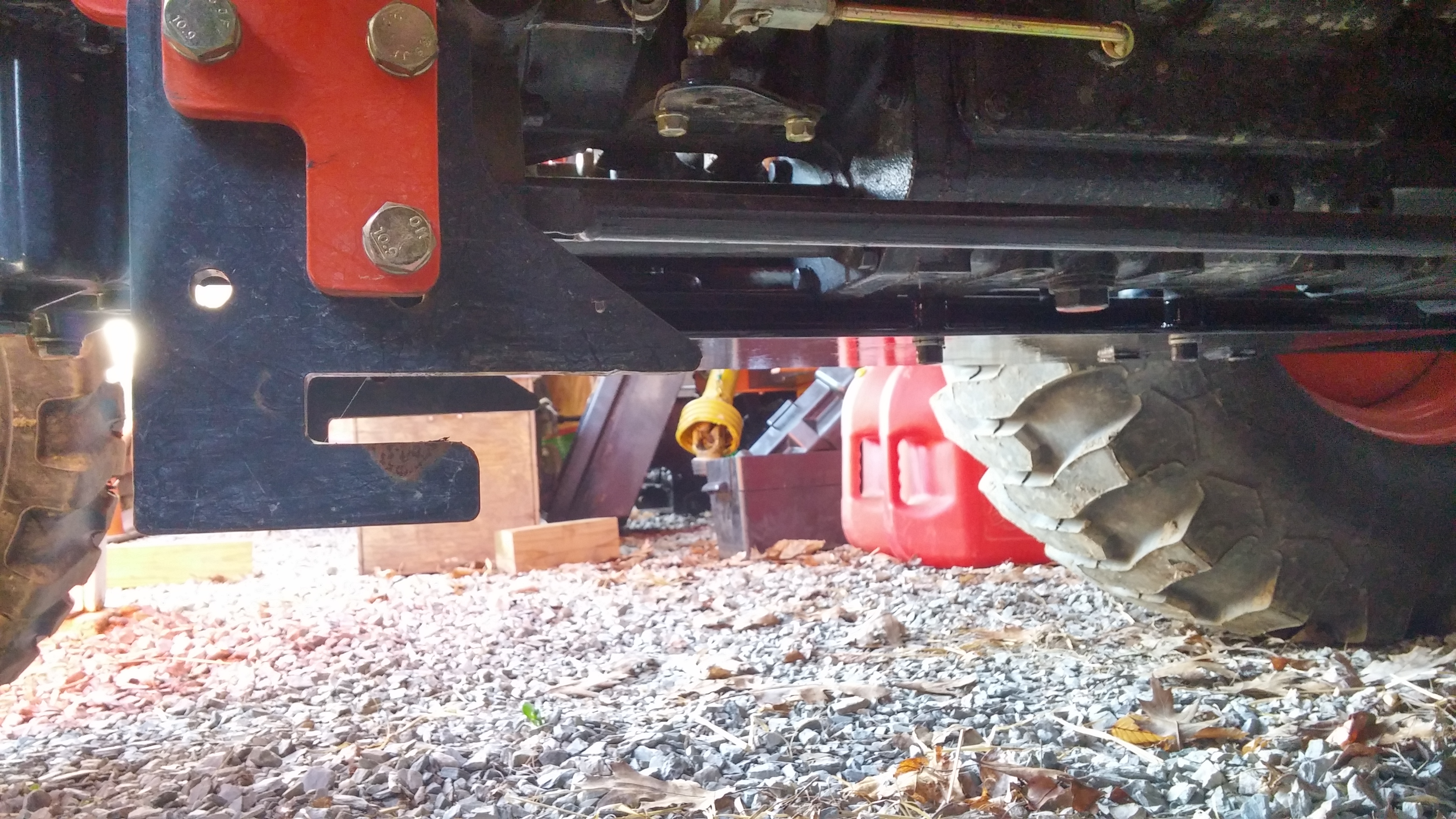

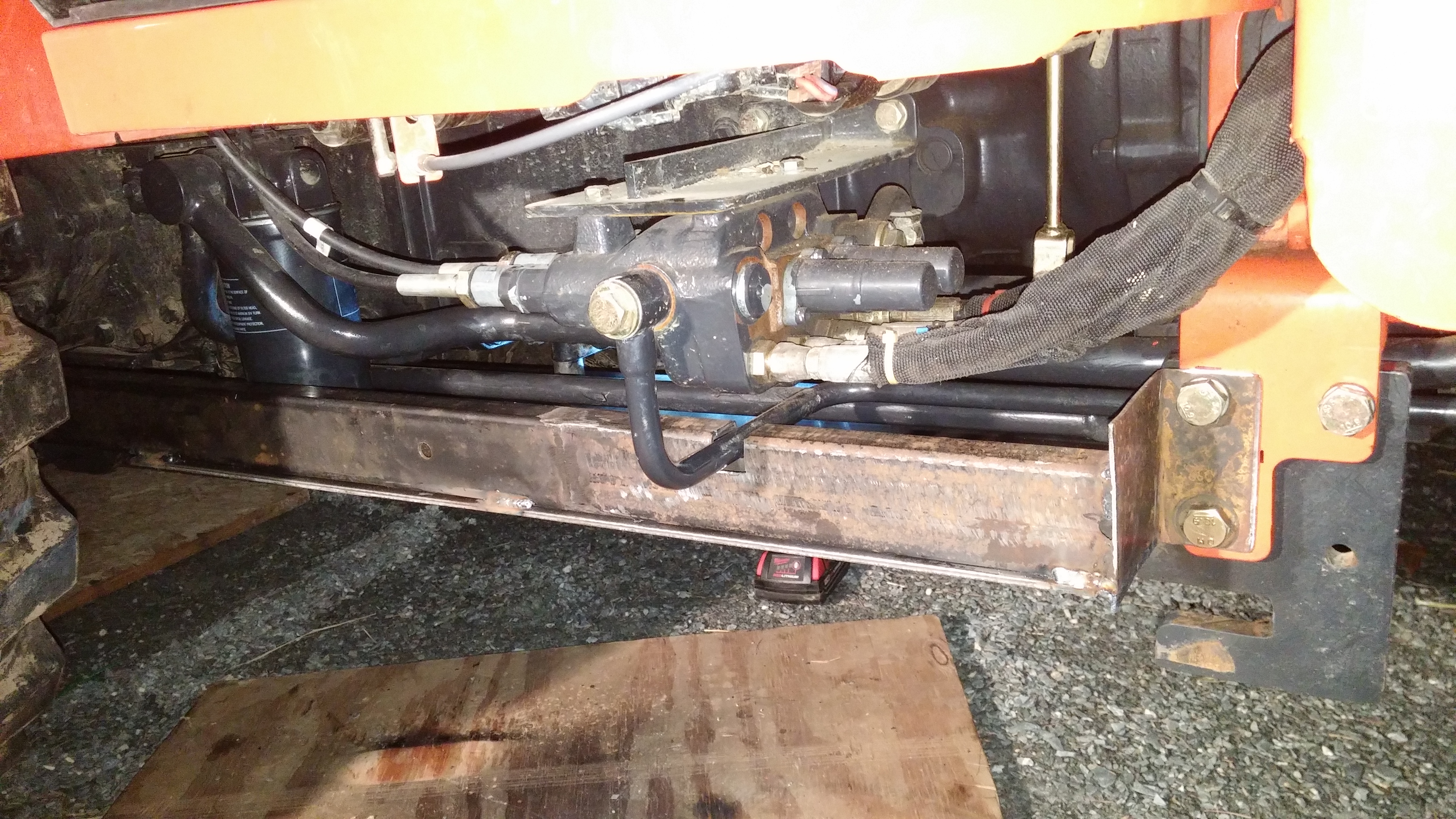

Finally got the finished product all painted up and installed. Found a color that matched pretty well it was RAL 7021 Black Gray. I used a epoxy paint so hopefully it will hold up well. I was able to bolt into 3 different locations one just below the rops bolts on the rear, 2 bolts into the transmission and into the backhoe brackets. Should be able to lift the tractor with it now!

Nice job, jabelding! Looks really good :thumbsup:
   / CK 35 hydraulic filter protection #14
Awesome Work !! Very Beefy for sure.
Think I just found my next project (like I have free time for more projects LOL)
