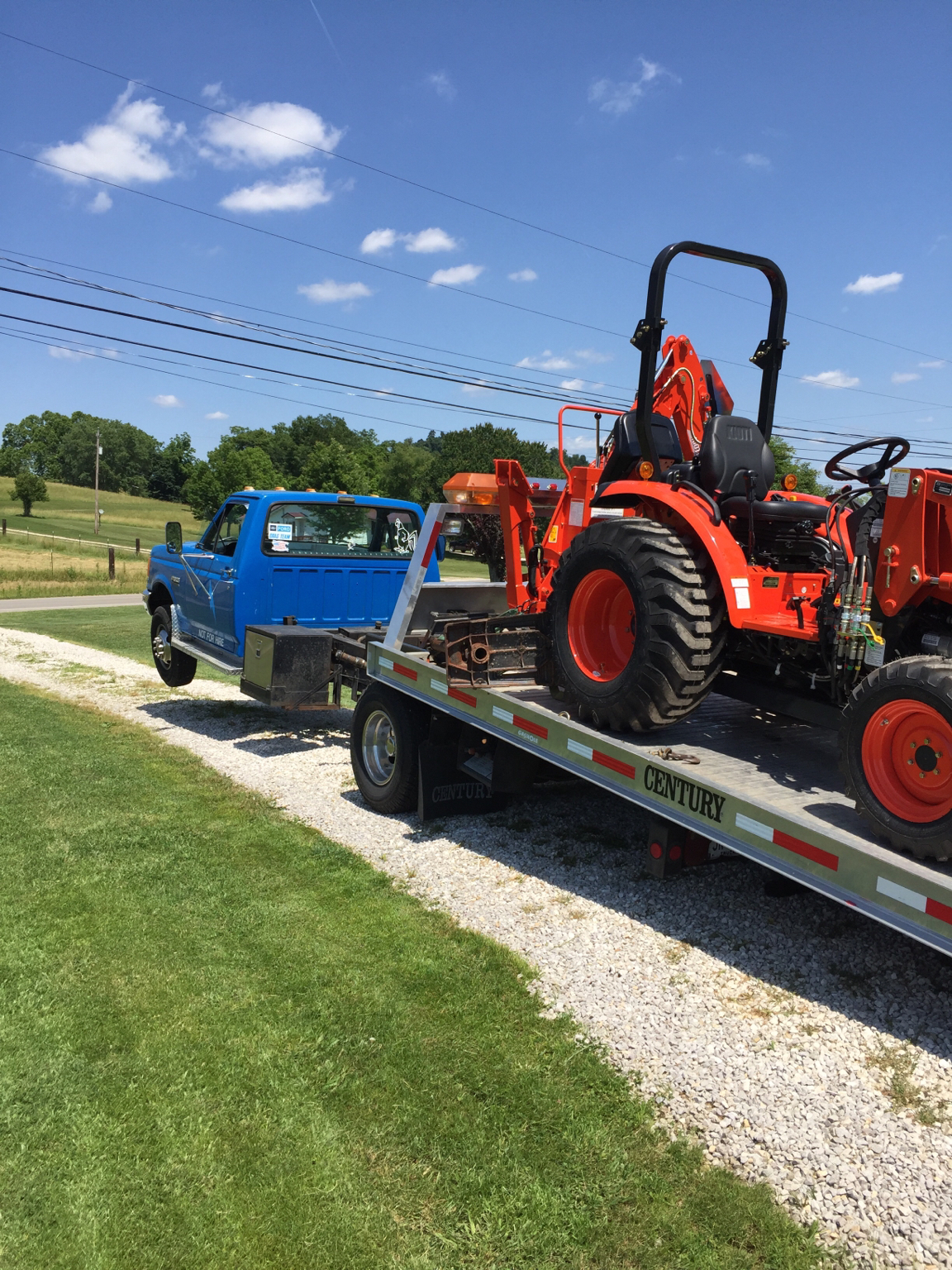

Hello, first post but been gleaning the site for a couple of months. I just purchased a CK 4010 with FEL and BH and then had the dealer add the 3rd function and a grapple bucket. The issue is they delivered the tractor today and unfortunately the grapple wouldn't work. To make a very long story short, I got in touch with Nelson at WR Long, what a great guy BTW, and he helped me troubleshoot late this evening even after they closed. We first traced out the hoses to try and determine if it was connected correctly but for some reason the pic he sent me of the valve block didn't match up with what I have. So... he then had me disconnect the line which was connected to the P port on the function valve and then start the tractor. We should have seen fluid being pushed through the hose and we did not... so now we believe the dealer connected it up wrong but I don't have a diagram of the valve block to determine which port is the power beyond feed. Does anyone have that or a 2016 CK 4010 they could post a couple of pics for reference? Thanks!!
BTW... here is a pic of the delivery. If I can post the pic...
