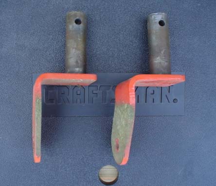

Now the complaints. First, both rear gage wheels have come un-screwed when mowing and fallen off. Bent the shoulder bolt on one. I've used lock-tite now, and they seem okay. Next, both of the rear gage wheels are identical. No left version and right version (see pic). That means that the right side wheel cannot turn a complete 90 degrees to roll the deck out due to clearances. Hard to explain without seeing it. It's not a huge deal, just an annoyance. Lastly, the ground clearance, in the raised position, is just not enough. I think the BX2200 has a better clearance with the deck on.
