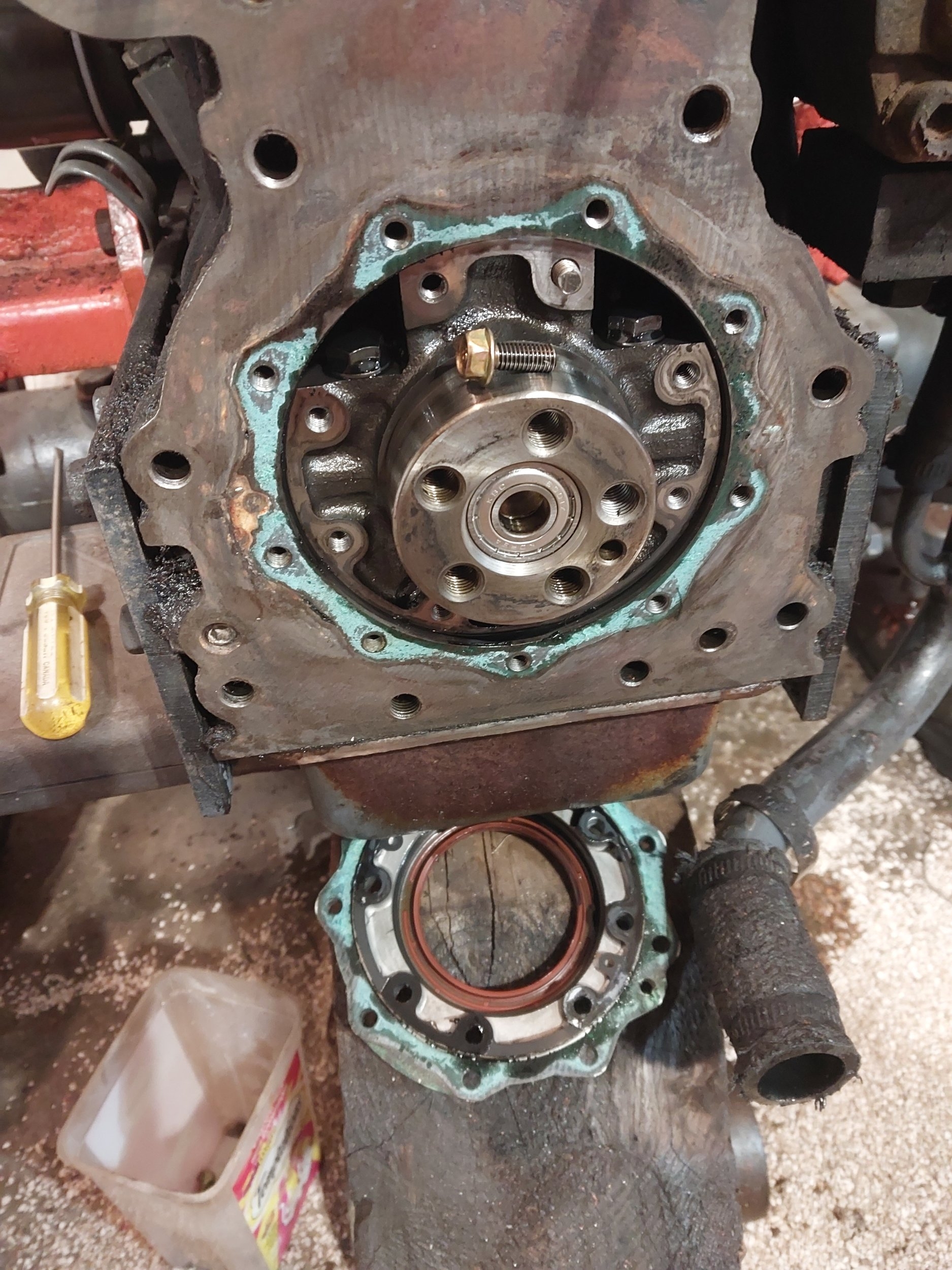

When you cracked the engine from the trans did it look like anyone had been in there before you??.......or was the problem a factory issue from manufacture?
With only 500hours?? I am guessing this was a factory QC mess-up......unless it was opened after for some reason.
Thanks for the pics.

There was no tell tale signs of a previous disassemble but you never know.

Glad you got it fixed, good thing you caught it before the casting got broken from the sideways stresses.

Update. As it turns out all of the interface plate bolts were not tight and the main bearing cover bolts were loose as well and one was broken, either twisted or sheared off. Picture to follow.
   / CK20 clutch
#17
Picture of broken main bearing cover bolt

   / CK20 clutch #18
Sure looks like the assembler zipped all the bolts on with an impact driver and did not come back to torque them properly. Not usually factory behavior.

   / CK20 clutch #20
It is a dam good thing you are handy and have the tools/patience.
Were you able to find all the bits of metal?
Main bearing still good/free of metal bits?
