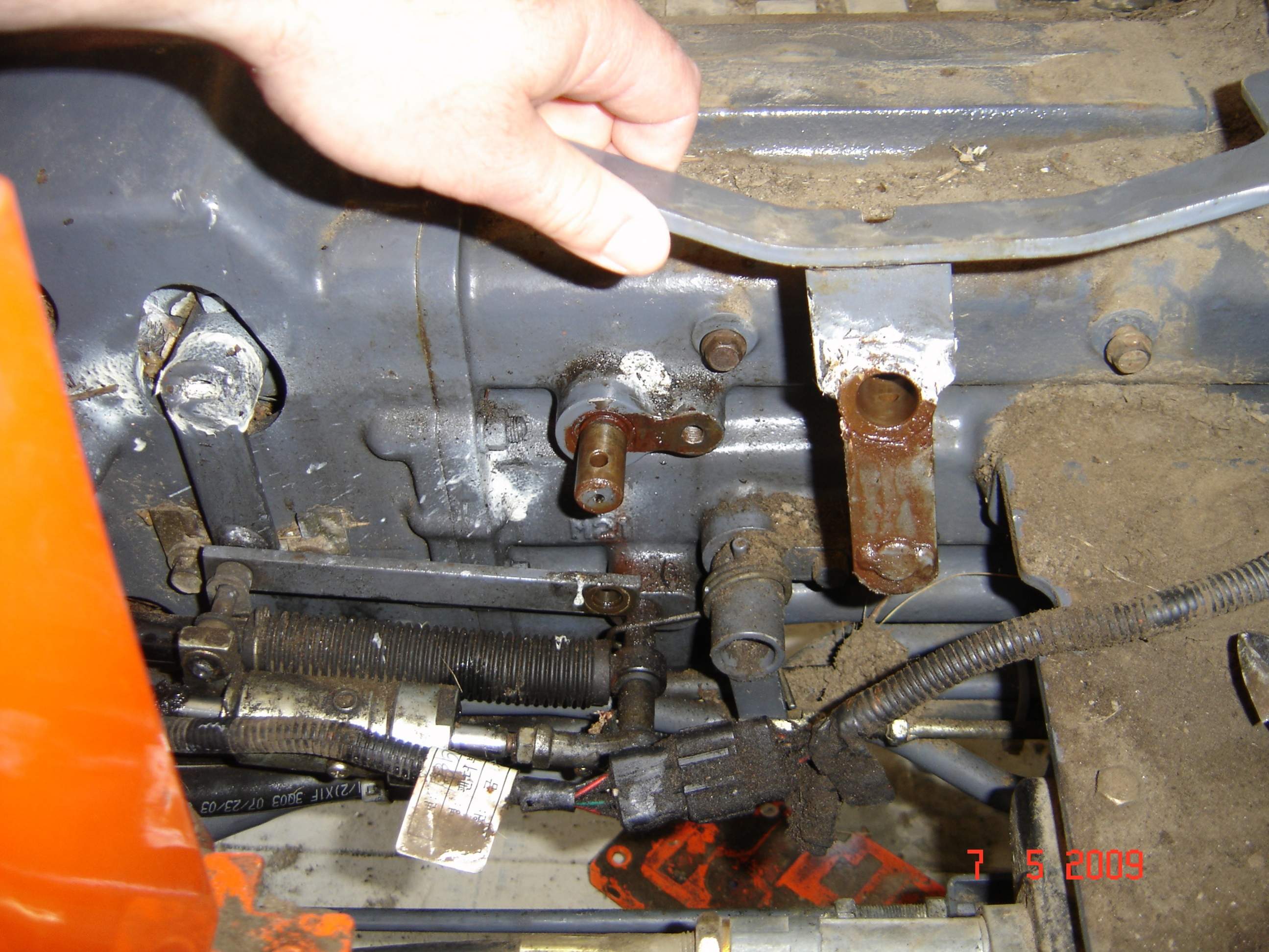

Anything new on this ? My '04 ck20 hst pedal is very stiff. I plan to take it apart and try the lube thing. I'm the second owner and it's out of warranty.
   / CK20 HST Sticky speed control pedal. #10
Had her apart this morning and found that spraying "Release all" on the pedal pivot at the trans case made a big difference. It's in the centre of the pic. Hope I don't have to do this too often.
