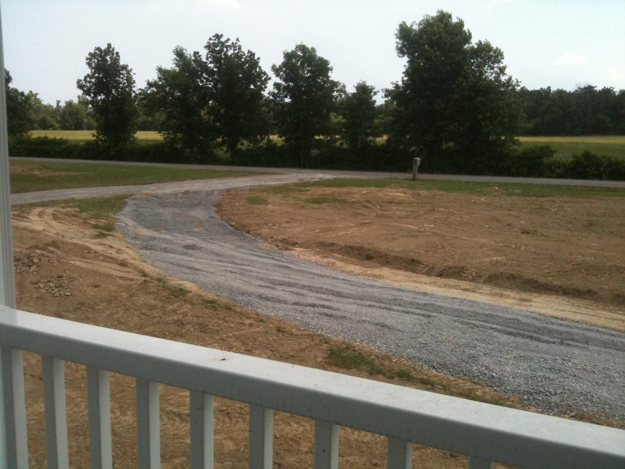

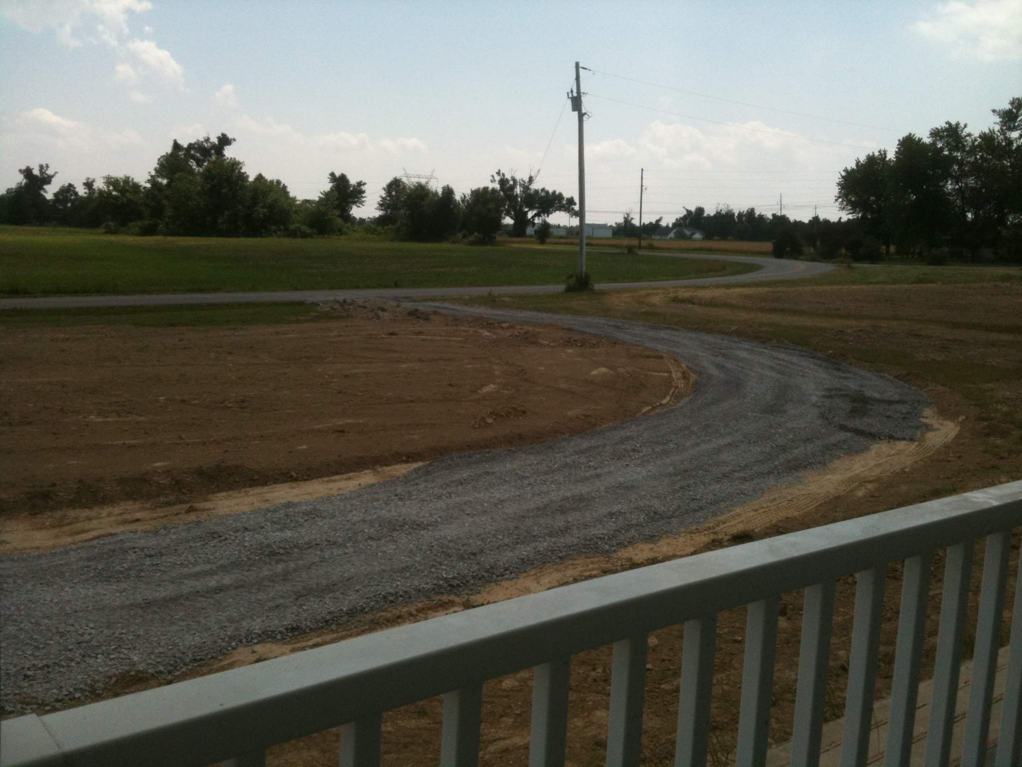

I have a CK20HST and have recently used it in much the way you intend to use your tractor. I put in a circular drive for the oldest daughter. It is about 220' long and the depth I cut out depended on how deep I had to go to get all the 'black dirt' out, it varied from 9" to 18". I simply tilled the dirt loose then used the loader to scoop it out. It took a while to do with a 4' tiller and bucket but I was in no hurry and had to be careful about being in the sun at the time.

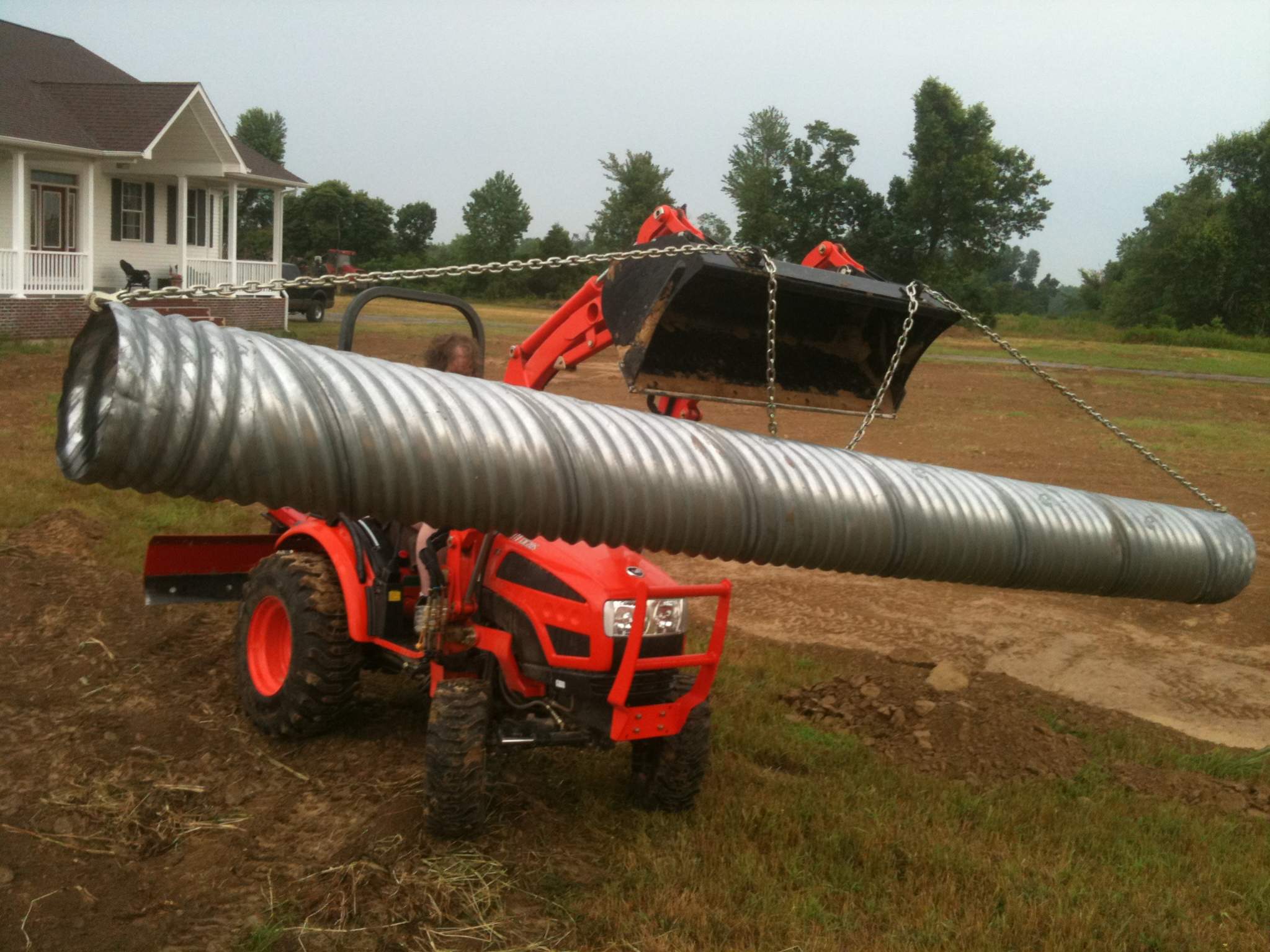

If you intend to do mainly dirt moving then get the HST. Daughter had never driven a tractor but after helping me unload the sewer pipe one morning she was hooked. That afternoon after the second triple axle truck load of gravel was dumped she came out of the house and stood around for a while then asked me if she could drive my 'toy'. I spent the next hour on the porch drinking lemonade while she dug, dumped, and spread gravel. Left hand on the steering wheel, right hand on loader control lever, right foot working the forward/reverse pedal, big smile on her face.

First picture shows daughter with sewer, second is drive after first load of gravel facing west, third is drive facing east to where it connects with the old drive. Notice in the first pic the hooks on the bucket. Handiest thing since pockets on a shirt.
