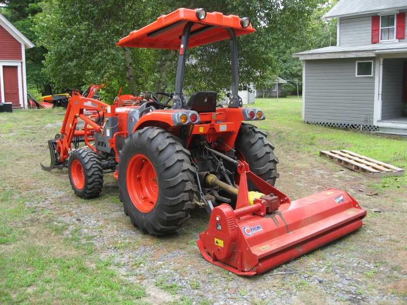

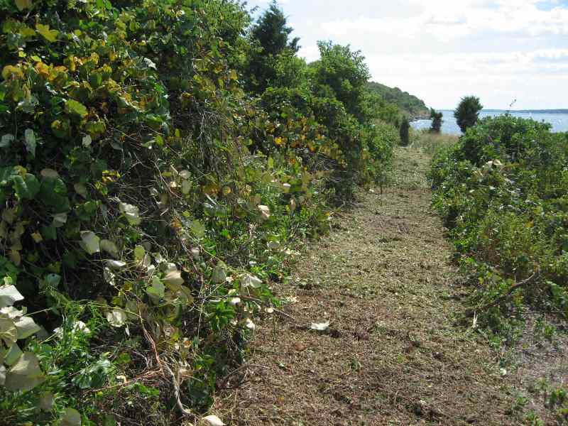

Flail mowers, depending on the knives mounted, can perform just as well as either the finish or rough cut mowers and what is especially attractive is that with appropriate knives they can straddle the range of cut produced by the other two mowers. The Caroni TM series is one of these "straddle" mowers. It is not as tough as a heavy duty rotary cutter that can knock down 3 inch trees, nor is it as fine a cutter as a lawn mower but it overlaps both of those types and can cut lawn tolerably well and yet also manage 1.5 inch brush with no sweat. It is a mulching type of mower so it leaves a pretty smooth surface without a lot of debris (unless you run too fast).
Caroni is a popular imported (Italian) flail mower that is available either as a finish mower (TL model which is just as good as a rotary finish mower) or as a multipurpose mower (TM model which straddles the two types as described above). Other manufacturers produce flails but most of them seem to be heavy duty flails which are quite expensive. The Caroni mowers cost about the same as a good quality bush hog or finish mower.
AgriSupply sells Caroni flails out of North (?South) Carolina. Not sure if there is a Canadian distributor. For the use you describe I'd think that a TM1500 (rough cut model 1.5 meter cut) would be perfect but I am not certain AgriSupply imports that model. They do import the TM1900 which I have but that is a bit too big for a CK20. I believe a TL1500 could be modified by eliminating some knives and replacing others with the TM style knife but you should look into that carefully to understand what you'd be getting into (at least several hours labor and about $200 in new knives).
There is a very long thread on TBN that you should read entitled something like "let's talk about flails". If you search on terms like flail, knife, caroni, belt then you will certainly find the thread which is still active.
