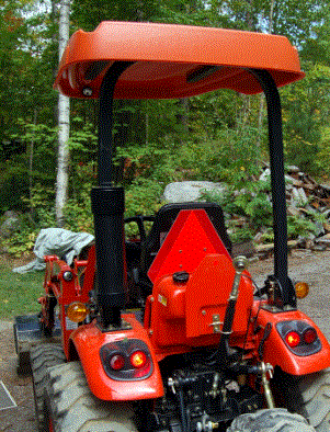

I attached a 4" pvc pipe to my ROPS. Used a pressure cap on the bottom and a coupling with a screw cap on the top, water proof and big enough for all I need. Am planning to add one to other side to hold shackles and a couple of nylon web slings. Attached pipe with 1/4" carriage bolts.

Donfi, I really like the neat and tidy look of that. Great solution for the smaller CUTs like my CK20. Not much room behind the seat...
Does this mean you drilled clearance holes in the ROPS frame for the carriage bolts? I'm not safety-copping on you here - I too believe the ROPS is sufficiently over-engineered that it can tolerate a few small holes. Acorn nuts on the front side would be a nice touch.
/ CK20 Tool Box #9
Yes I drilled through ROPS 5/16th holes' dealer said it would not be a problem. Yes I did use acorn nuts with nylon lock bushings.

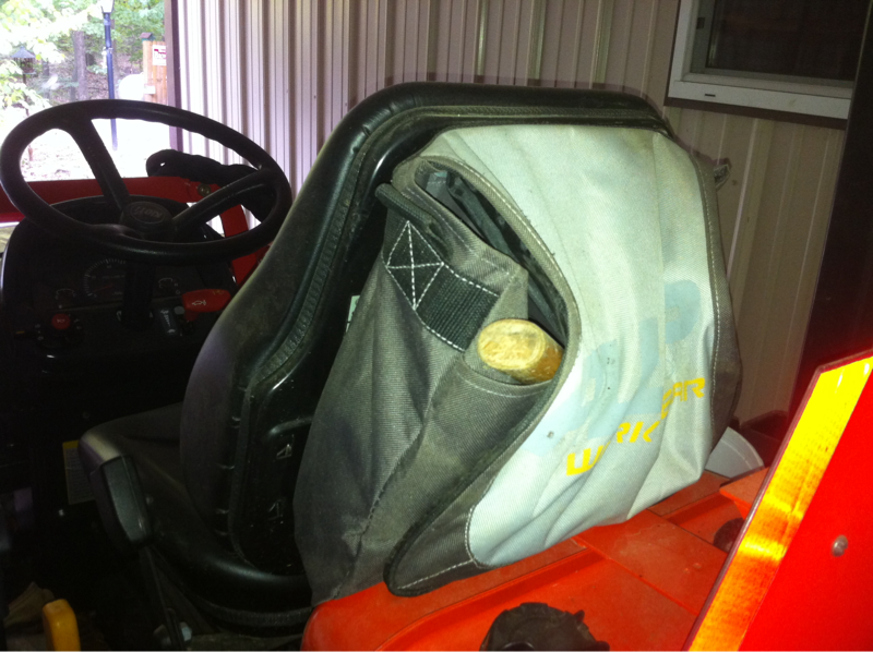

I used a canvas tool pouch I got at Lowes. I mounted it to the back of the seat. I used large flat washers inside the pouch and took the back seat cushion loose to add flat washers and nut to the inside to share the weight. Works and looks great.

Any pics?
/ CK20 Tool Box #12
Had to take the pics. Looks like I used a piece of flat metal too. If you loosen the seat back cushion you can get a flat washer and nut on the inside.
