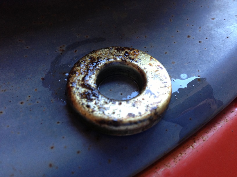

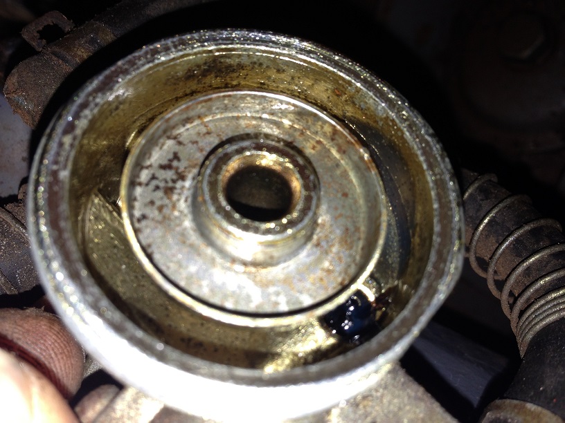

Had the same problem, see the picture below, seems the previous owner failed to remove the top from the filter in a previous change so the new filter would not fit on without crushing it some.. Take the bowl and filter off and look up at the housing...
Rancho

Check to be sure the metal top of the old filter is not still in place. I had a fitting issue too once and I found the filter had come apart when taken out and the top was still there. Very hard to see, so look close.
