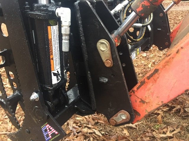

I need/want some pallet forks for my 2011 CK20s. I have yet to find anything online that will fit the loader. It is not a quick attach. Will I have to buy and install a quick attach first?

That’s what I did for my LK2554. I took the easy way and ordered the pin to SSQA adapter, grapple, pallet forks and a new bucket from EA. It worked out perfectly for me.

The short answer is yes, you need an adapter. ATI and WR Long make adapters, both are about $1k but worth it. Everything Attachments sells WR Long and you can probably get a discount if you buy the adapter and forks together.
