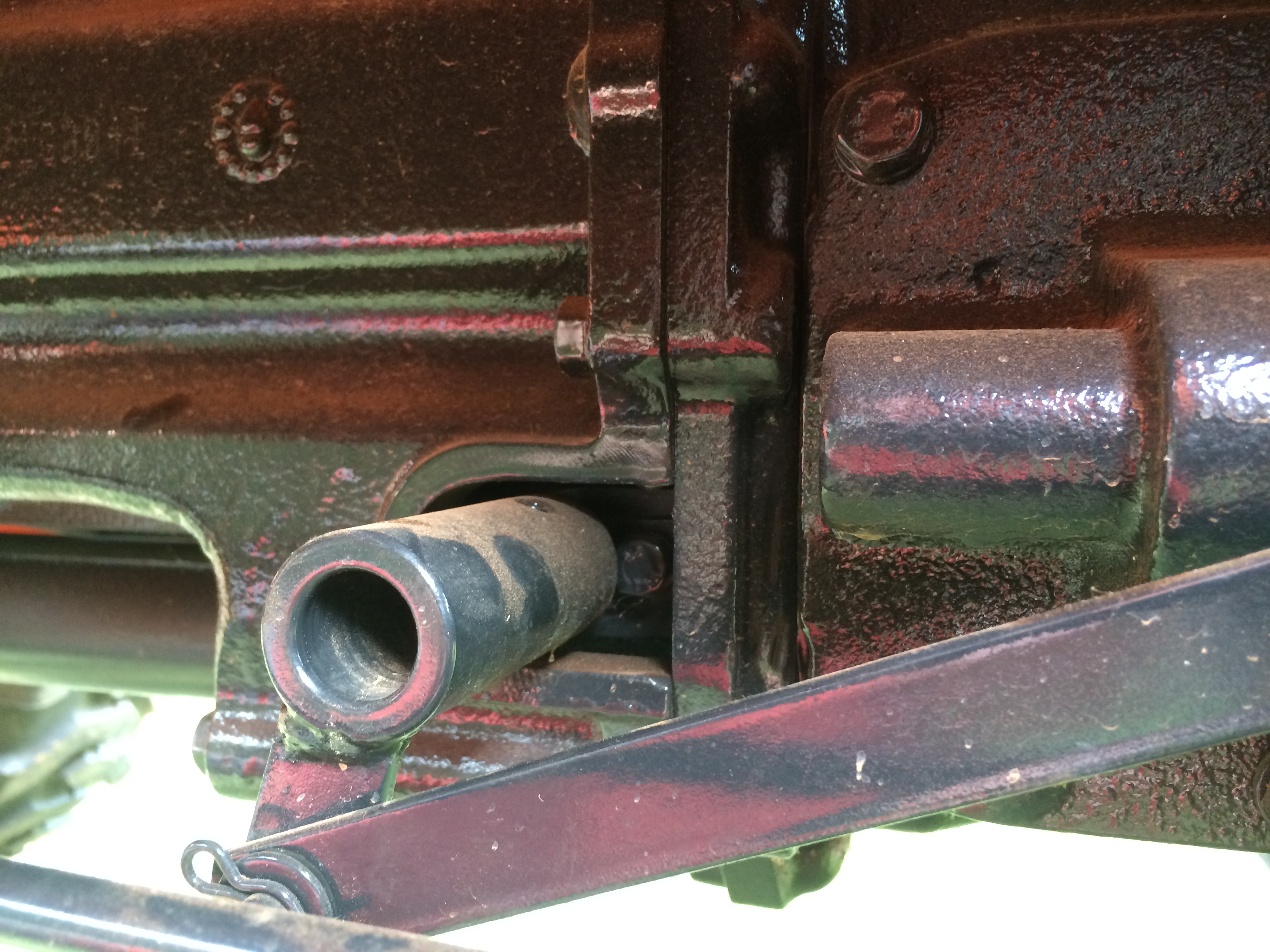

/ CK20S problem with 4WD not engaging
Thanks I see a roll pin where the collar attaches to the shaft going into the front transfer case and I can see the shaft turning slightly. I can feel some pressure on the lever when it goes down to 4WD and back up and the linkage is working up the point of entry into the transfer case (although there is only about a ½” of movement). With the front wheels up I can freely rotate the front wheels whether it is in 4WD or not and whether engine is running or not. I hear a slight ticking as they spin but I would think that might be normal. This tractor only has 129hrs on it and I put 29 of those on since May 1st of this year. It has been sitting in the originals owners carport for 5 or so years and I don’t believe he even put a shovel full of dirt in the bucket.

/ CK20S problem with 4WD not engaging #5
Sorry, meant to get you pictures earlier but got busy... So directly in the middle leading to the front axle is the shaft that drives the front axle and it is covered by a shield, it's held in place by a bolt at each end. undo those bolts and move the shield out of the way and you'll see that the actual connection that the 4wd lever controls is under there. it moves a sleeve over the shaft out of the transmission to also go over the shaft going to the front axle. Once that sleeve is over both then the front wheels are driven.
The problem I had and you might possibly have is at the front of said shaft by the front axle there's another connection, this connection is held in place with a ring pin. With mine it some how came out and that then caused the axle to no longer be driven by the shaft.
So that's why you have to pull that cover off. If all that is good (and you can test it like you did before by raising the front end and trying to spin the wheels.) then your problem is in the front axle. (unfortunately!)
If you need more info assuming you haven't already fixed it let me know.

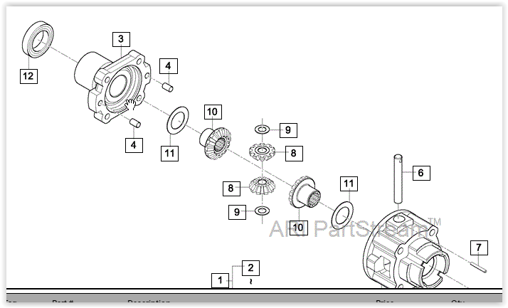

Thanks for the help guys. It turned out to be a cracked "cover, front differential case" item 3 in the image. It cost me $368 to get it fixed and I'm not sure what caused it or what could have caused it.

/ CK20S problem with 4WD not engaging #7
Well sorry to hear that, certainly more expensive a fix vs my missing ring pin. Did you notice if it was leaking oil from the cracked diff case? Did they show you the casing? was it a flaw in the casting? Can't say I've heard of anyone having a similar issue.
