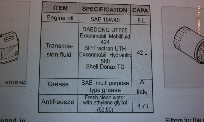

Could you attach a copy of the Kioti manual which ref the fluids?

/ CK230, why two filters? #8
there should be a better way to do this, but here it is

Somethings things just work!!! ok, thanks, now to shop for fluids. Again, I just fear Bobcat will stop carrying the fluid.

Your CT230 would be the same as the Kioti CK30hst. I don't believe any of the Kioti owners have found aftermarket for either hydraulic filter. Napa does have the engine oil, air filter, and fuel filter though. You can also get a K&N air filter that is washable and reuseable. I usually just call a Kioti dealer, none close to me, and order several of each filter. Prices are reasonable.
The Shell Donax TD hydraulic oil was a 10W-30 weight. As mentioned, it is called Spirax md now. Some use the 5W-30 weight especially up North where it's very cold. Amsoil synthetic hydraulic fluid has a 5W-30 weight. Other choices advised by Kioti are: Texaco TDH oil, Exxon Hydraul 560, Exxon Torque Fluid 56, Pennsoil Hydra Tranz, Mobilfluid 424, BP TracTran UTH, Citgo Mystik JT-5 Universal, and the Shell Donax TD which is now the Shell Spirax md.
