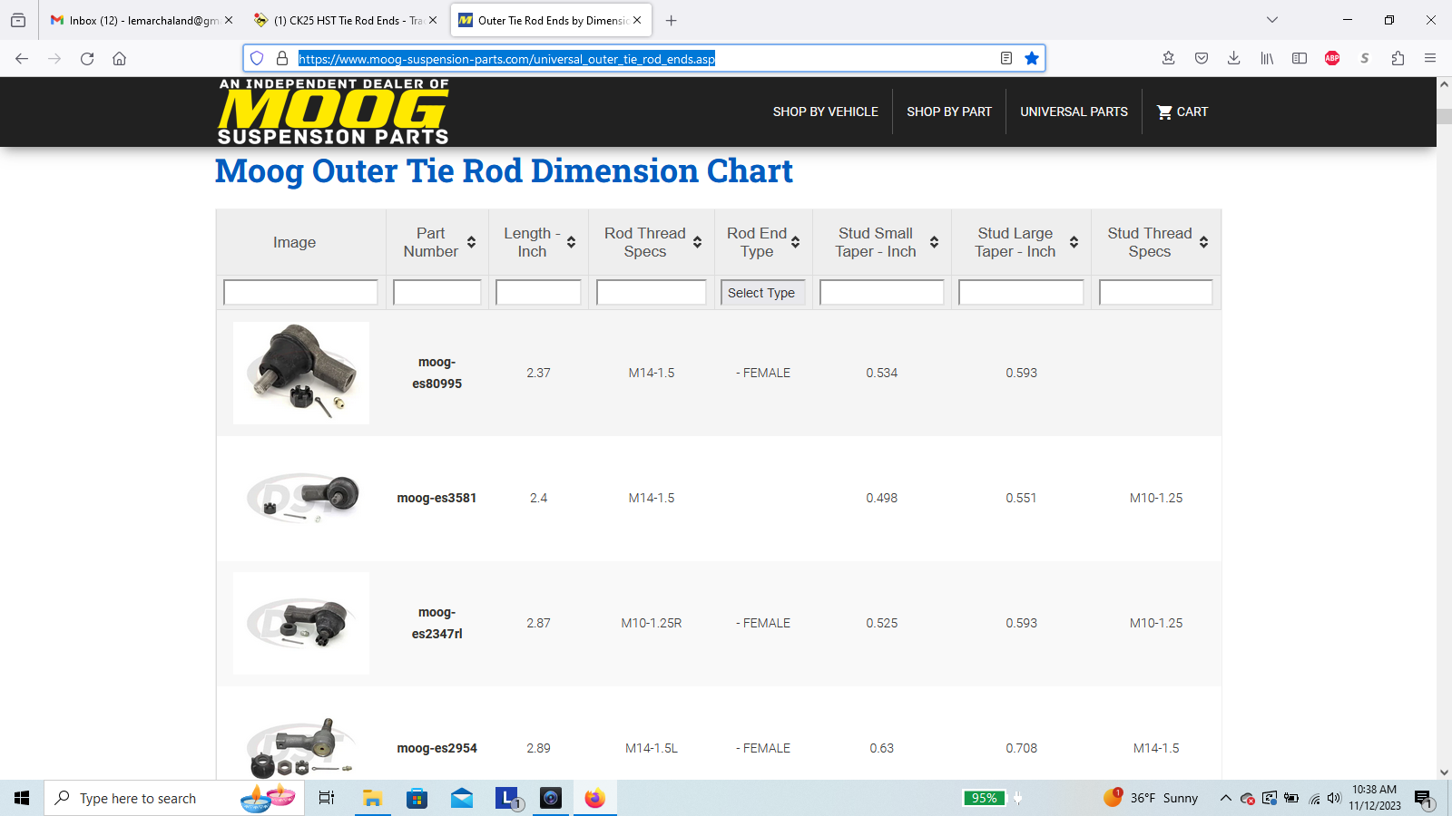

Here is a link to Moog suspensions tie rod ends by size,
measure the taper and threads desired, cross reference the moog number to which ever brand you prefer.
https://www.moog-suspension-parts.com/universal_outer_tie_rod_ends.asp
Thanks for posting this info up Lou. I noticed today that both my inner and outer tie rods on my NX4510 are shot. Hopefully I can match them up with Moog parts. I'll also post up on the forum looking for info in case somebody already has found the part numbers. (Update) I just found a pair on Ebay for $215 for the pair with free shipping. Kioti was $329.06 for one side.

Anyone know of an aftermarket alternative for the tie rod ends on a CK25 HST? My local dealer is up there, plus, I need to pay for the UPS shipping from the warehouse for them.
Thanks,
There are two sets listed on Ebay right now for $104.75 each.
