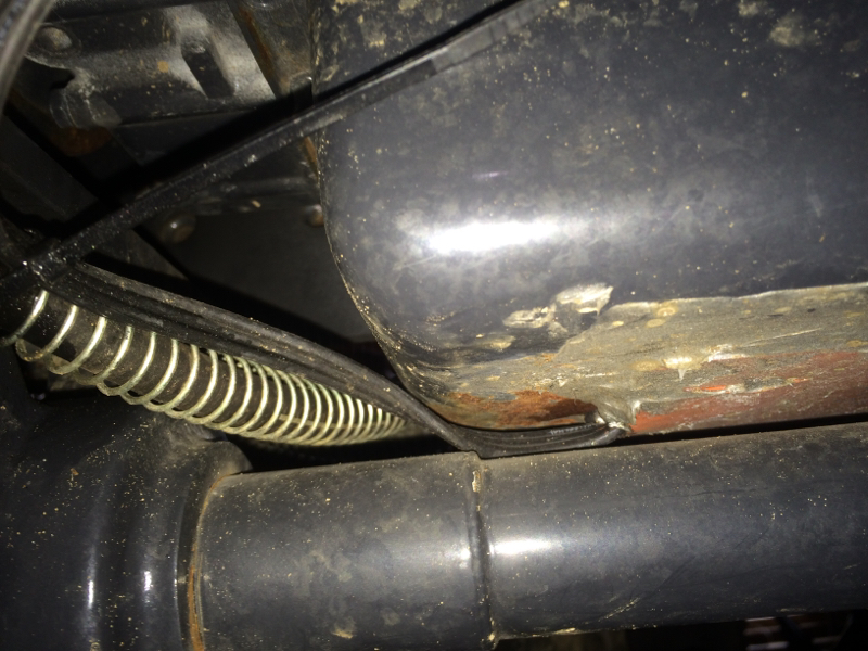

I have a ck 20s, my tractor came from the dealer with a oil pan heater installed. I assumed it was a factory install but perhaps it was a dealer installed item. On the Ck 20 it looks like it would be hard to install a traditional block heater as most of the glow plugs are obstructed( exhaust, motor mounts etc).
Installing a lower hose heater would probably work but it would require you to drain the antifreeze.
My pan heater does a great job heating the tractor up in fairly cold conditions and looks like a pretty easy install . It is just epoxied to the bottom of the oil pan with what looks like a standard two part epoxy. ... KG

Sorry wrong picture....
