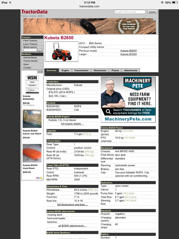

Kubota list a range of weights for their tractor. If you go by the heaviest the two tractors weigh almost the same. The Kubota loader lifts more. image-2645602348.jpg image-506198699.jpg image-1313022993.jpg image-353053078.jpg

I Was looking at that to after further research I think that is the difference from a cab model to no cab so I guess the Kioti is around 500 or so pounds heaver. I do like a heavier tractor and the ck 2510 is a nice combo of weight and power. But if the slightly larger frame and lift of the Kubota are beneficial then adding enough weight ballast shouldn't be a problem. They are both nice size tractors.
