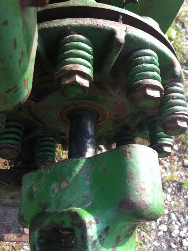

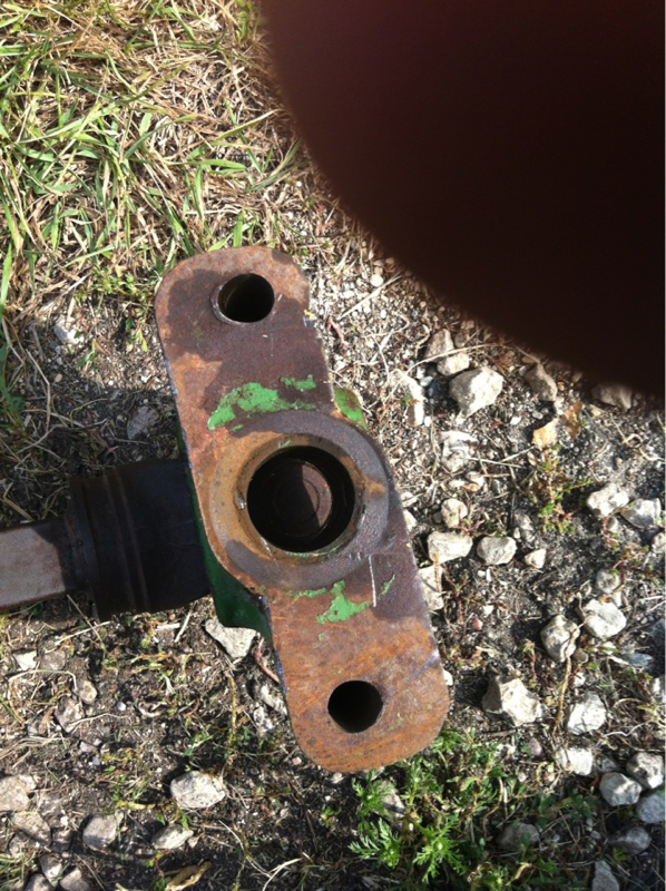

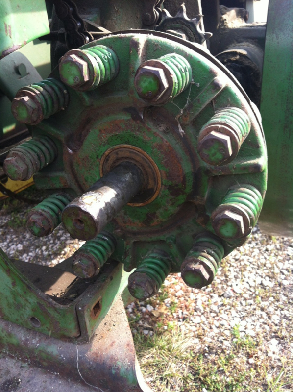

Well, another 600 bales this year... And then something went kaput with the slip clutch.
PTO turns, but the slip clutch does not engage. Can anyone decipher what the problem is?
Not sure if the clutch is seized but it looks like there should be engaging pins?
All help is appreciated!
