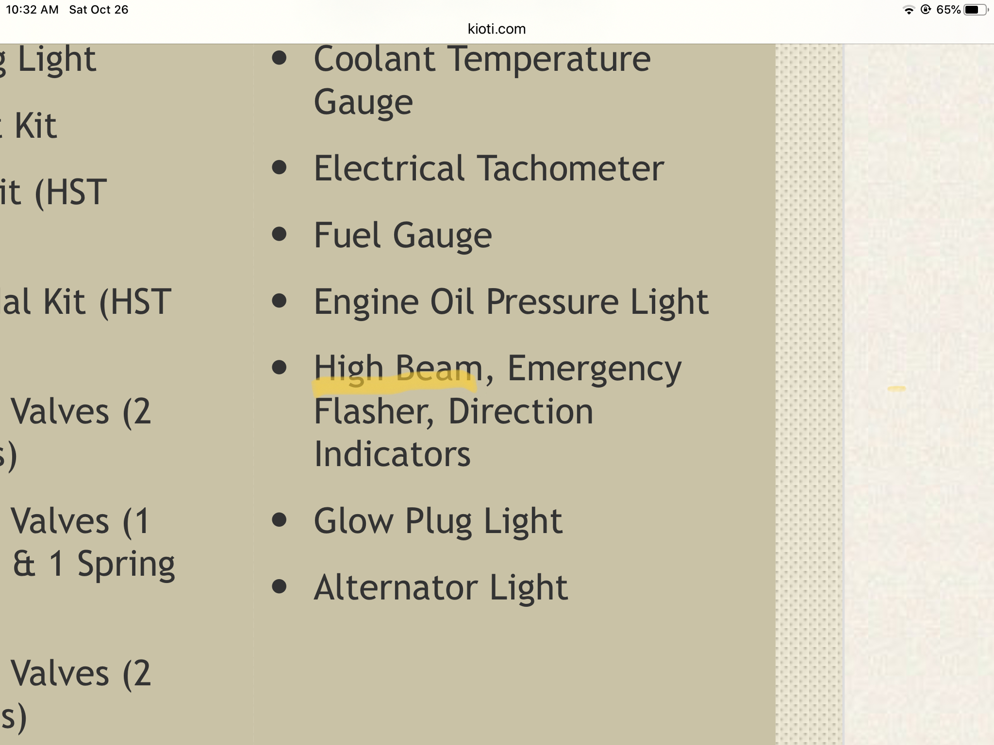

I'm adding LED's on the ROPS and was trying to figure out where to tap a switched leg for the light relay. Anyway, I only have 7 hours on the beast, and do not have a factory service manual yet. I found some schematics on the forum showing the electrical for the CK35 which I inferred would be similar. The CK35 shows a high and low beam relay on the schematic.
SOOOO, Website screenshot attached shows high beams included for the CK2610, no mention of low beams
Owner's manual says replacement headlamps to be 55W/55W, indicating low/high beams

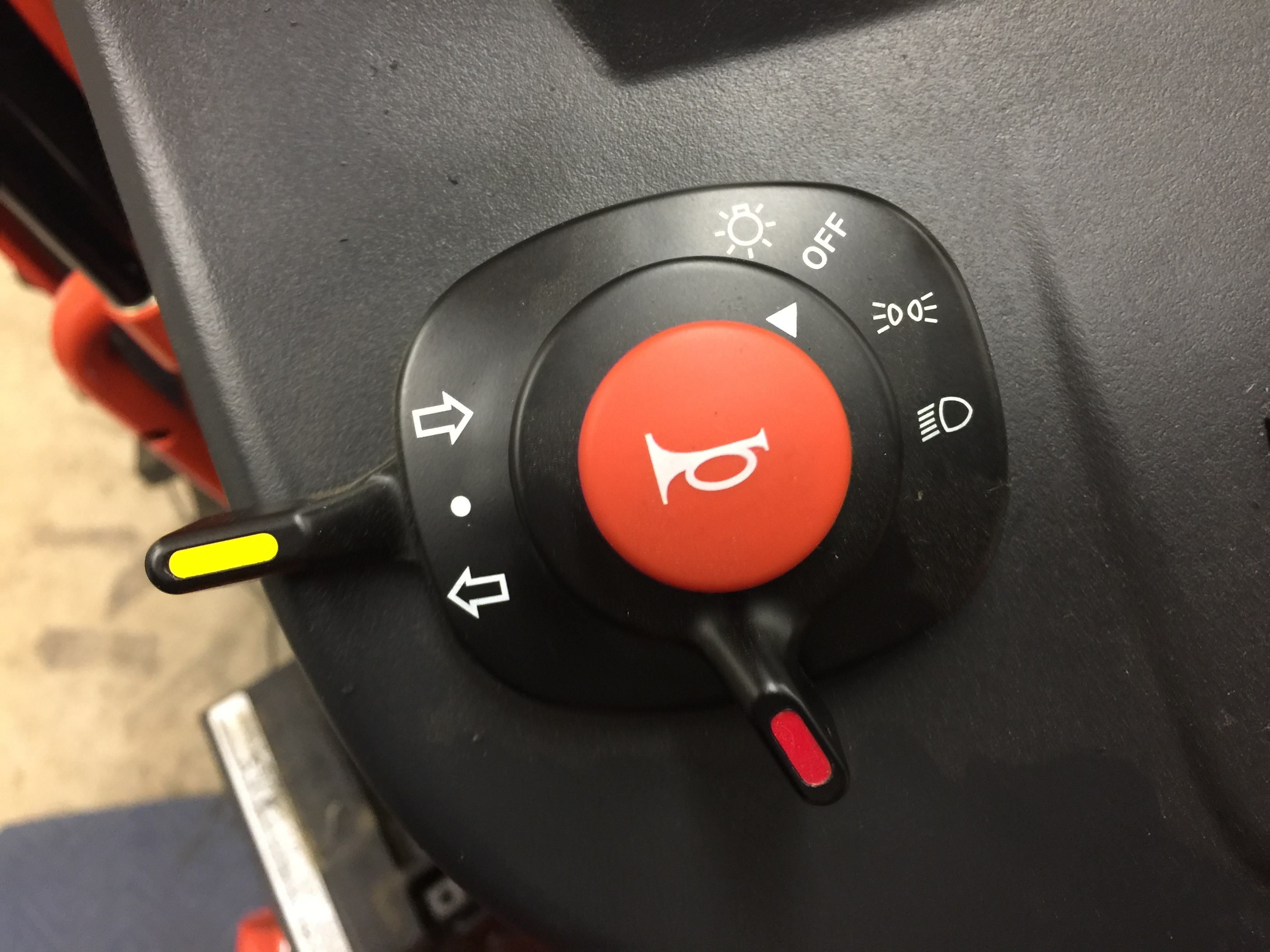

So looking at the switch at 1:00 position and going clockwise:
Light bulb symbol:
Owners manual: Head light OFF, tail light ON
Reality: Not selectable on my switch
OFF: OK, even I get that one
Switch symbol is two lights facing opposite directions from each other
Owners manual: Symbol not defined
Reality: Seems like this replaced the light bulb symbol shown in the owner's manual with no headlights and tail lights on.
Switch symbol is lamp with drooping light lines:
Owners manual: Low beams
So was this a cost cutting measure removing the high beams? The CK35 does have both high and low beams? I hate to take the tractor back due to lack of high beams, but a man's got to draw the line somewhere!

My CK2610 switch is the same as yours. Turn once and the panel light comes on, twice and the headlight comes on also. No hi-lo selection as the manual states. There is no way I would take mine back for that reason, but I am going to let the dealer know. Thanks for pointing that out. The manual also states of the horn button, "pressing the switch sounds the horn" but not on the CK2016. I'm more put off by the horn being optional than the high/low beam. Otherwise it's an exceptional tractor for its price.
