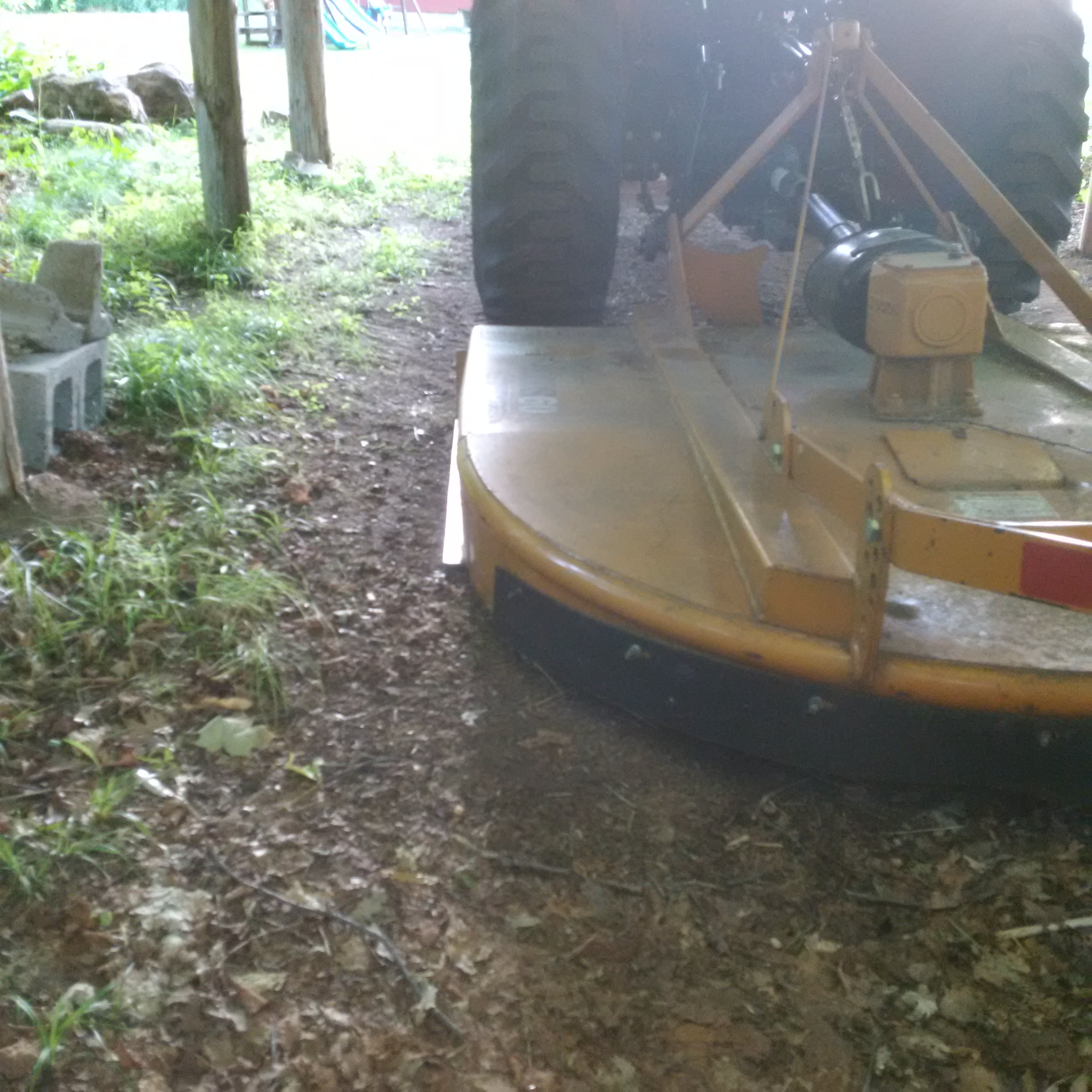

I can't insert insert an image from my phone but I have a 5' Woods and it covers the tracks perfectly. The widest part of the tires is 63" but the treads angle in at the point of contact with the ground and it's probably exactly 60"
   / CK2610 HST vs CK3510H #19
here's the image I took last night, it kinda shows how the tires too. I measured 63" at the widest looking down but they angle in about 1.5" on each side
