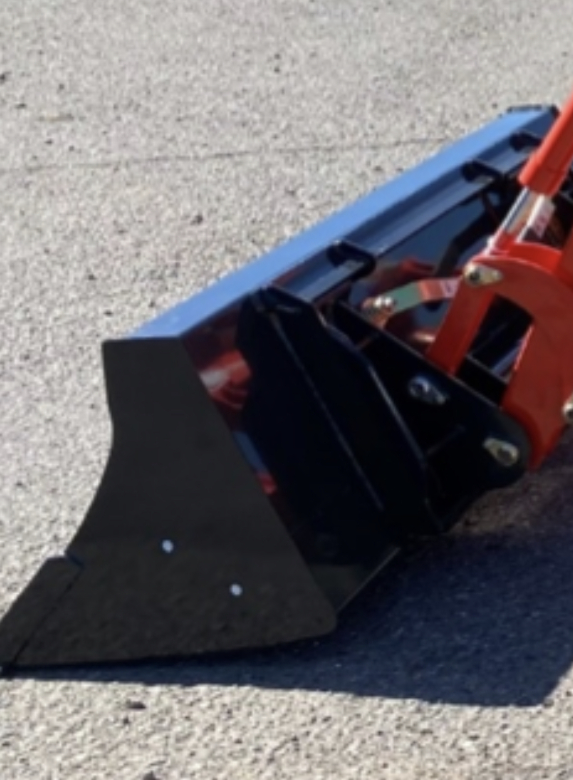

Looking at the kioti ck2610 and bobcat ct 2025. Looking at loader lift capacity I see kioti is roughly is 1800# and bobcat is 1300. Is that correct? Is that about the only performance wise difference?
Thanks.
   / Ck2610 vs ct2025 lift
#2
Never mind. Looks like kioti rates at a different height than bobcat.

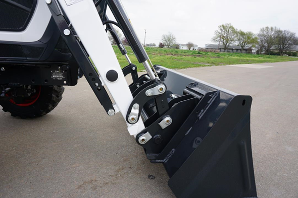

The Bobcat loader is not the same as the Kioti. Note the bucket tilt on the Bobcat, 4 Link, Better curl power and dump angle.
   / Ck2610 vs ct2025 lift #5
Great question. The cylinders are not hooked directly to the bucket or quick attach plate. The other benefit is that if rocks or dirt flow over the top of the bucket it does not hit the cylinders.
