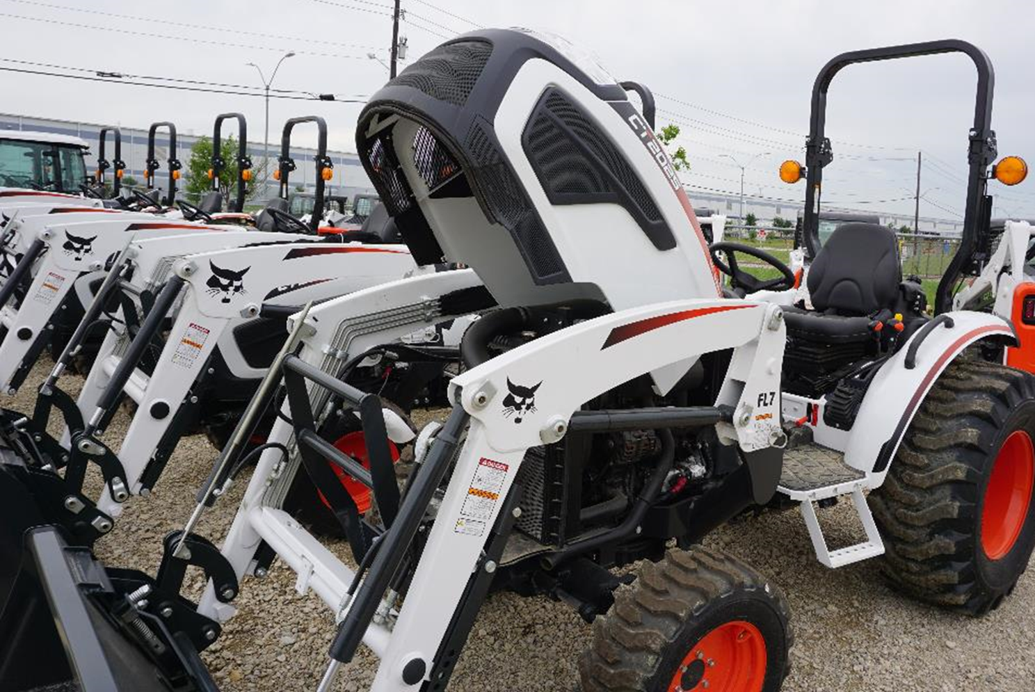

One other point you may want to think about is the grill guard. I think the Kioti you must move forward every time you lift the hood. The Bobcat hoods opens with out the need of moving the grill guard every time.

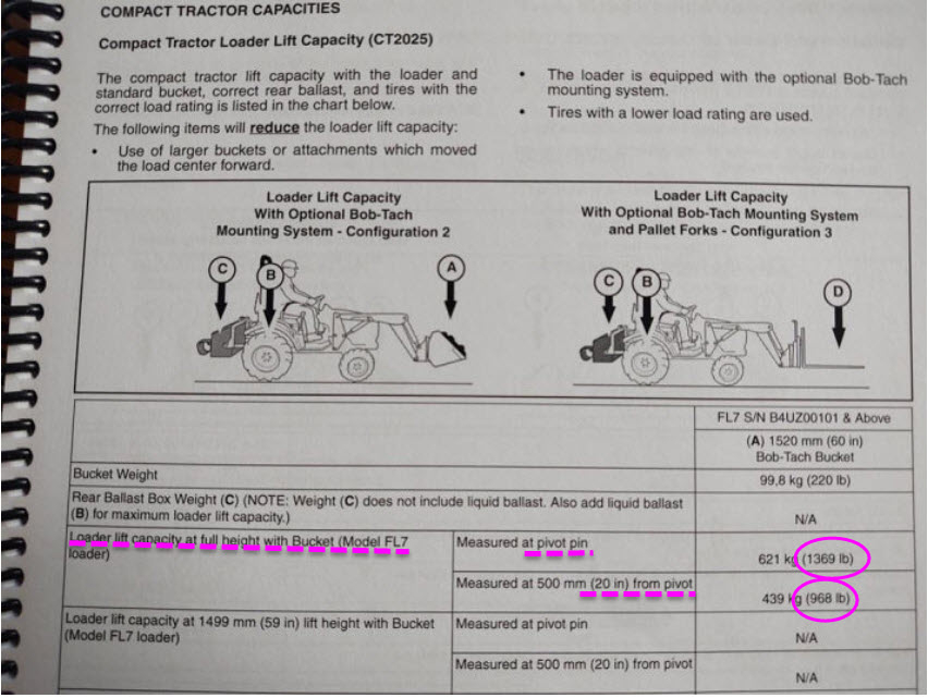

Purchased a CT2025 in May 2020, delivered Dec 2020. Bobcat of Richmond and the corporate Bobcat engineers where no help on this topic. Both quoted and insisted on the advertised numbers instead of just reading the factual specifications from the (secret) manual.
What I discovered on delivery is that Bobcat, at that time, lied about the lift capacity of the loader stating it was 1369 lbs @ 20" forward of the pivot pins. I had a known task of offloading 1200# pallets, so I asked for confirmation prior to ordering (none available to test). The dealer called the corporate engineer. The corporate engineer repeated the lie.
The truth is 400 lbs less as shown in the spec table of the attached manual.
The 968 lbs shown in the manual is consistent with my on-site experiences offloading 1000 lbs to 1200 pallet deliveries.
The Kioti 4030 loader has superior lift specs. Back in 2020 I watched a youtube video where the CK2610 w/4030 loader lifted a pallet with 1800 lbs of bagged material. That video showed the bags added until it could not lift them. I was not able to find that video today.

As far as the infrequent 1200# pallet, it won't curl/lift them from ground, but will hold & lower them without dropping them off the trucks.
As a sidebar, lifted and carried 1582# bundles of steel siding using rigging straps, shackles, and removing the forks using only the quick attach frame.

FEL difference between the Bobcat and Kioti was the main reason I went with a Kioti. I was headed in the direction of a Bobcat until I saw the weight spec differences between the Bobcat and the 4030 loader. You can also see the cylinders and FEL mount on the Bobcat are different in size and shape. I do like the white color of the Bobcat but that wasnt enough to overcome the FEL
