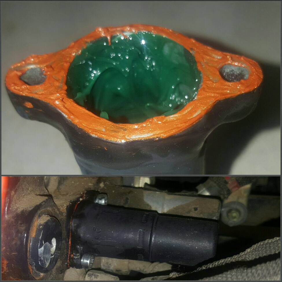

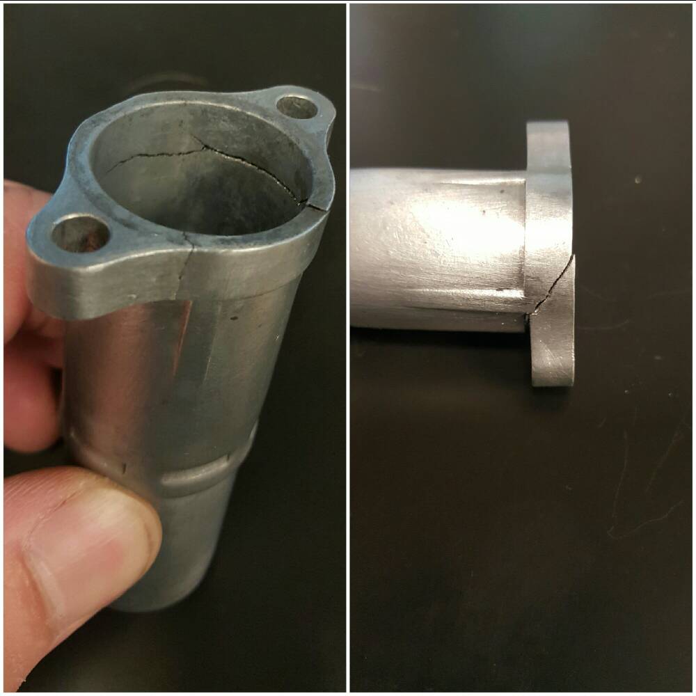

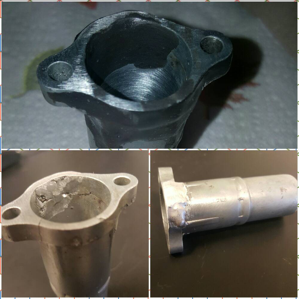

Well I finally got it fixed. Thought I'd share a few pics of the damage, the repair and how good it looks when it's right. As far as the repair, Coyote Machine was absolutely right and I actually knew better. Cast anything is hard to weld, but aluminum is horrible, but we tried anyway. It tacked OK and got it pulled back in but then blew outthe inside. I smoothed it all back out with some JB weld, let it cure and sanded. Painted, lubed up and put back on. Works like a champ and the float operation even seems a lot smoother. uploadfromtaptalk1453140143555.jpguploadfromtaptalk1453140158723.jpguploadfromtaptalk1453140168481.jpg
   / CK30 FEL Won't drop #14
Nice job and it looks good as new. You probably had enough fun for a while but when you get a chance, pull the other cup off and take a look. I bet it's getting a little corrosion. Clean, grease, and seal like your picture and the bucket roll should be good for a long time.

Well crap, dang thing broke again. Guess I'll have to buy one this time. Anyone know where to get one aside from the dealer? Who makes this valve body anyway?
   / CK30 FEL Won't drop #16
Sorry to hear that. I thought your repair was going to work. That time a member posted a few years ago looking for the cap, he said he was trying tractor junkyards but wasn't having much luck. I guess our tractors aren't old enough yet. I'm sure Kioti outsourced these just like the BH valves and injector pump, but I haven't seen anybody post a manufacture name. Never looked at mine close enough to see if there was a company mark on it.
