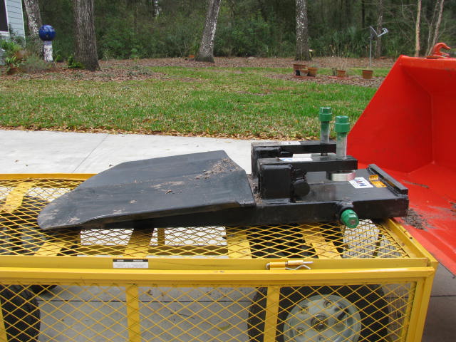

While it is NOT a backhoe you might consider a clamp-on bucket spade for occasional digging. Any bucket spade surely beats a shovel-in-your-hand.
Several companies offer bucket spades. Mine came from Bucket Solutions.
Bucket Forks, Tractor Forks, Loader Forks by Bucket Solutions
I own a Kubota B3300SU......and I like it. Only Deere and Kubota distributors in my area of Florida.
