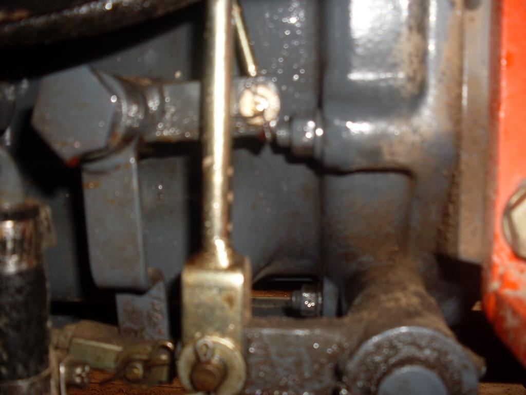

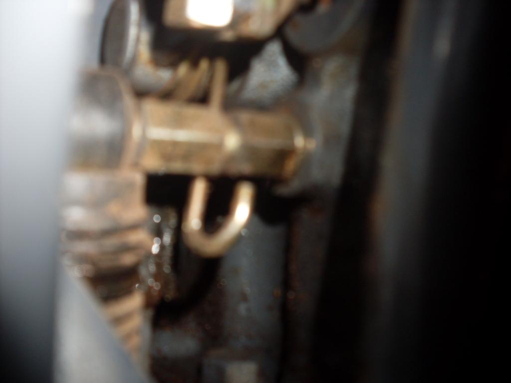

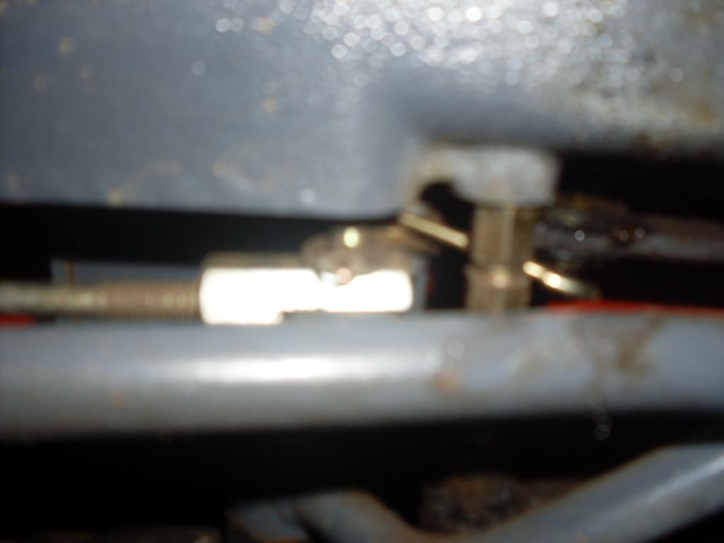

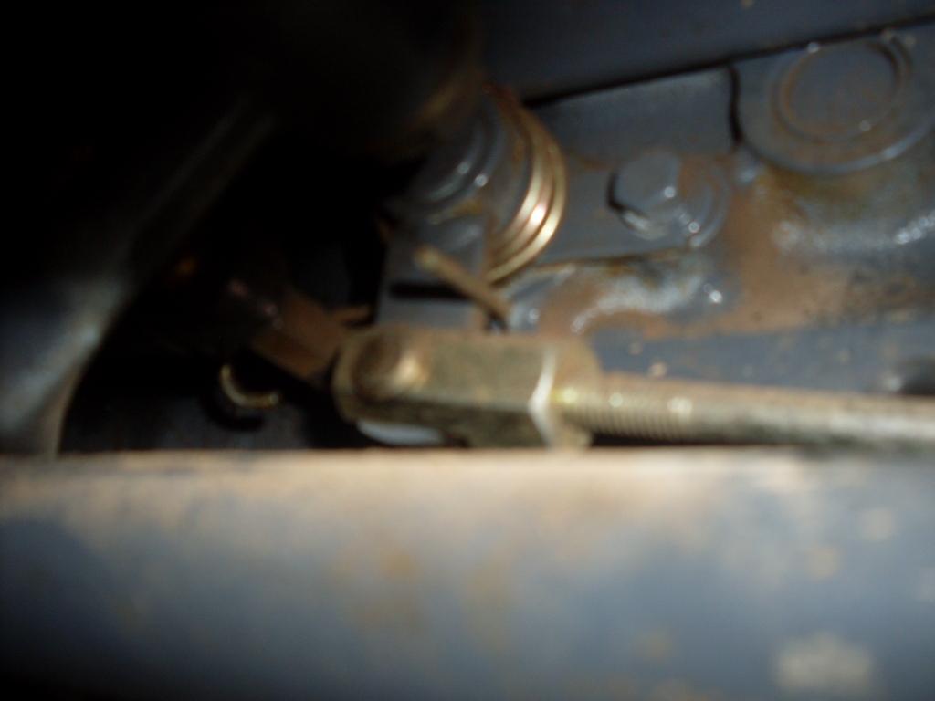

I've found something under the tractor that doesn't look right. Maybe some of you guys can chime in here. I'm going to post a few pictures to relate what I have found and maybe a dealer or someone smarter than me can explain what some of these levers do once you picture everything together. It was hard to get pics between the hydraulic lines that run friont to back and the camera was trying to focus on the wrong thing.
Pic#2 Start here, the rod in behind is what is connected to the yellow lever that locks your HST pedal. It's connected to the rod below via the 90 degree pivot.
Pic#3 This is the other end of the rod connected to a shaft I think that enters thru the side of the transmission and I assume when you put the lever up it locks something in place inside. This whole rod assembly (mine anyways) only moves about an 1/8" from off to lock. If look you can see the end of a return spring sticking out at 90 degrees to the shaft.
Pic#4 This is the other end of the spring which I assume is suppose to be hooked in the groove that you see. There is tension on the spring as it is resting on the shaft. This shaft has another part of the plunger assembly attached to it.
Pic#1 This is another view of the spring not in place and looks like it wouldn't line up anyhow.
There are adjustments in the rods but I don't want to play with them yet until I get some feedback from you guys. This speed locking shaft has me wondering whether it is related to my pedal sticking.
Thanks in advance
