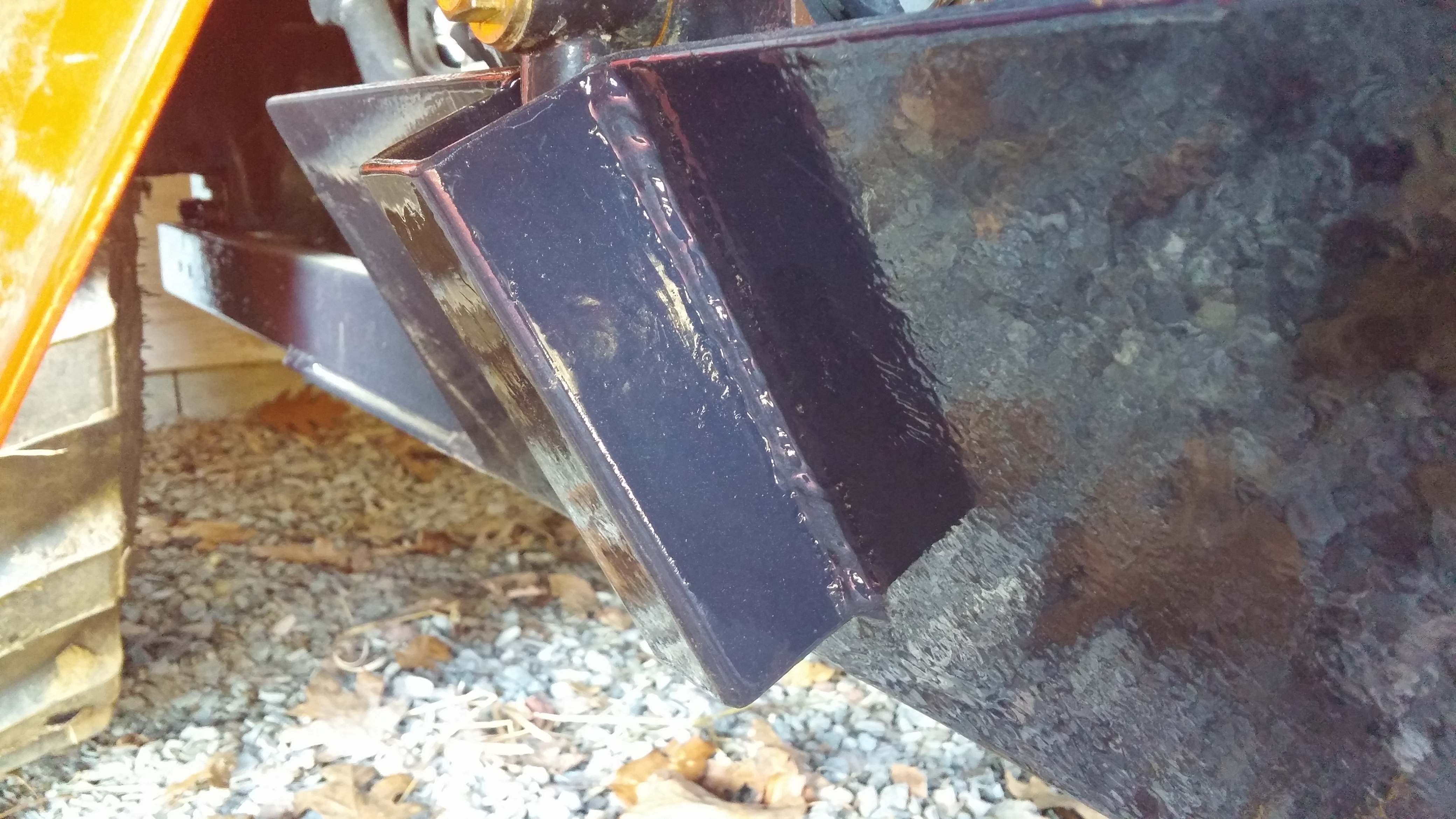

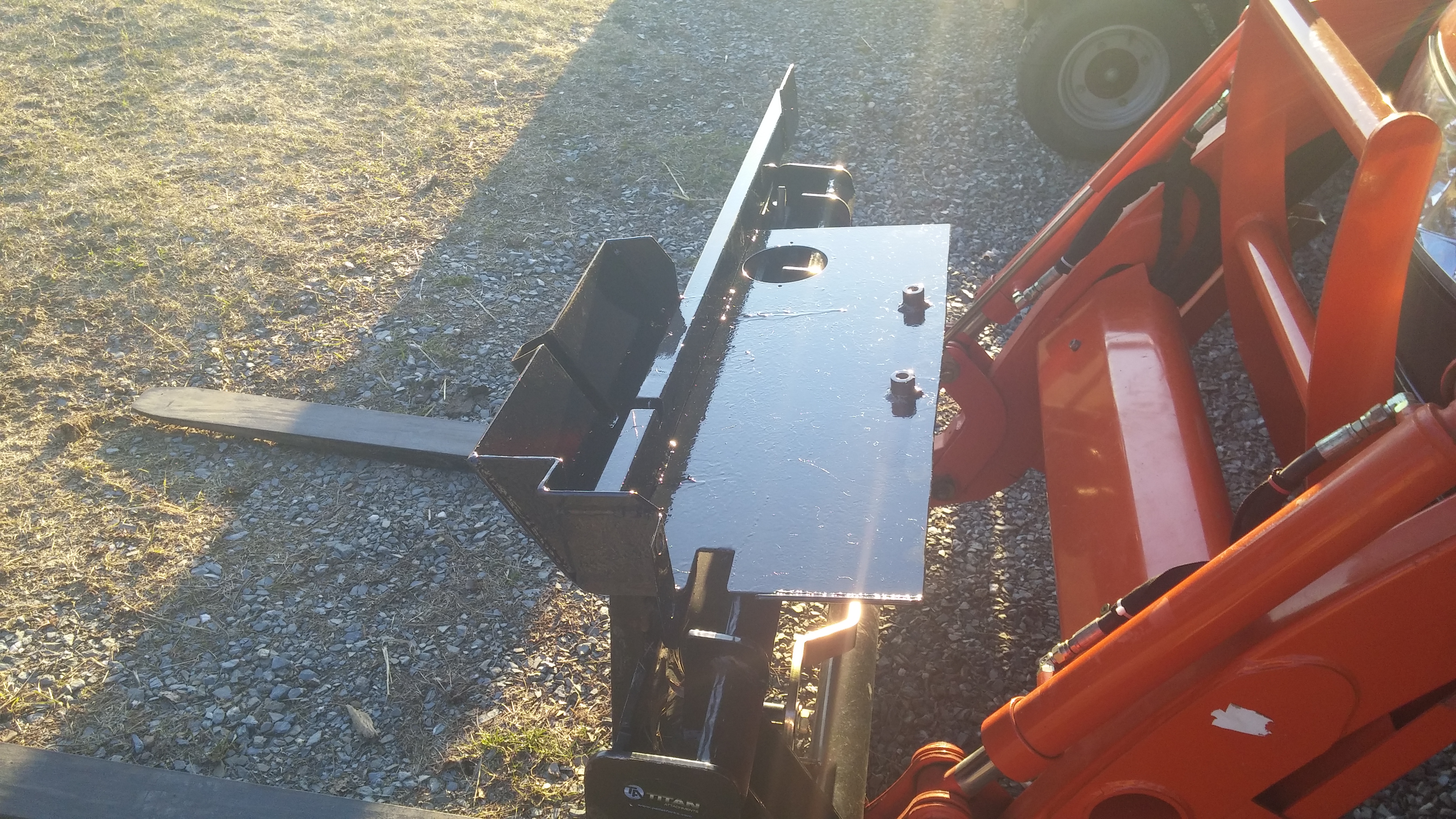

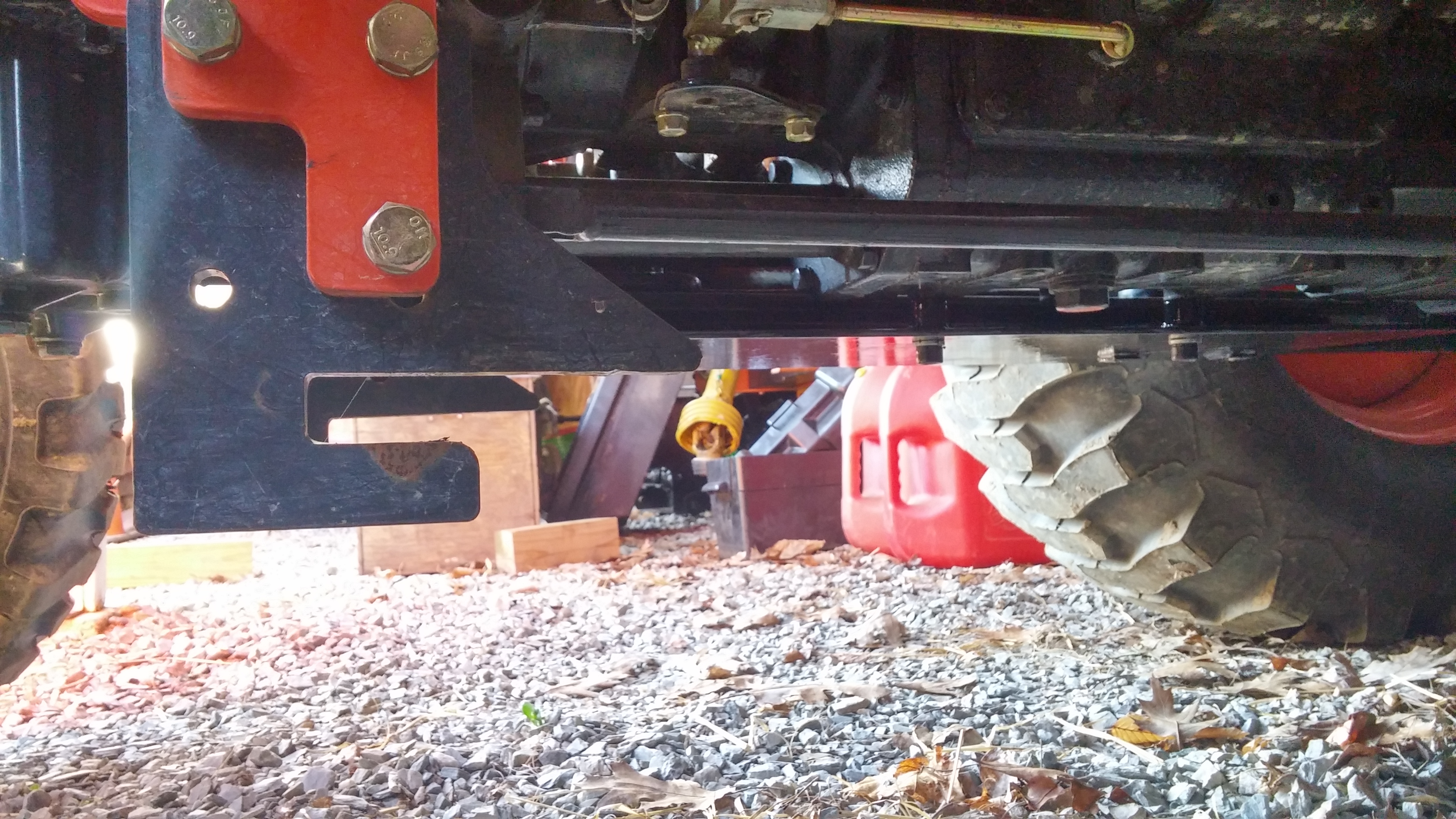

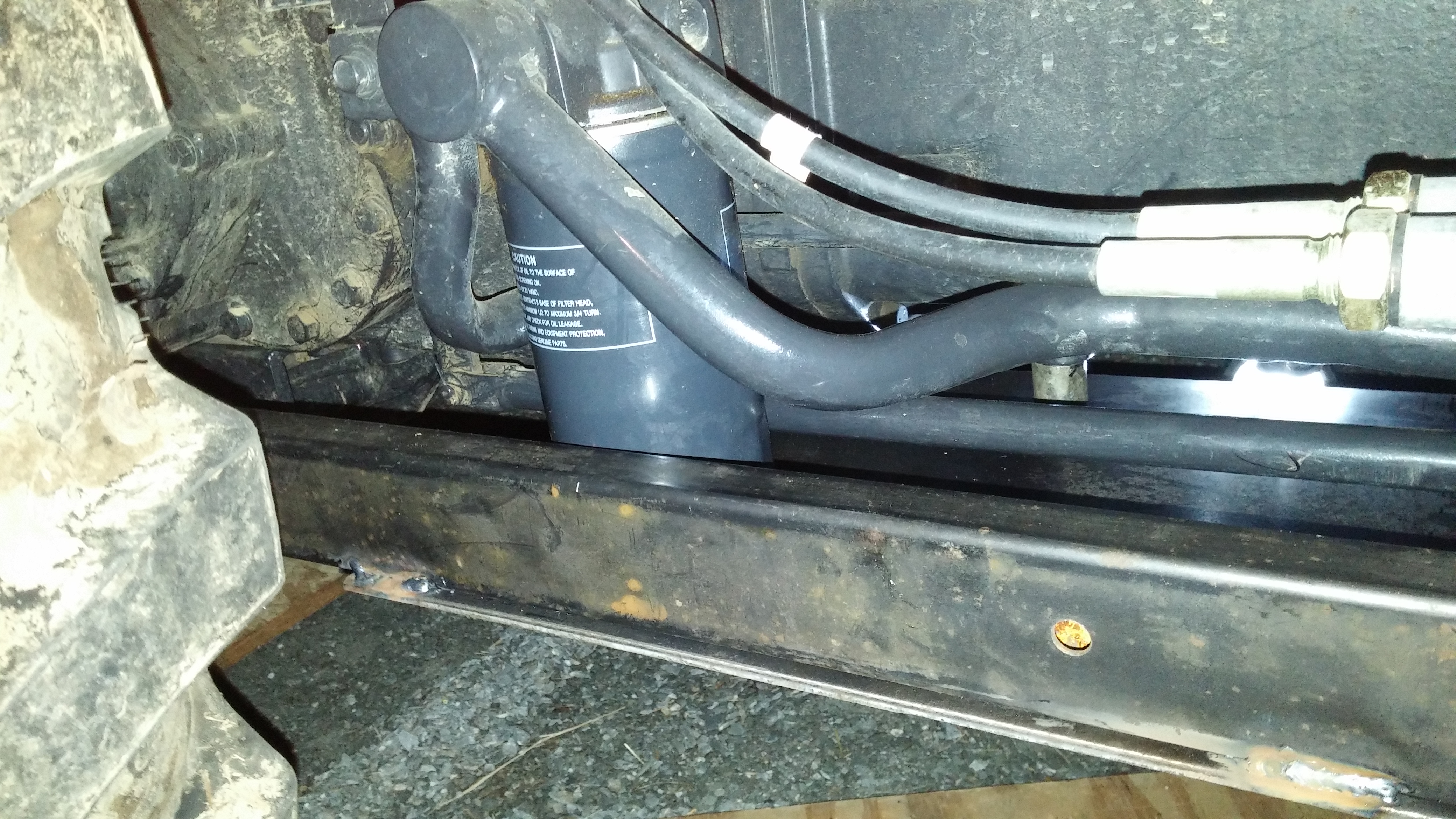

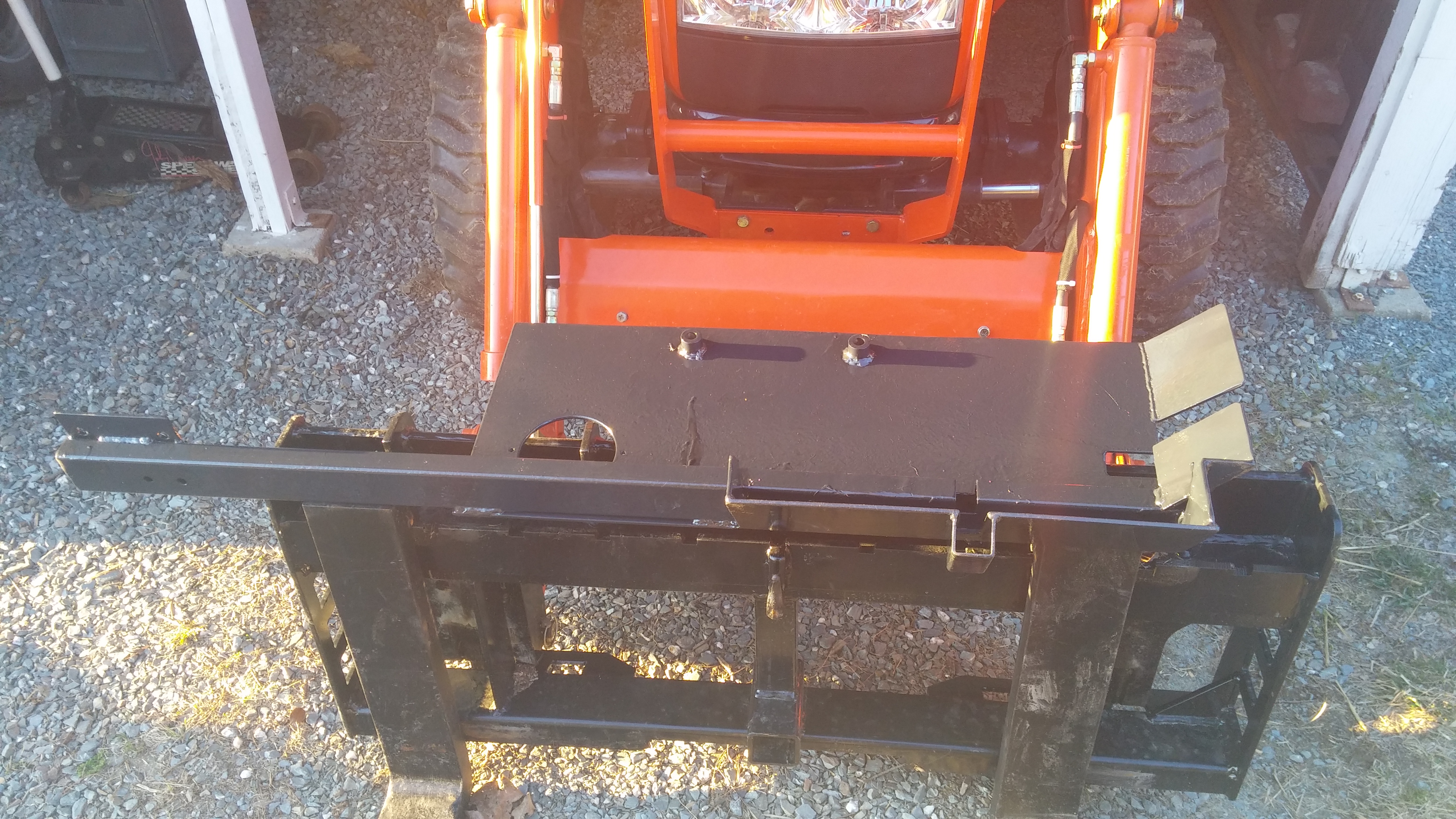

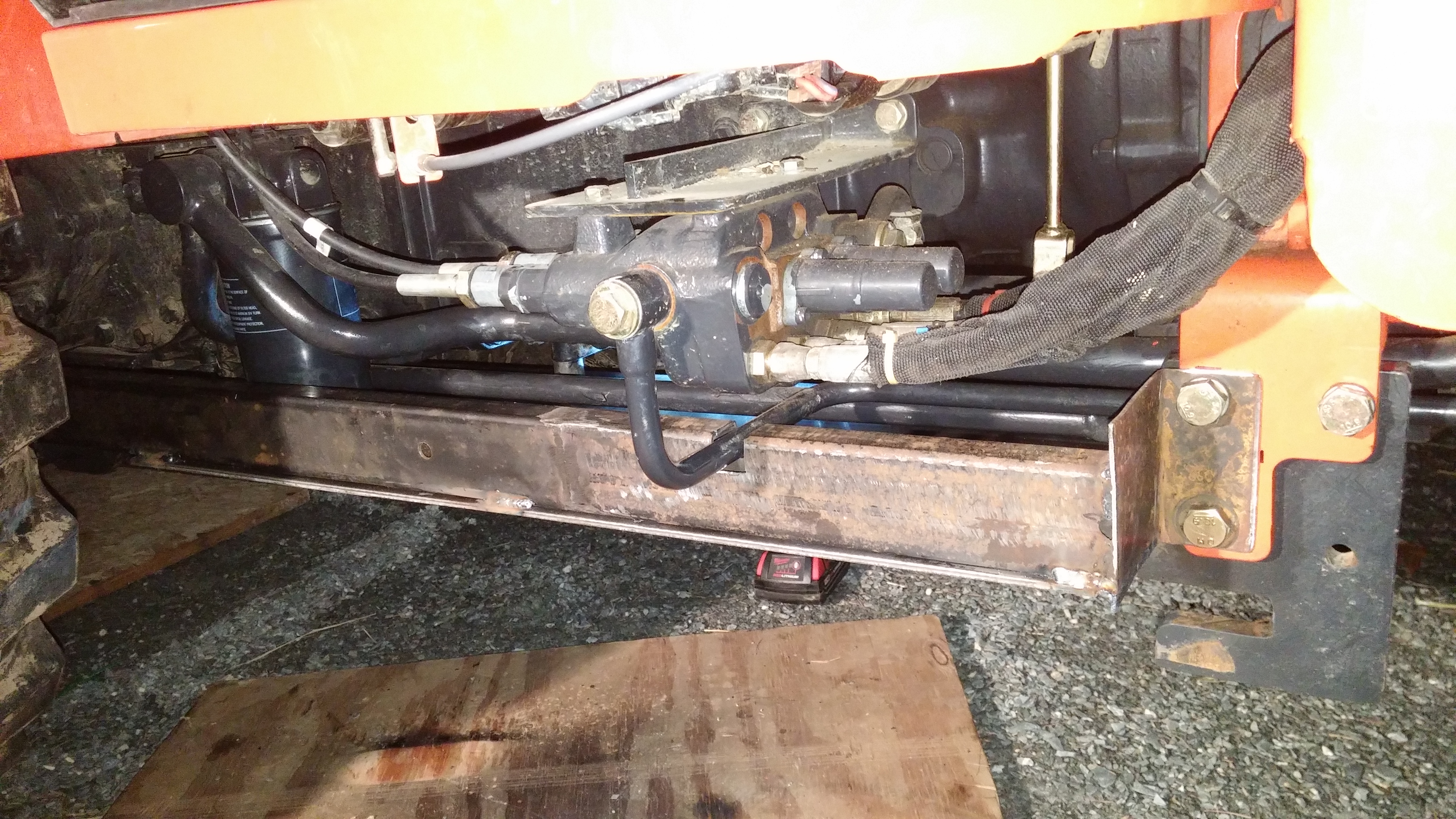

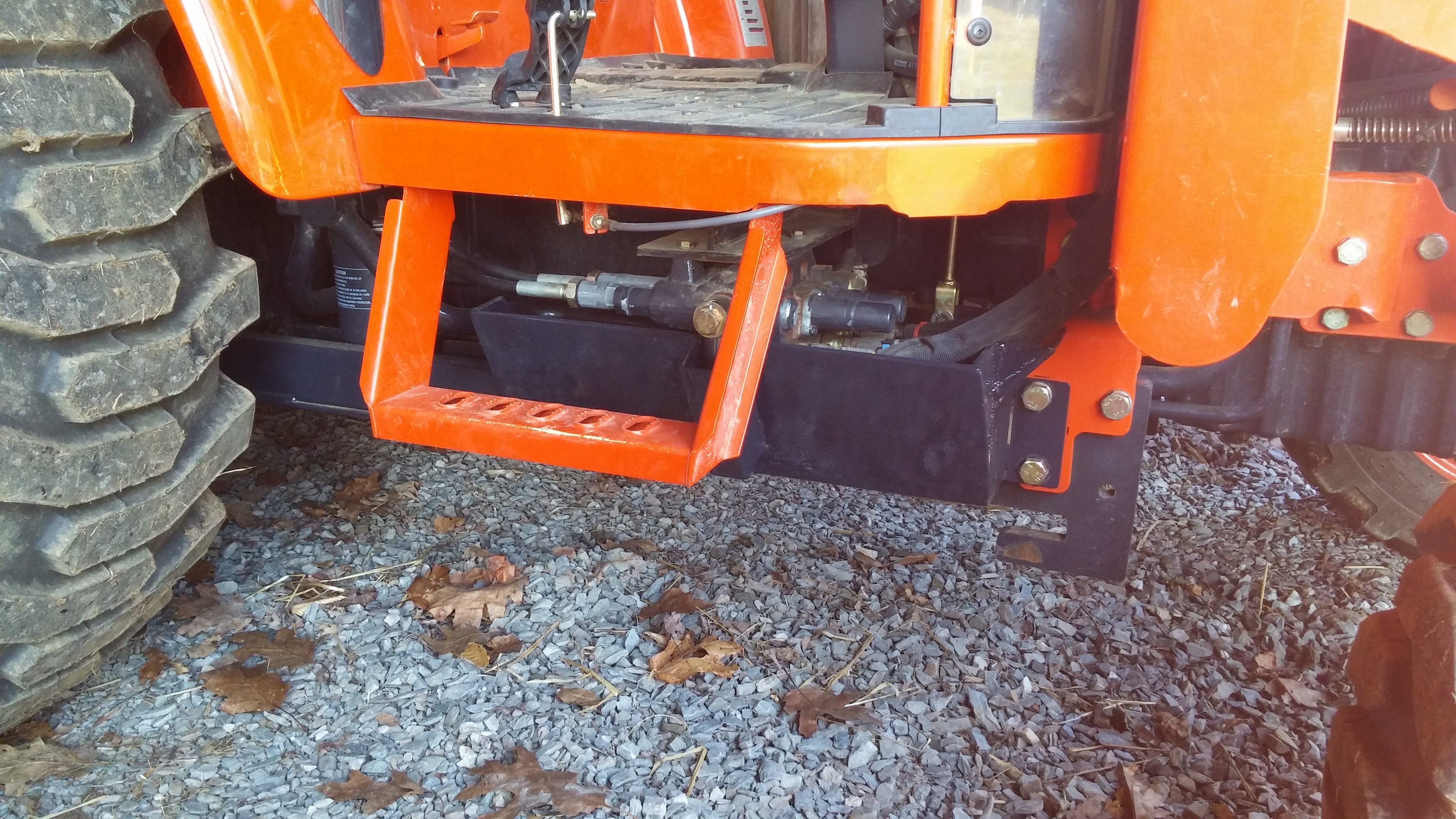

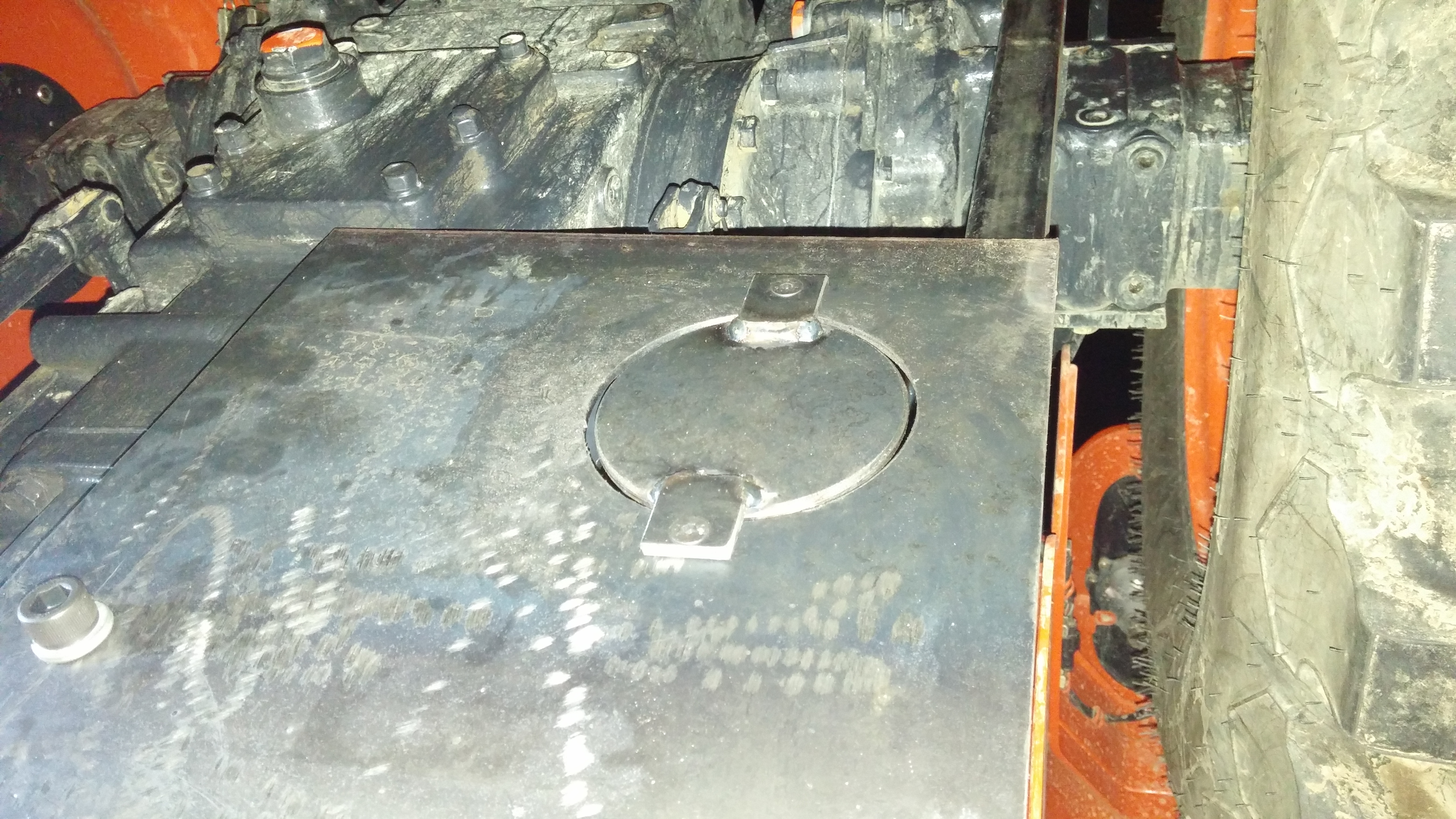

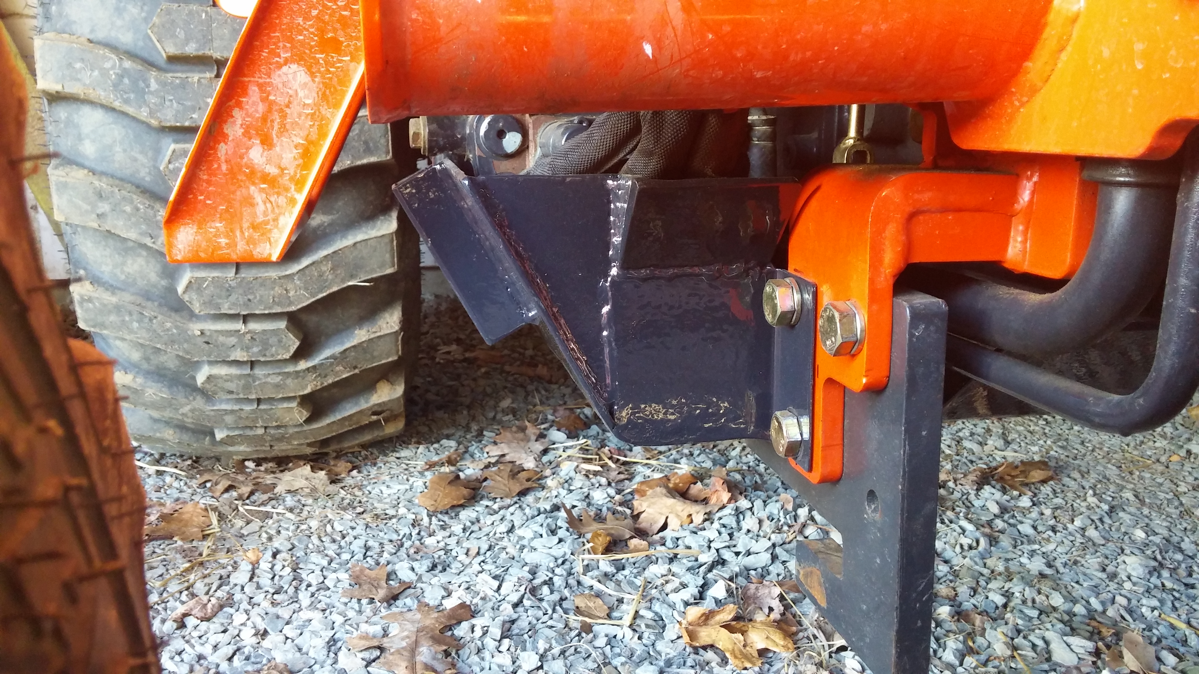

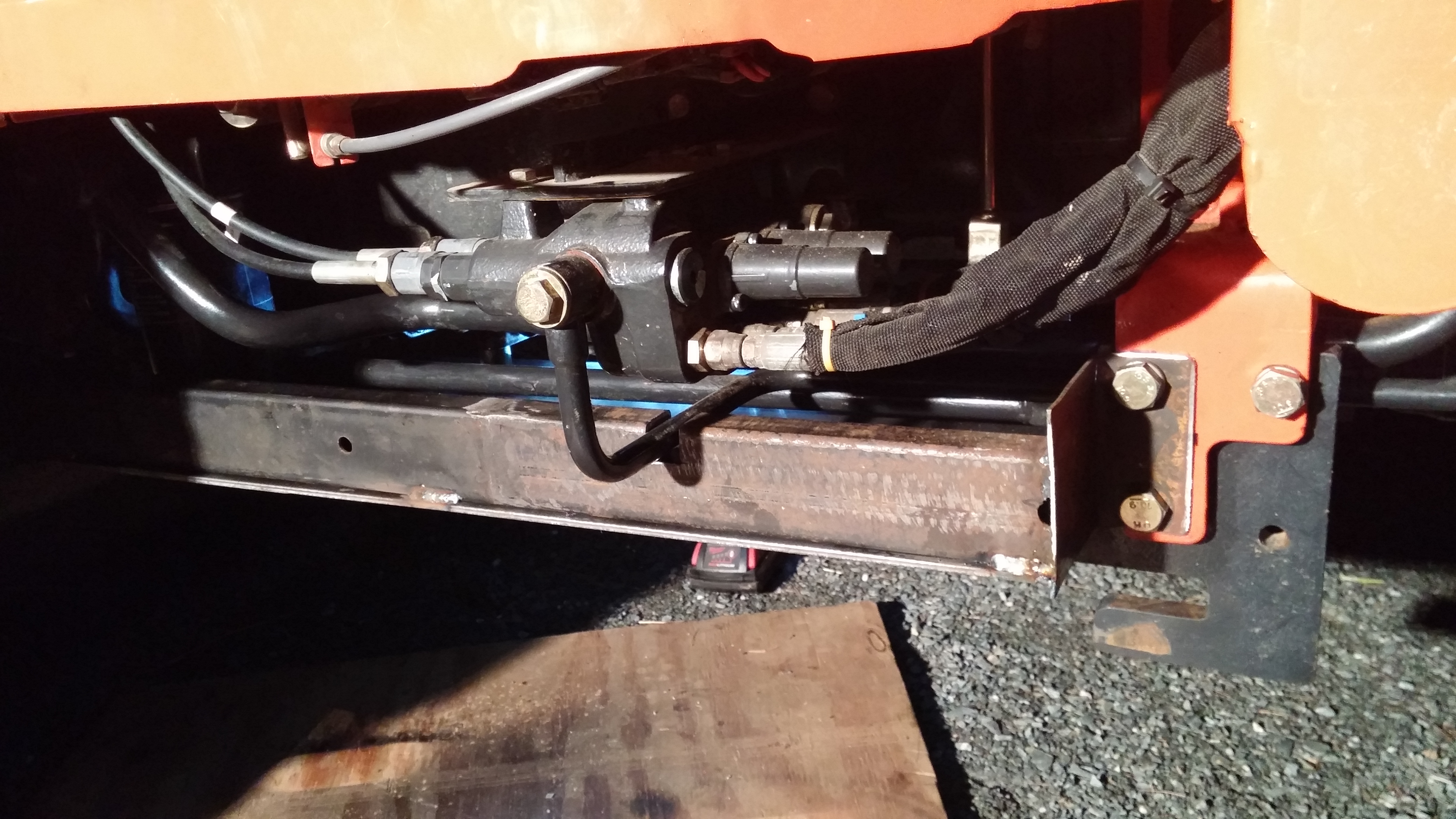

Here are the pictures of the skid plate I made to protect mine. I just knew it was only a matter of time especially while working around stumps and in the woods.
20160327_194827.jpg20160327_194833.jpg20160327_194912.jpg20160327_194922.jpg20160414_183630.jpg
20160420_180220.jpg20160420_180123_HDR.jpg20160420_180105.jpg20160414_183639.jpg20160420_180237.jpg

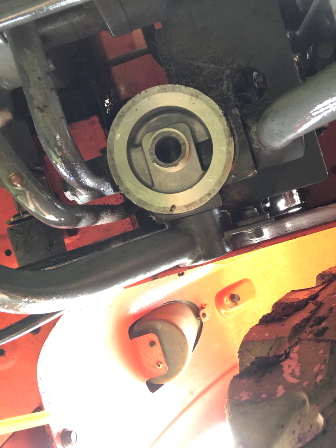

Did you need anything else beside the mount and a new filter?
/ Ck30 Hydraulic filter assembly
#19
You might want to get new O rings. I was careful and mine were OK.
You’ll also need to refill your hydro fluid.
