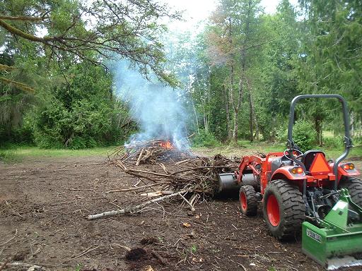

You can do an almost decent job of pushing brush around using the loader and toothbar as a mammoth rake. If you had a root rake on the dozer then you have already done it.
The crazy thing about the hydro filter's vulnerability is that even a stick poking up at the right angle will pole vault the filter so just deflecting that stick would get the job done. There are many threaded bolt holes under the machine to attach a plate to and I have plate steel on hand but I just always put it off until it's too late.
Just the subframe mount for the woods grapple was more than 800$.

Nice burn ya' have going there Highbeam. I'm still undecided about a toothbar for this (the dozer blade rake did the brush clearing and rootripping, it's done 'cept for maintenance) --- they're great but don't really need now.
