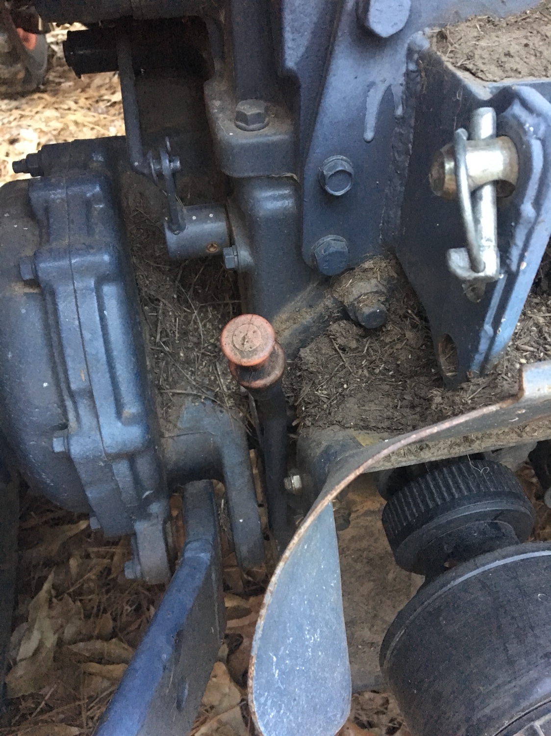

After the leak I had I figure I need to top off the hydraulic fluid levels. Is this the dipstick for it and where I add it?

Yes and yes. Engine off.

My ck30 is not hst

I don’t have a manual. Bought it used and it didn’t come with one. After doing some searches it seems to be the same. I don’t suppose if it’s topped off with a different brand or type it would cause any problems?

How many hours? How much fluid was lost? When I damaged my hydraulic oil filter housing, I lost a ton of fluid. So, I just changed it all. You might consider doing a fluid change, and changing the filters. Especially if you don't know the hours on your fluid /filters.

295 on the hours. I had all fluids replaced when I bought it maybe 40 hours ago. I suspect it’s no more than a gallon or so down. I hit a hydraulic hard line and leaked some fluid for a couple minutes before I noticed it

Call the place that changed the fluid and find out what they used.
