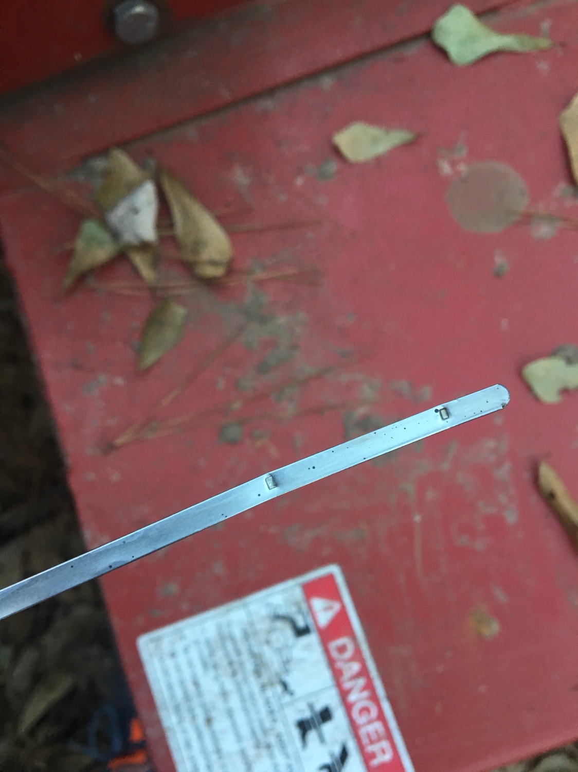

I’m assuming these two ticks are the low and full marks on the dipstick for hydraulic fluid? Correct?

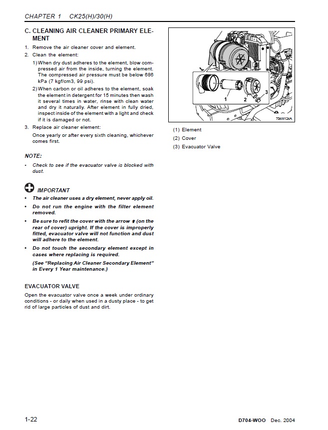

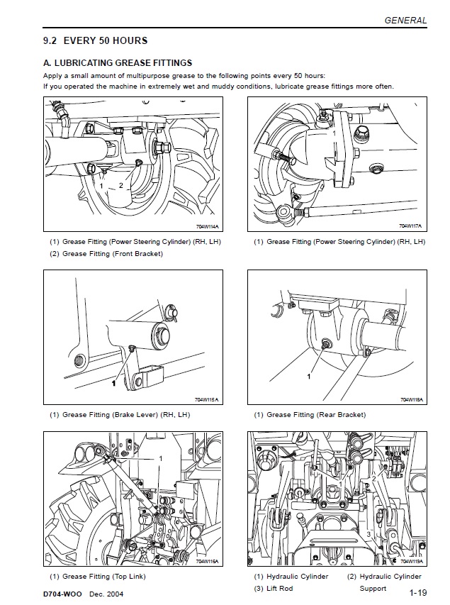

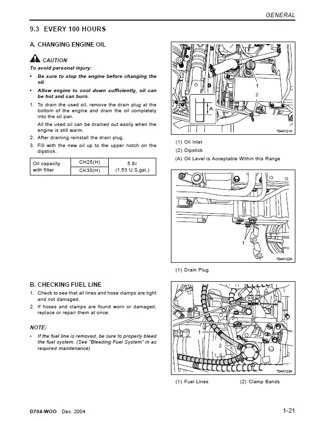

Here also, for future reference as you get into your tractor, take a look at this Engine oil changing page, as well as the air filter, and all greasing points.
There are lots of things to know, but these few items are a great place to start.
