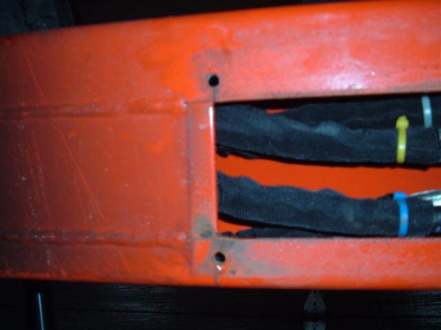

I can't see where your tow chains are attached exactly but my guess would be that possibly a tooth bar adds some stresses not calculated in by the factory. The access door creates a weak spot where the tube has been cut open and covered over with a plate to make room to fish the hoses through.
I don't have my rig in front of me but I suspect a good look would reveal some areas where maybe some additional metal/ angle iron could be laid on there and welded to strengthen the area, if it doesnt impede movement of bucket, etc.
I wouldn't have a problem opting to do that as a "beef up" since we all add stuff like hooks, tooth bars and non factory mods and towing tie down so why not add some non factory strengthening in the areas needed?

I can see when they routed the hydraulic lines through the assembly (which I presume was for crushing protection) it created some weak points, two large holes and the rectangular access panel, that would allow for twisting motion under load. The tooth bar may be a little too much for this configuration without frame modification.
I do see an opportunity to strengthen this configuration by removing the lines from within the assembly and welding it up solid. Then routing the hydraulic fluid across the loader by way of steel pipes. Good Luck, and please keep us informed. /forums/images/graemlins/smirk.gif

Could it be drilled to stop the crack, then welded?

If out of warranty, that's what I would do or have done. Also, using the block off plate for a template a guy could cut out a reinforcing ring to be welded around the access door opening to add strength.

Update. I dropped the loader off this morning. The dealer will have it welded and reinforced. This repair would fall under but not extend my Kioti one year warranty. If Kioti tells him not to do it then it will be a new loader. The toothbar is on the bucket and he told me that even if the toothbar "caused" it that it is fine since Kioti authorizes the use of a toothbar.

best thing for it, just weld the cracks, and reinforce. I consider that just loader fatigue, and not a failure. When I was extremely serious about the DK45S I found the manufacturer website and copied the loader specs. Here they are, a bit jumbled....but readable.
