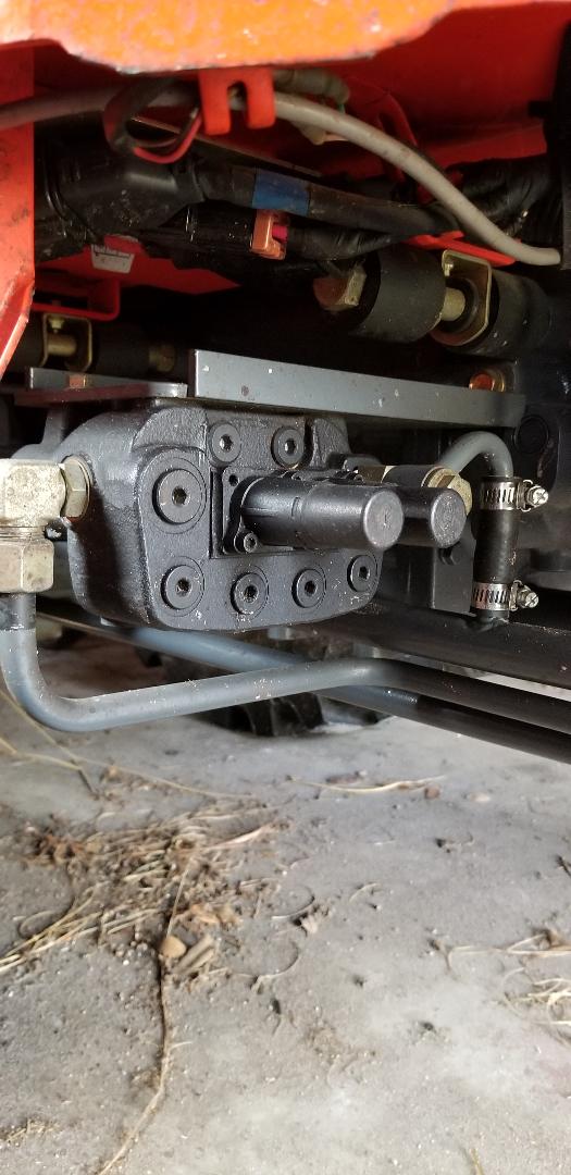

I was able to find a used kl130 loader and support bracket. My question is do i need to purchase a loader valve for my ck30 or are they ready to add a loader. Do the quick disconnects go in these 4 holes or am i in the wrong place? loader valve.jpg

The CK35 is plumbed slightly different than that but I believe the answer is yes.
I have attached my write-up from my 3rd function build. On page 17 there is a side view of my loader valve. The hoses you see going forward in that shot are the ones going up to the loader tower where the QD fittings are.
These valves are cable operated so I'm assuming you already have the joystick assembly in place (cables run off the left side of the picture in my write-up).

I was able to find a used kl130 loader and support bracket. My question is do i need to purchase a loader valve for my ck30 or are they ready to add a loader. Do the quick disconnects go in these 4 holes or am i in the wrong place?View attachment 592297
Correct, the 4 lower ports on the valve are the work ports for the front loader. The Kl130 Loader included (4) Short Tail hoses to a Quick Coupler Bracket on the loader support. The short tail hoses ran from the (4) lower ports in your picture to a small bracket on the loader support with the quick couplers. The loader hoses plugged into the quick couplers on the loader bracket. If it was taken off with the loader, you should get the (4) short hoses and the quick coupler bracket with the Front Loader. If not, you will need to extend the loader hoses to reach back to the 4 work ports on the joystick valve in your picture.

it definitely helps. Thanks. The loader im looking at doesn't have the short hoses with it. This loader was hit from the front corner and bent it about .5 inch and his insurance company bought him a new one. He has the mounting brackets and loader but not the short hoses. He reused them. My only concern is that is has been sitting for about 1.5 years. The cylinders look good with no pitting and the hoses arent cracked. Where could i find a picture of what order the hoses go in? I have googled for a week and cant find it.
/ CK30 loader #6
I just saw your post. I have a 2004 CK30hst. Do you still need a picture of the order of the hoses? Each of my hoses have different color plastic tie raps. Red, blue, green, and white. These match what is on the hoses of the loader.
