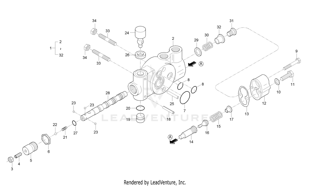

Mike, The fel detent seems like an easier fix than the remote. Two small screws takes the cap off the front of the control valve under the floorboard. Clean and regrease the shaft that protrudes out of the valve and clean out the cap that retains the three ball bearings then repack with grease. I put a "small" amount of silcone seal on the face of the cap before remounting in hopes of keeping any moisture from entering. I also checked the other cap, it is for the curl control but with no ball bearings, and found it to be in better shape but I still did the same service. I did both in about 15 minutes. Another member in an earlier post mentioned that the cap with bearings isn't cheap to buy so it's well worth the time to perform the service.

i shall be greasing the detent on my rear as its got really stubborn, thanks for the images as i think i have a pretty clear idea. well i will know one way or another later in the day :)
https://cdn.datamanager.arinet.com/image/KTT/311fee16-64bd-4d5d-9a83-fbc83e7d5732/ExtraLarge
EDIT,
well like others i found watery grease and some rust , also some dirt/solid fragments, when i took it off i lost one of the 3 detent balls as they went flying, so reconnected it without the detent balls for now and ordered some 7/32(5.55mm) loose ball bearings, The well pitted ball I micro-metered up measures 5.2mm. its a bit fidgety bit taking the seat off is half the battle, the 2 screws at the back of the seat are a real pain to remove.
so untill i get some more balls no detent.
