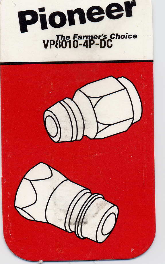

A better mouse trap! I bought this fitting at Tractor Supply, It works as advertised the only problem was a little oil leakage from the fitting while disconnected from the tractor most probably due to temperature changes that opened and closed the pressure release port on the fitting. No more fighting with the pressure problem and I would recomend it no matter where you buy it. About $12.00
