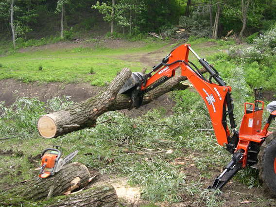

Heres a pic of my 80x , its very handy for cutting firewood.. Matt
