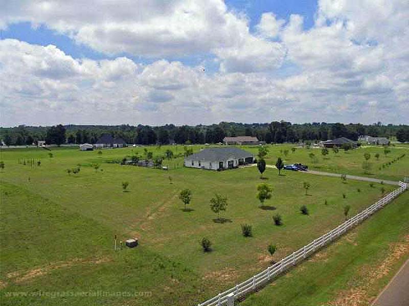

Hi, I am new to TBN and have decided on the CK30HST for 4 acres I just purchased in lower AL. All my pre-purchase questions have been answered from the informative posts and discussions here except tire selection for all around use on sandy soil with centipede grass. Industrial or Turf type, I will be mowing mostly and then digging for concrete pads, some box scraper work etc and I thought the Industrials might leave tracks and or damage the grass. Thank you in advance for suggestions/advice!

Thanks for the replies, the pic is from the realtor, I think it was taken from a helicopter. The R4's seem like they would be the best all around, not having a tractor before makes for another decision point.

Your entire yard appears to be turf grass. Although the most popular tire is the industrials, I think you would be happy with the turf tires. If you're going to spend much of your seat time mowing grass I believe you'll find the turf tires will give you a softer ride. The industrials have a much stiffer side wall and result in a stiffer ride. For the 10-20% of the time industrials may be a better fit, I would go for the 80-90% of the time turf's would be a better fit.
With a 'level' yard that is all grass I would strongly consider turf's /forums/images/graemlins/smile.gif......of course the industrials are the most popular and they look great on the tractor too! /forums/images/graemlins/cool.gif
