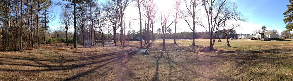

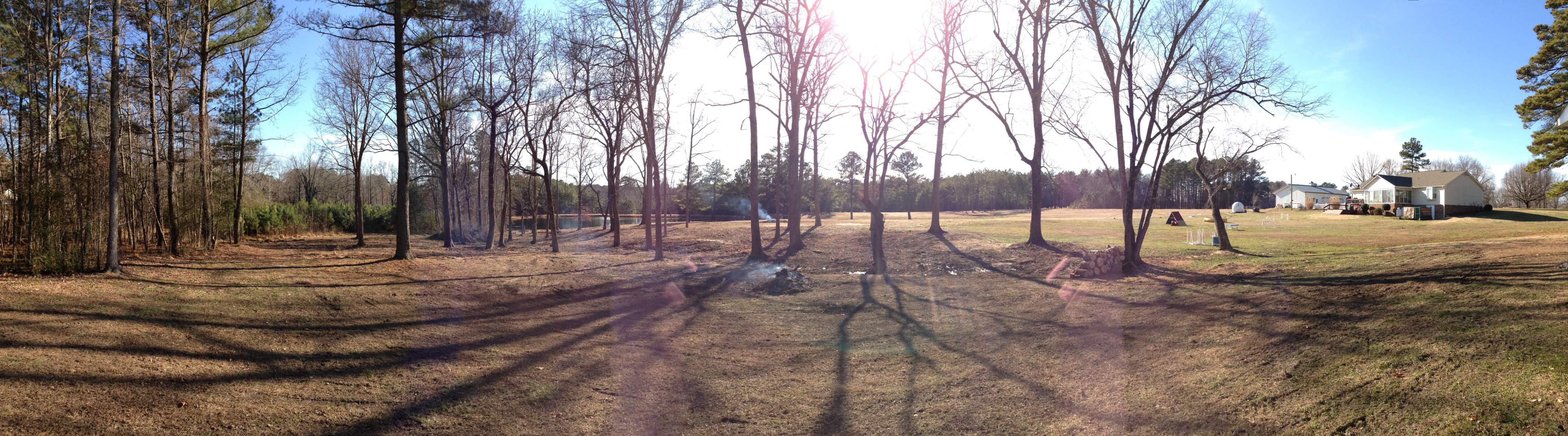

50 hours on my CK35 since I picked it up in March. I did the service myself but got stuck when it came time to pull the trans filter. Ended up busting off the handle of my chain wrench trying to get it off - I put a pry bar on it :) Anyways the Kioti service rep was kind enough to stop by and he eventually wrestled it off with his wrench. Not sure why they have to be on so tight. Hopefully the next service will be easier. On the plus side I have been extremely happy with the tractor. Cleared out a ton of trees and scrub on a couple of acres of land, cut 20 acres of high grass in the fields, moved a bunch dirt. Here's a pano of the recently cleared land - it was choked with trees, brush and vines before.
