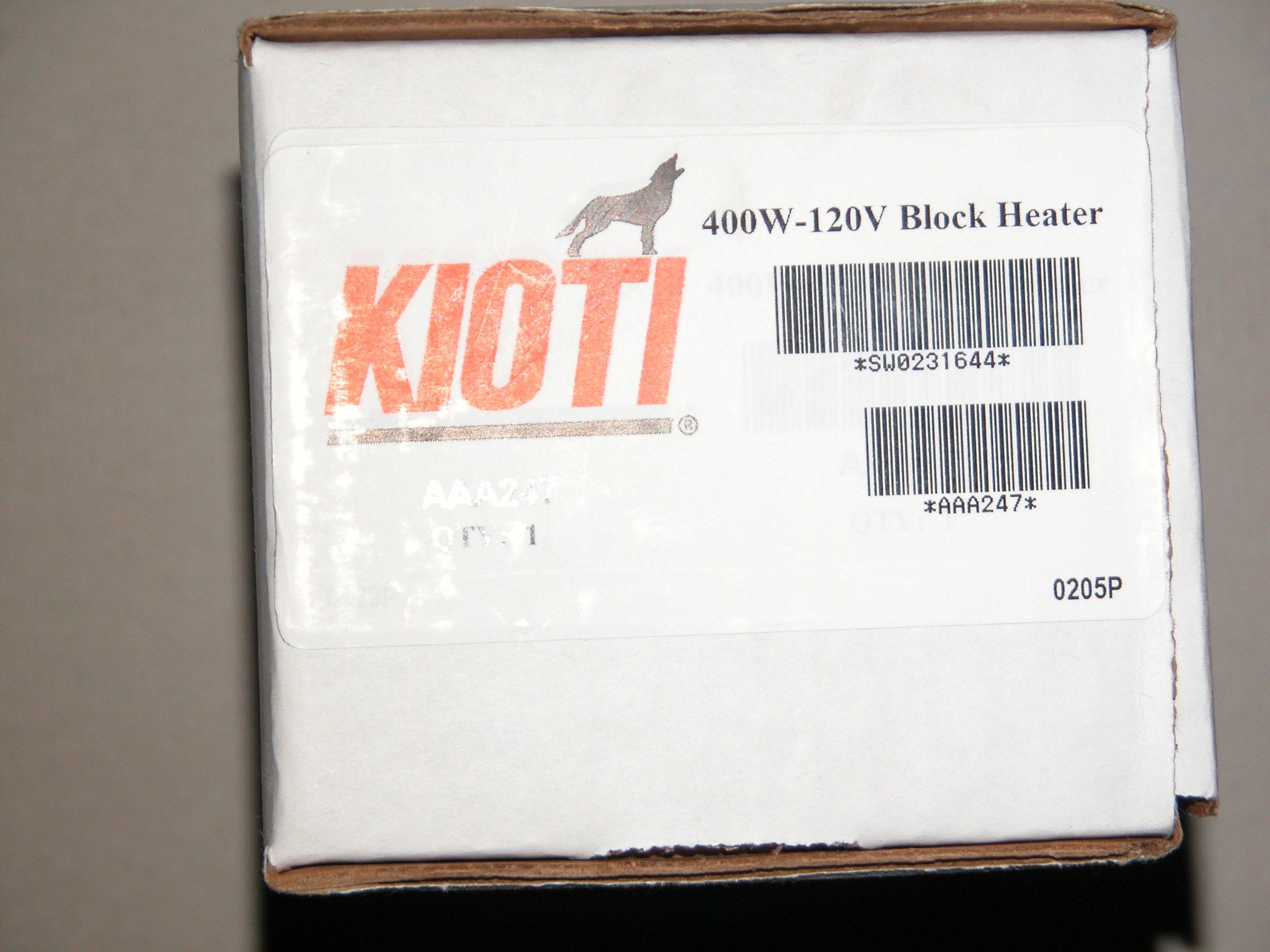

Check with a Bobcat dealer and get one for a CT 235 - CK 35 clone. Kioti has them in their parts manual if your dealer would bother looking it up for you, or try another Kioti dealer.
/ CK35 Block Heater #6

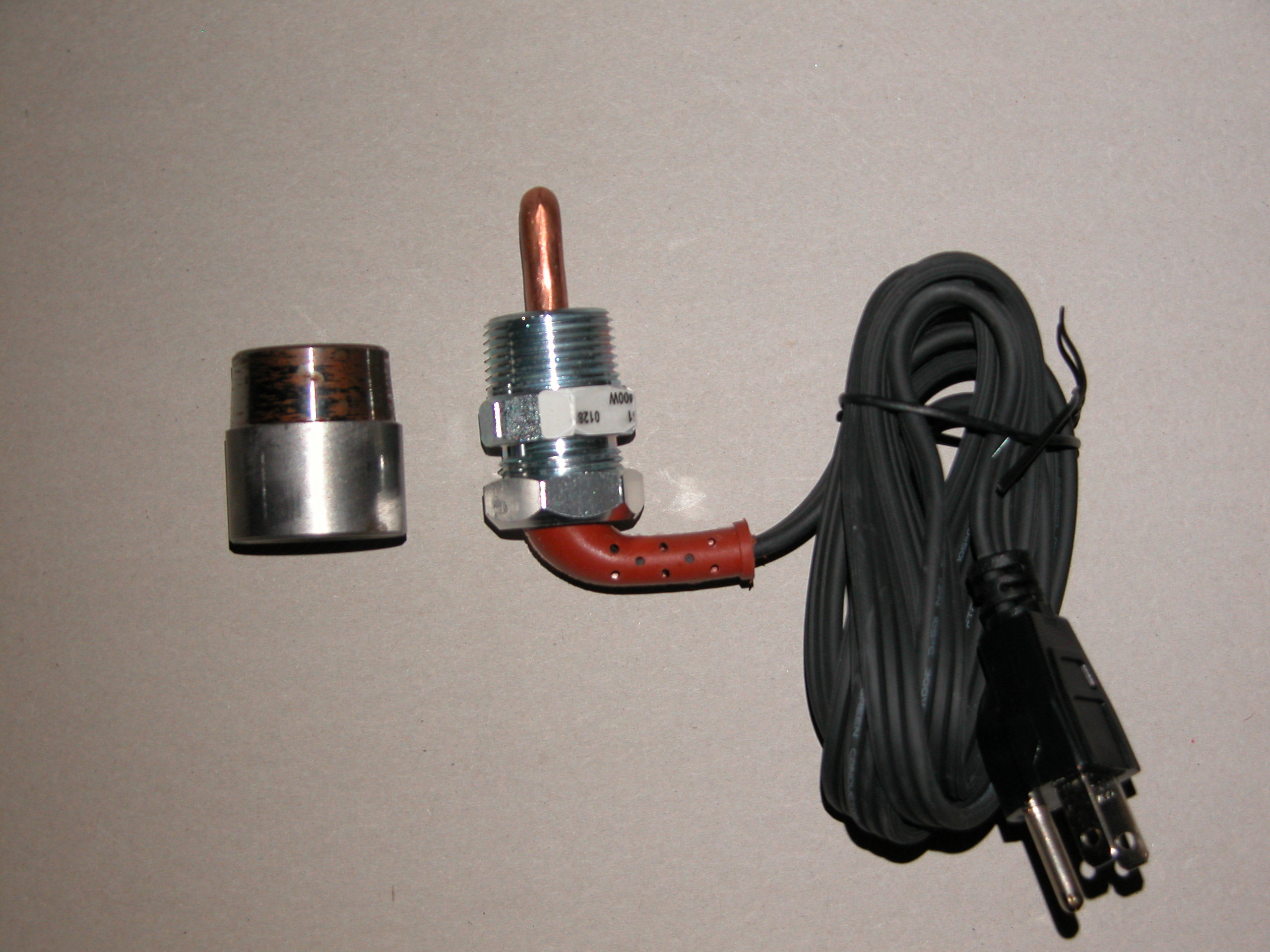

From my post a year ago.
Pic 1. Box with part number
Pic 2. What is in the box
Pic 3. Instruction sheet
Pic 4. Installed.
I think I paid $68 plus shipping. It is ordered through Kioti wholegoods supplier.
